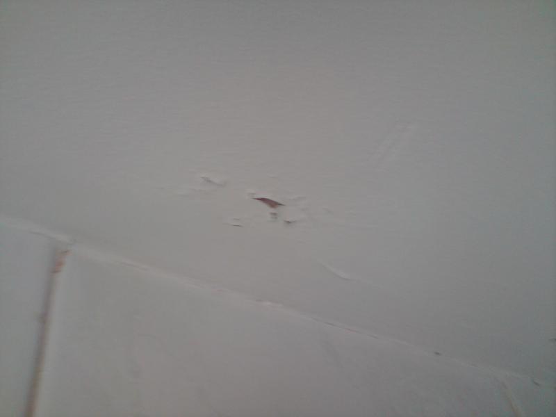

Hi All
Our bathroom ceiling was replastered end of last year, I applied a couple of watered down coats of emulsion, then a couple of coats of normal emulsion.
A crack in the paint appeared - reading some of the posts this seems to be a common problem.....
Bathroom window is opened "after" a shower.....however I have now installed an extractor to provide a route out during the shower....
Now I have this whats the best way to get the paint on ceiling not too crack......
Thanks.....
{Just checked my crack}
Their not cracks as such more like "splits"
The plaster is not damaged. The major one the paint has peeled away but there are lots of the smaller ones in the paint.....
Here we go...
The main crack / peel
There are others similar to this
I think it may be steam related but hopefully with the fan will minimise the chance of it happening again but would appreciate advice on achieving this paint wise.....
Cheers
That looks to me like steam has penetrated a crack and got behind it ..at first I thought I was a leak from above..
Scrape the worse away, give the area over and around the crack a coat of thinned emulsion, fill, rub down and touch in with emulsion...toy may need to repaint the ceiling completely again after that if it shows.
Use vinyl matt emulsion..it gives better protection than contract (non vinyl) matt.
