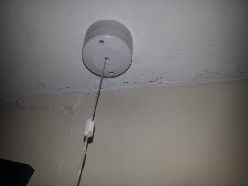

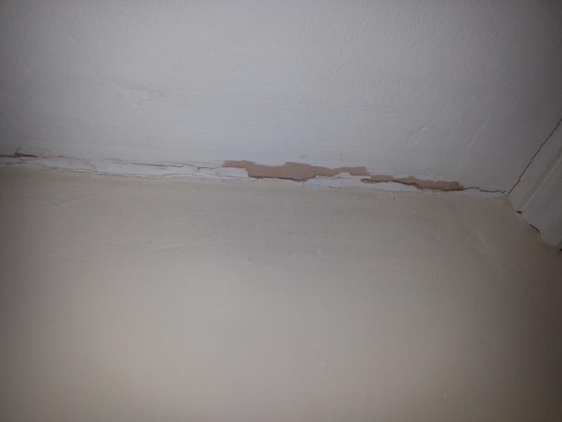

Just about to start painting the bathroom ceiling in our new house when I noticed the paint peeling a bit around the edges. What I have found is a series of cracks around the edge of the bathroom ceiling. Picture below. Any tips on how to solve this? I was thinking of using filler to fill in the gaps, sanding down and painting over the top.
Our bathroom is in the top a 2-storey extension off the back of a 3-storey victorian house and has 3 external walls, plus obviously the external ceiling which is a flat roof.
Remove the loose filler/caulk and flaking paint, then seal the bare plaster with diluted emulsion. Re-fill with a fine surface filler, sand smooth and again seal with the diluted emulsion. You can then caulk the joint in the hope of preventing future cracking before using your finishing emulsion.
