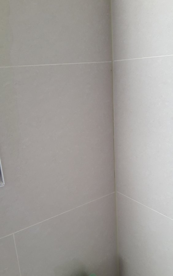

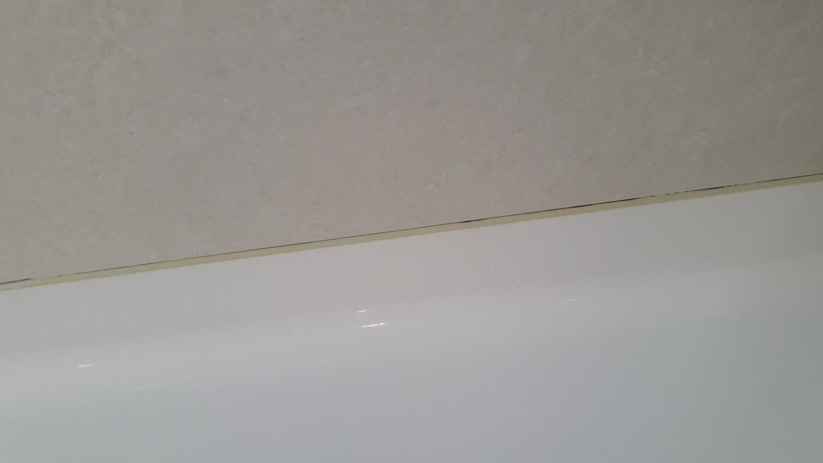

I had the bathroom done two years ago, the builder did an excellent job with the tiling but unfortunately his sealant application was a little artistic and areas around the bathtub are wafer thin. A little over a year later some areas showed signs of stretch and splitting. These have now opened up and allowed some mildew to develop with potential water leaking.
I have inserted two close up photos from around the bathtub to show the problem,
side wall
bathtub
Thinking of the steps to fix this, I need to remove the old sealant clean and apply new coloured sealant,
1. what would you recommend for removing the old sealant and cleaning up?
2. my decorator recommended dow corning 785 mildew resistant, I am looking for a jasmine colour to match, is this a good long lasting sealant for the bathroom?
3. any other tips for my taping when applying sealant in the bathtub?
From what I understand the colour will not match exactly and meeting points of old and new seal will not mix. I should probably redo the entire bathtub and vertical tile lines left+right?

Remove sealant with a stanley blade used gently. You can get a sealant removal paste, that comes in a small tube.
Your need access to a sealant gun. Id suggest masking tape such as frog, going 4-6mm away from the corner on both sides.
Half fill your bath with cold water, then mask. Cut the sealant nossle at right angles about 5mm ouside nossle width.
Having rechecked that all the masking tape is well on the surfaces, aim the nossle and with moderate continous presurefill out the gape between masking tape lines from one end to the next.
With access to a rag, use a soapy finger and run it over the sealant to give a angled face between the masking tape lines.
If you have measured right there shouldnt be too much spoil sealant on your hand, if there's any wipe on the rag.
Remove masking tape pulling away from the sealant.
Once the sealant is cured, empty bath
