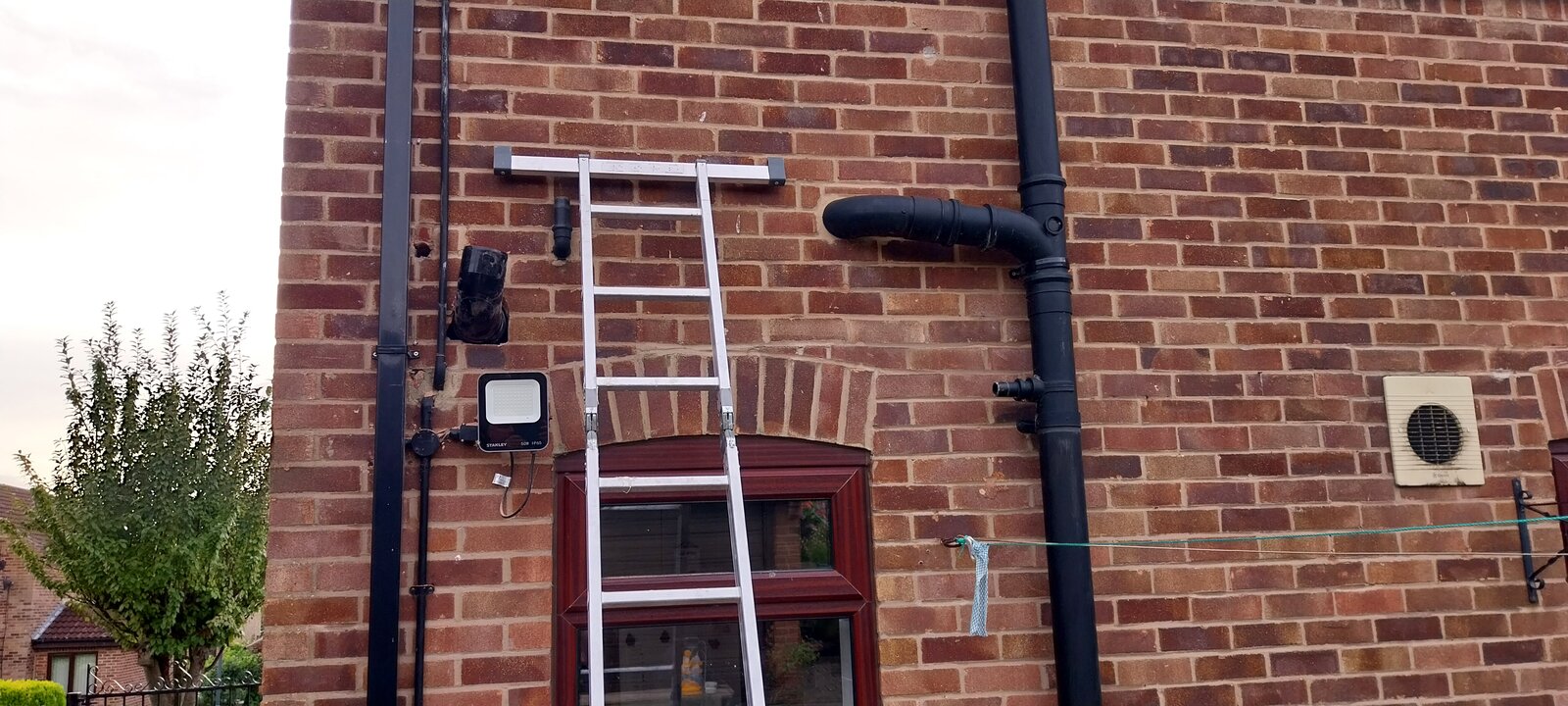

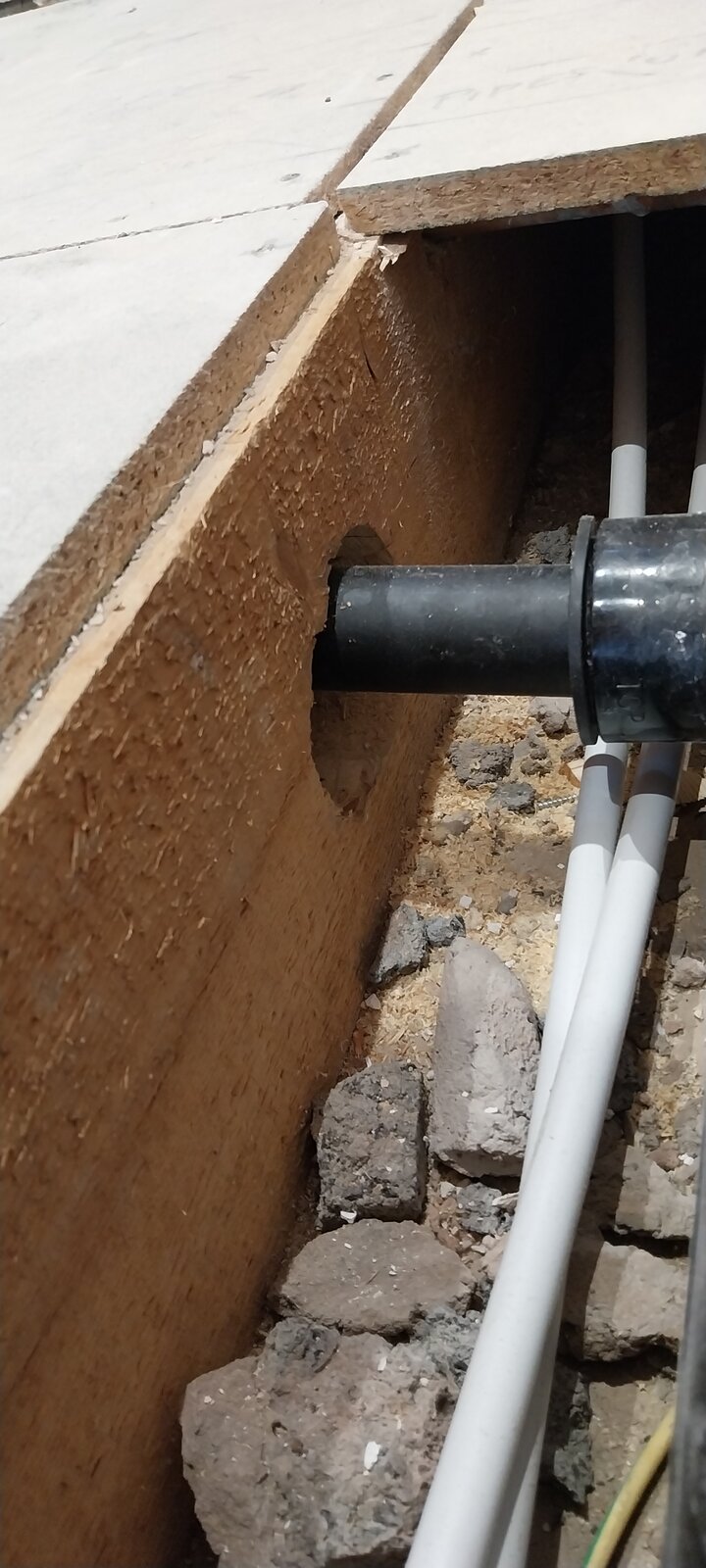

Currently having a bathroom refit and wondering if my concerns are valid re the attached photos, the soil pipe connection is being moved under the floor, as shown here the new pipe on the left is pointing upwards which I have a feeling indicates an intention to connect to the original point on the right where the previous toilet was connected above the floor. Also a waste connection has been made to this new pipe under the floor as shown (connected with a joint marked top on the side), including cutting a large hole through a joist.
Presumably this arrangement would hold sewage in the pipe under the floor and potentially also backup to whatever the intended source for the waste in the smaller pipe (either a shower or sink)?
Also lots of under floor push fit connectors on the water pipes (I've used them in the past but hey I'm a diyer)
Comments?

I don't think many Pro's would be using push fit anywhere, let alone under the floor, solvent weld is neater, stronger and provided its done properly, will never leak. I'd also be concerned about the hole through the joist, its way bigger than needed, and has quite possibly compromised the joist.
Cant comment on what's happening with the external wastes as it's not apparent what they're trying to do.
That awful great hole
And shouldn't be any larger than a 1/4 of the height of the joist. That looks much larger than that, unacceptable IMO.

Hole in joist is 85cm along a 280cm joist and varies between 10cm and 9cm in diameter. Joist height is 20cm so 6cm remains above and 5cm below.
Re coreing the external hole, they did do a nice round core but then it seems they found that the push fit was too big so hammered the hole bigger.

100mm hole in a 200mm Joist is just mental - 50% of the joist - that needs removed and the joist repaired. Max hole on a 200mm joist is 50mm anywhere between 0.25 and 0.4 times of the span from its support - so between 700mm > ~1100mm from its support so location is ok. Is the joist going to collapse, maybe not but that's not the point, it isn't right and needs to be fixed ASAP.

Nah, no excuse for a 20yr pro, how about checking OD's before the hole was cored and even then a bit of experience would have dictated what was needed. A SV socket bend has an OD a little over 120mm IIRC and a pushfit is a little over 130mm. A pro should easily be carrying a 142mm dry tube.

How can the joist be repaired? Can that happen around the 40mm pipe?
Sorry, what's a dry tube?
Apologies, it's a trade term - A dry tube is a dry diamond tipped coring tube - it doesn't need water to cool or lubricate - you get wet and dry tubes
If it's to be done properly then no - A joiner would be best served to recommend how best it could be repaired -
As a plumber then the easiest way I could see would be to core a similar piece of joist wood exactly the same hole size and then glue and hammer the core in to fill, wait until it's all set then core a new hole at a max of 50mm but I'd check with a joiner first to see if that would be an acceptable approach.
