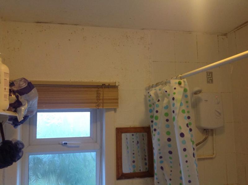

The bathroom in our house doesn't have an extractor fan, hence it is always damp and needs constant cleaning repainting etc...
The time how now come to re-decorate properly and the first step is to get an extractor fitted.
It's a small bathroom , 6ft x 10ft and has a small window.
It's used a lot as we have 4 people in the house who all shower at least once a day, so it does get steamy regularly.

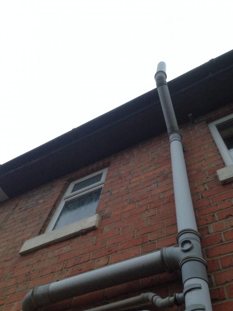

The first, drilling a hole through the external (non cavity wall) and fitting the fan there and running the electrics through a chase in to the loft.

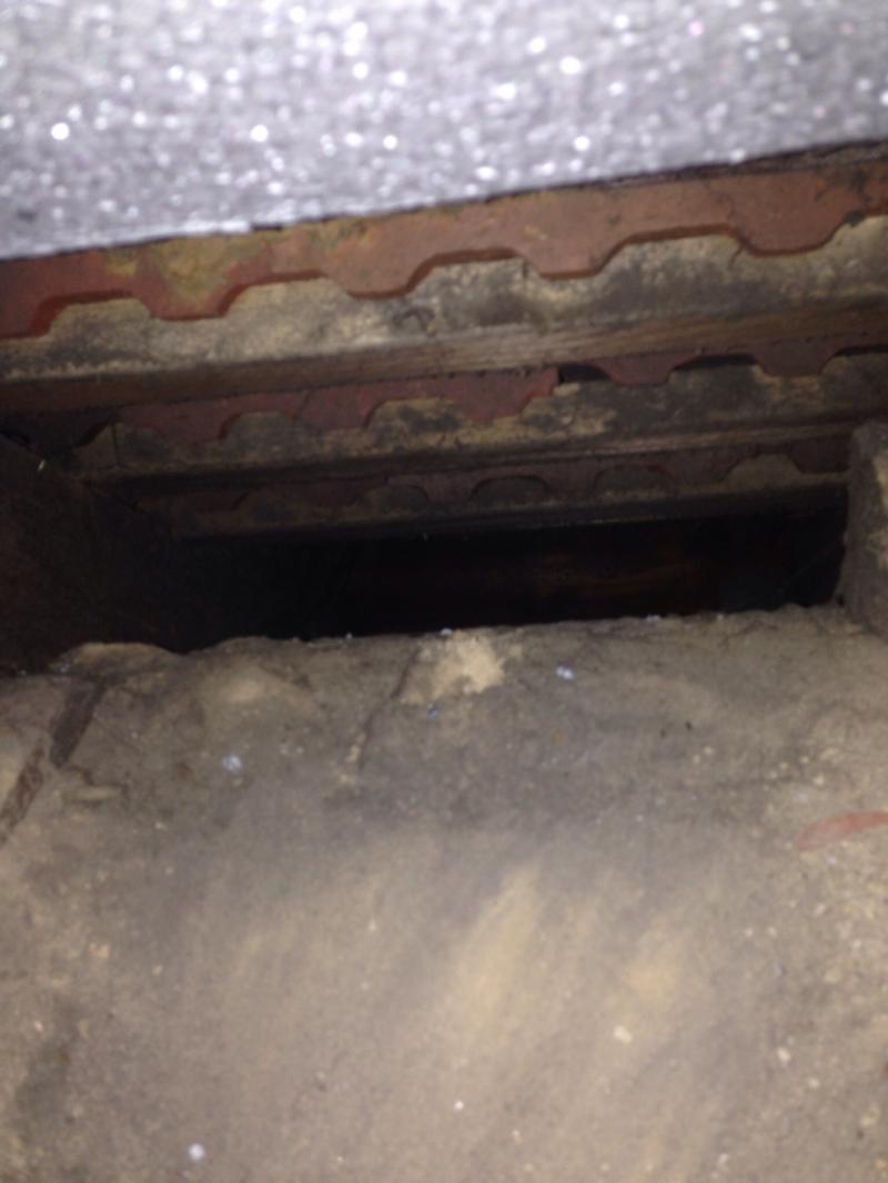

Secondly having an inline fan in the loft and venting either in the eaves or through a replacement "vent tile". The roof is about 45 degrees, the eaves are about a foot out.
Looking from the loft the gap to get to the eave is very small (4 inch?) so getting a pipe to it and being able to do any work would be very difficult.

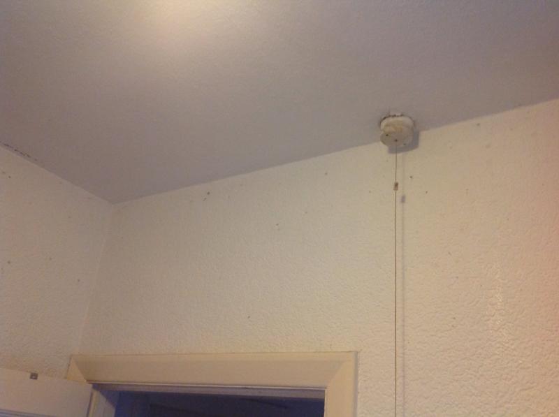

I have attached some photos, apologies for the state of the place, like I say we are about to redecorate.
Only my opinion, but I'd go straight through the wall using a core drill.....on a bathroom this size it would be quite powerful enough and would give you the ventilation you need.

Have wall vent in bathroom and ciling thru eaves in shower room with 6inch inline fan serving two inlets. I cut into eaves from the outside, you could try this and then see if you can access the hole from inside the loft, if it fails you just have an extra vent into loft space you can cover with a griil.

Foxy means drill a pilot hole in the required position I think, just to see if that area is accessible from within the loft void.....
I prefer my fans to be individually switched so they can be used when necessary, not automatically. Two live feeds are needed for the timer - one fixed live, one switched.

No, never suggested such, recommended cutting vents from outside into eaves to see if eave vents were viable.
