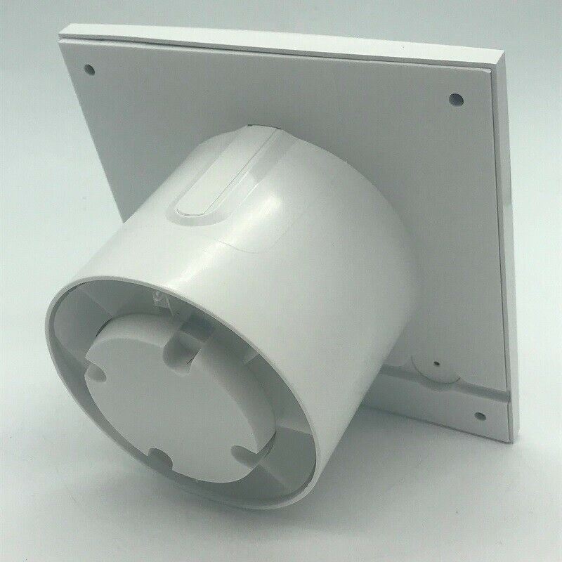

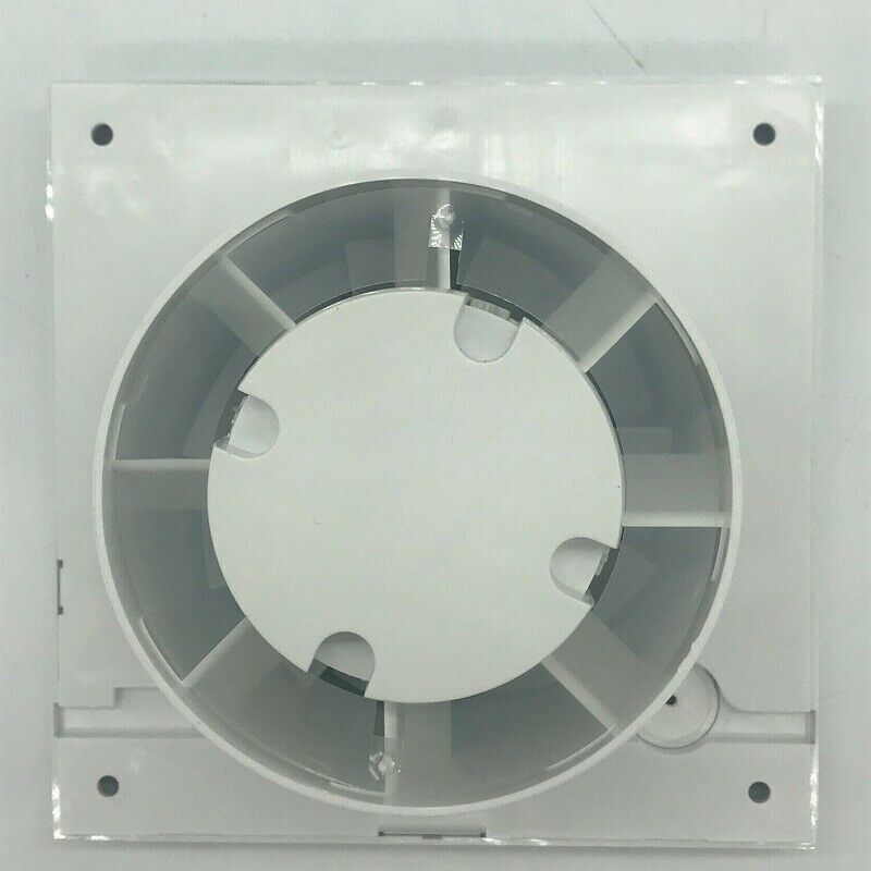

I can just about make out some kind of clear plastic flap which I think is part of the fan construction.
That's the back-draft preventer. It does, however, restrict air-flow slightly in the forward direction and might act as a surface which collects condensation.

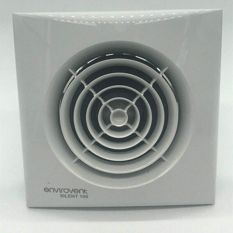

This is the fan that I have: https://www.envirovent.com/products/extractor-fans/silent-100/
And attached are some photos (not mine) showing the back of the fan and the back draft shutter

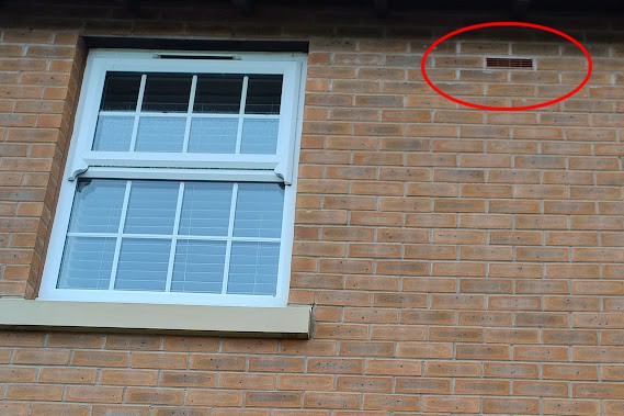

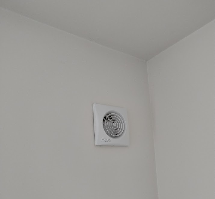

i think it's lack of slope, and possibly lack of pipe. post some pics please, inside and out.

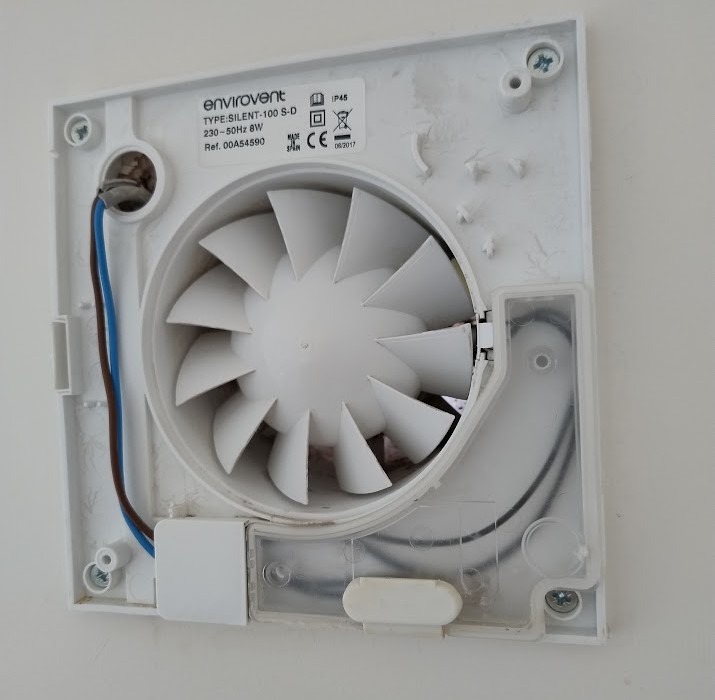

Hi there, please see some pics of the vent outside, and the fan inside (I've taken the cover off).

After turning off the power, you can undo the fixing screws and remove the fan. There ought to be a plastic duct behind it, which ought to slope downwards to the outside so any condensation runs out. Your single airbrick is not usual. Normally a round duct, and an external vent, weather protected and with non-return flap is used (see link below for a cowl vent)
Also, IIRC that model should be fitted with the electrial connections at the top, so water will not run into them. You might be able to achieve that.
Yes, unfortunately the fan is fitted on its side. If I remove the fan and the duct is sloping inwards rather than outwards, I'm assuming there won't be any easy way of fixing that?
