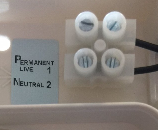

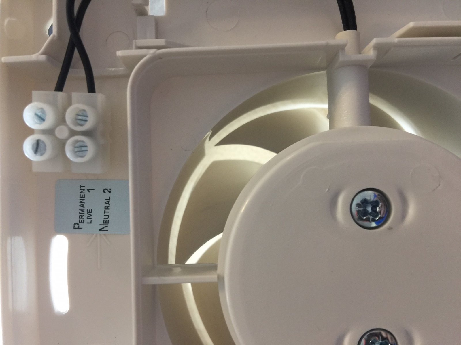

Hi all,
Just a quick one, i think i know the answer but thought its worth the try. The bathroom extractor needed replacing and it would appear ive bought the wrong one. Our old one came on when the bathroom light was turned on and has 3 connectors - a permanent live, a switched live and a neutral, whereas my new one only has 2 connectors, the permanent live and neutral.
Is there anyway I can salvage this or am i buying a new fan?
Any help would be really appreciated!
I would assume that the old fan had a timer to keep the fan on for a time after the light went off. The new one will turn on and off with the light. Your choice, really.
Thanks for the reply mate, Yeah the old one did have a timer after the light went off but that doesnt really bother me. How would I wire it up to just come on and off with the light?
Fan permanent live to switched live in cable. Neutral to neutral.
My new fan doesnt have a switched live on though? its only the permanent and neutral?
No, Switched live wire to Live in Fan. N to N.
Terminate the Permanent Live in a connector block and position out of the way.

Ahhh sorry mate, i understand now! Thats brilliant thanks for your help, i'll give it a try!
