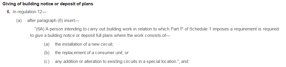

If notifiable work you will have to notify the LA - or employ a registered electrician.
As you will be making an "addition or alteration" to a circuit, if it is in the zones of the location it is notifiable.
If the ceiling is more than 2.25m from the floor, it is not in a zone, and so, not.

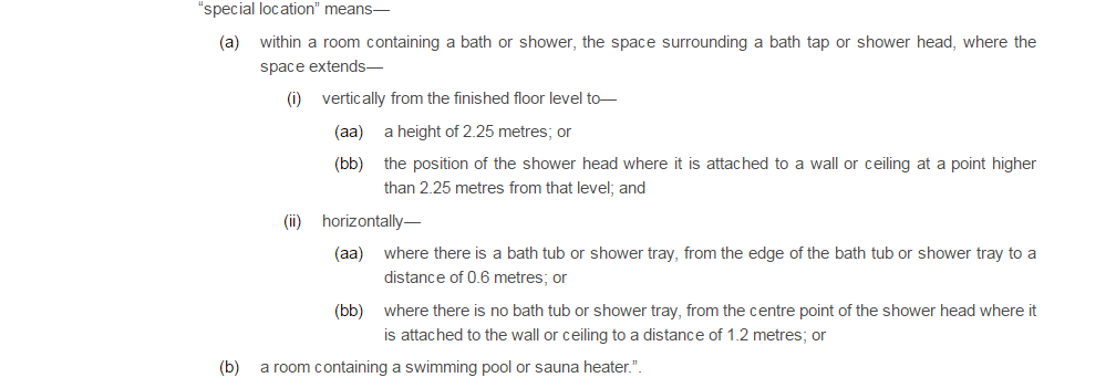

No, it isn't.
If the ceiling were less than 2.25m, it would be within the zones and "any addition or alteration to existing circuits in a special location" were carried out by adding the fan wiring to it, then it would be notifiable.
The ceiling is higher in this case so it does not matter either way, but -
were it lower, are you saying that the lighting circuit is not an "existing circuit in a special location"?
http://www.legislation.gov.uk/uksi/2012/3119/regulation/6/made
"within a room"
If the fan is not in the bathroom, but in the loft above, it cannot be in zones.
the ceiling rose probably is. Downlighters, no. Cables, no.
