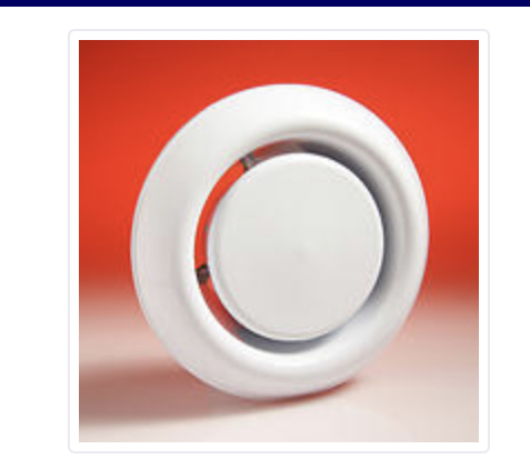

Once I decorate then if I still have problems. What do you think the next step should be? A larger in line fan? Would an extra ceiling fan work. Also have you any ideas for the actual plastic inlet. I hate the one I have. I will post a picture
This is what I want to replace.

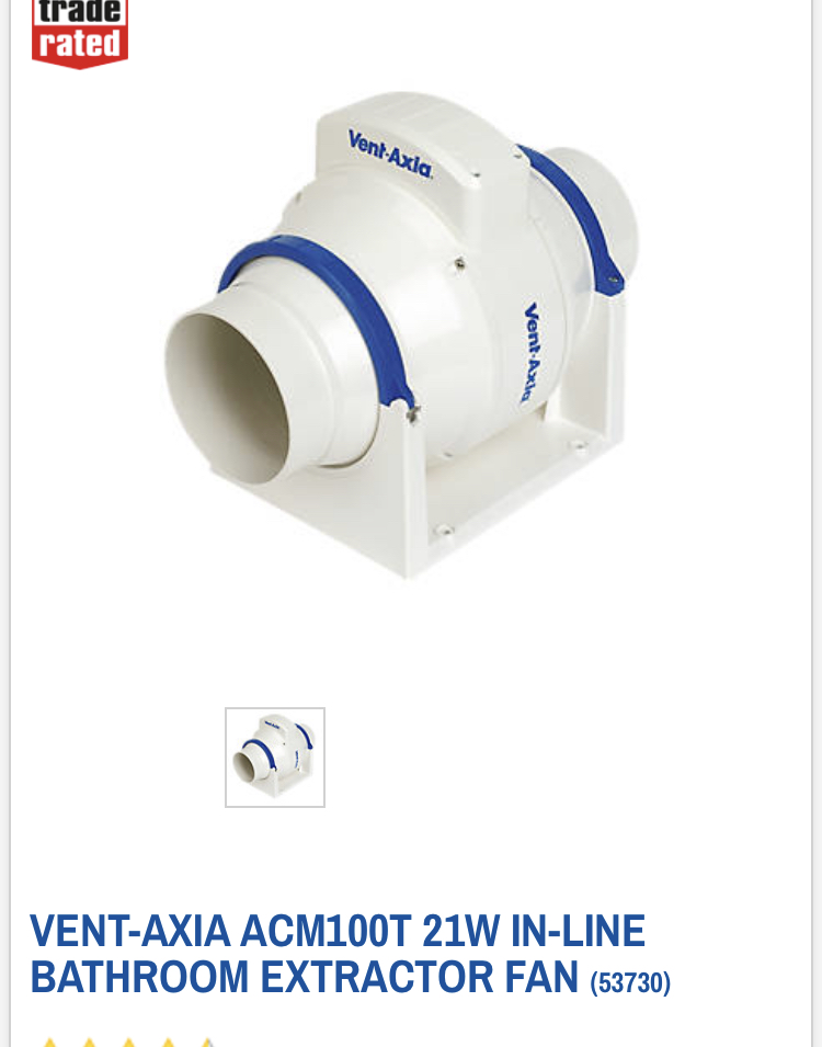

Which extractor have you got?

"Similar"
But which one have you got?
