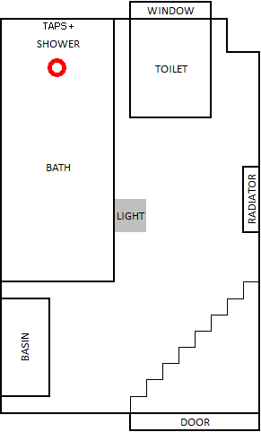

I'm looking to install a ceiling mounted fan in the bathroom however I'm not sure where is best to put the vent. The main purpose of the fan is to clear steam from the shower.
I've drawn a rough sketch of the layout of the room.

In the ceiling above the shower, which has the added advantage of being furthest from the door. Replacement air will enter through the gap under the door. Keep the window shut or it will interfere with airflow.
You can get really good ducted inline fans to fit in the loft above the ceiling, which are more powerful and quieter than most ordinary fans. A steamy shower needs quite a powerful extractor, and the 80 cu.m/hr cheap fans are not sufficient.
As it is above the bath, it needs to be fitted above the ceiling; unless it is 2250mm or more above the floor level, or an unusually high IP rating of water resistance.

I've bought a Vent Axia ACM100T which has an air flow of 240m3 and will be positioned in the loft above the bathroom.

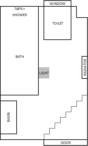

So if I mount the vent central to the bath width and roughly the same distance from the back wall i.e. roughly where I've drawn?
I tend to leave the window partially open on the night vent so as to have a small amount of air flow all the time. Is that likely to pose an issue with the fan where you've suggested?

Put the sucker hole above the shower.
An open window will interfere with the correct airflow of the fan.
