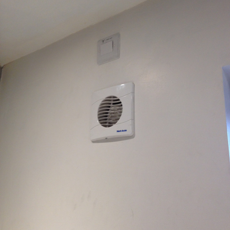

My son has recently moved house and his bathroom needs to be completely refurbished;...I have a question regarding the existing Vent-Axia extractor fan.
The fan is sited immediately above the toilet (about 30cm below ceiling height: see photo in the link) and vents through an external wall. This same external wall has a fully opening window.
https://i.postimg.cc/4dRxNx9F/Loz-bathroom-fan.jpg
The fan/switch is diagonally opposite the bath/shower and cannot be physically reached from the bath/shower etc.
The fan is solely operated by an isolating switch on the wall (just above the fan itself);...it’s very impractical because the fan has no ‘timer’ and the switch is very high up the wall (again: see photo).
We have no idea when this fan was actually installed,...the house was built in 2001.
Couple of questions, if I may:
Is this fan legal?,...given that the only switch is inside the bathroom (albeit well away from the bath/shower) and has no pull-cord to operate it?
The fan functions perfectly and (with costs in mind) we’d like to utilize it if possible, but given that the wall itself will be fully tiled what wiring options do we have that would make the on/off switching more practical?
Can the isolating switch be removed completely and replaced by a ceiling pull cord? (the attic space above the bathroom is fully accessible).
Can a ceiling pull cord be fitted in addition to the isolating switch?...that would be easier than removing the isolating switch completely,... I guess???.:confused:

That switch is an isolator switch for working on the fan; it is not meant for functional on/off switching.
You could rewire the fan to come on with the light (and timer if it has one) or a pull switch anywhere you want.

Thanks for that;...so can I take it that if a Single pole,1 way pull-cord switch was fitted to the ceiling (just adjacent to the isolator) then all would be in order with regard to regulations etc?
Just to re-iterate; the 3-pole mains isolator switch is approx 10cm below the ceiling and is not in a bathroom ‘zone’. It is diagonally opposite the bath/shower and is not physically reachable from the bath/shower/basin etc.
See photo.
P.S. we’d like to keep the fan totally separate from the bathroom light switch, but many thanks for the suggestion.(y)
Yes, but near the door would be more convenient.
To save a lot of writing, first let us know if the isolator is actually using all three poles, AND if the fan is a timer model which also has all three connected to it.

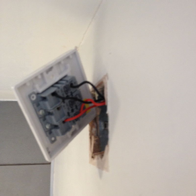

The fan has no timer circuitry (Vent-Axia model F100S3).
Both isolator and fan are wired with twin&earth red/black cable which is tapped into the lighting circuitry in the attic.
https://i.postimg.cc/gk66bjXh/Loz-isolator.jpg
https://i.postimg.cc/FscggDxw/Loz-fan.jpg
The latest thinking is to retain the 3-pole fan isolator but replace the old fan with an identical sized new fan+timer.
I was rather hoping that the cabling would have provision for a core that could be used as a ‘switched-live’ but sadly not. However, it now means that the feed from the attic to the switch and thence the fan will need replacing with three-core-and-earth cable,.. ..which will be a bit of a work-up as the attic space is very confined due to the low pitch of the roof. It isn’t boarded up there and it’s a bit tighter than I envisaged.
We’ll fit a pull-cord switch at the side of the bathroom door.
