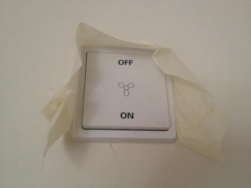

Hoping for some advise, I have just purchased a 12 year old appartment and am going through the stages of decorating.
One thing I would like to do is replace the extractor fan switch (located outside of the bathroom) with a new one. Reason being is its looking quite old and is a yellowing colour, just a bit of an eye sore.
The switch is connected to the lighting as it goes on/off with the light switch. Is this a easy job to do a straight swap with a newer clean white version?
Is it a three pole isolator
or just a normal switch for operation.
Thanks for the quick reply, I will take a photo and post tomorrow (I work evenings)
I bet it dont have a fuse spur?
Even with a 3 pole switch you should still have a 3amp fuse in a fuse spur.

many thanks, I have ordered 2 of the first link as they look like a identical straight swap.
