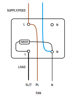

Hi again, I decided to go for this option. I have fitted a pull-cord switch close to the fan and wired an extra live from the L terminal in the new switch to the fan's T terminal. The trouble is, although the fan runs when I pull the cord, it goes off immediately when I pull it again, instead of running on the timer setting. Also, the new switch's neon stays on even when the switch is in OFF position... Any idea what's going on?
Sounds like you have wired the switch the wrong way round -
and put the permanent live to fan in the wrong place (but could be the right place when switch is wired properly)
Picture of switch wires? Just copy and paste.
Bit tricky to photograph it right now but there is only one Live feed terminal in the switch (it's a standard shower switch as the terminals in a lighting switch aren't spacious enough), so both lives are coming from that terminal to the fan. Do I need a different type of switch then?
Ok.
The Permanent Live to the fan should come from the Feed terminal, and
the Switched Live to the fan should come from the Load terminal.
The Neutral of the Feed and Load cables should both be in the Neutral Load terminal.
However, because the Neon stays on all the time, it would appear that you have the Feed(supply) cable and Load cable the wrong way round.
If I am assuming the correct type of switch.
