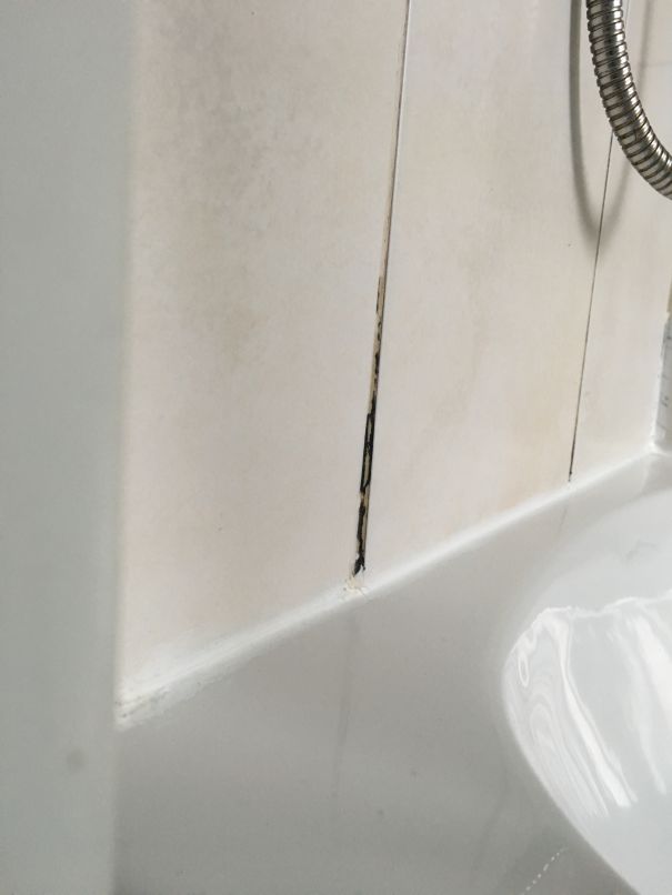

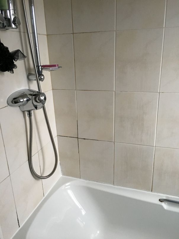

We're going to have someone come out and look at doing our bathroom (total rip out and start afresh job) and i want to have some sort of a clue before they get here and not just swallow what may be a load of garbage because it might be something the installer would rather not do.

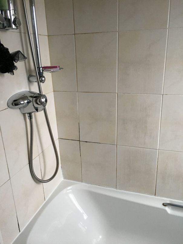

Currently we have the bathroom how it was when we inherited it 5 years ago...
Photo 01-12-2018, 10 58 25 am.jpg Photo 01-12-2018, 10 58 43 am.jpg Photo 01-12-2018, 10 59 21 am.jpg Photo 01-12-2018, 11 01 49 am.jpg Photo 01-12-2018, 10 58 57 am.jpg
The house is a 1930s house with plaster & lath walls & ceiling.

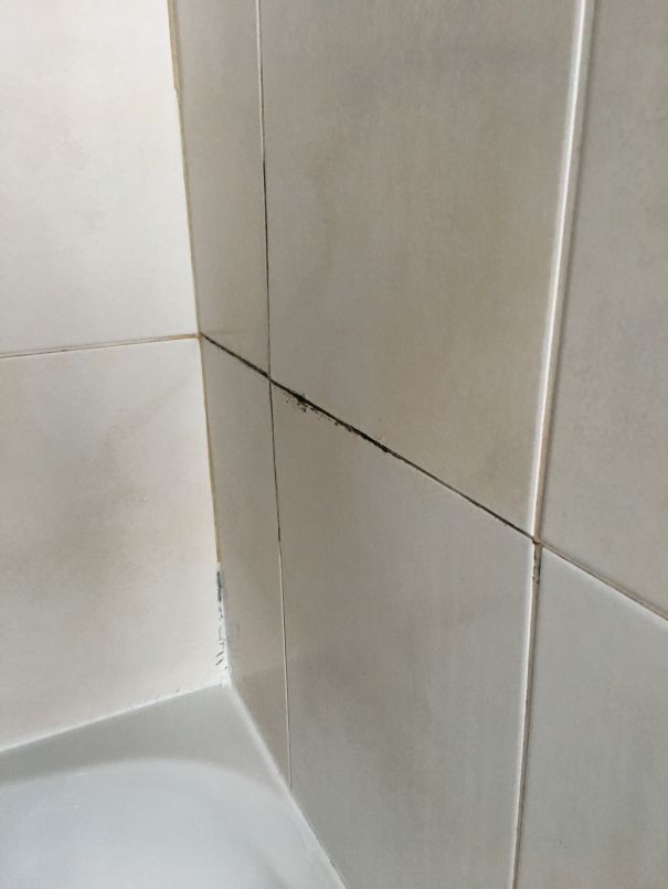

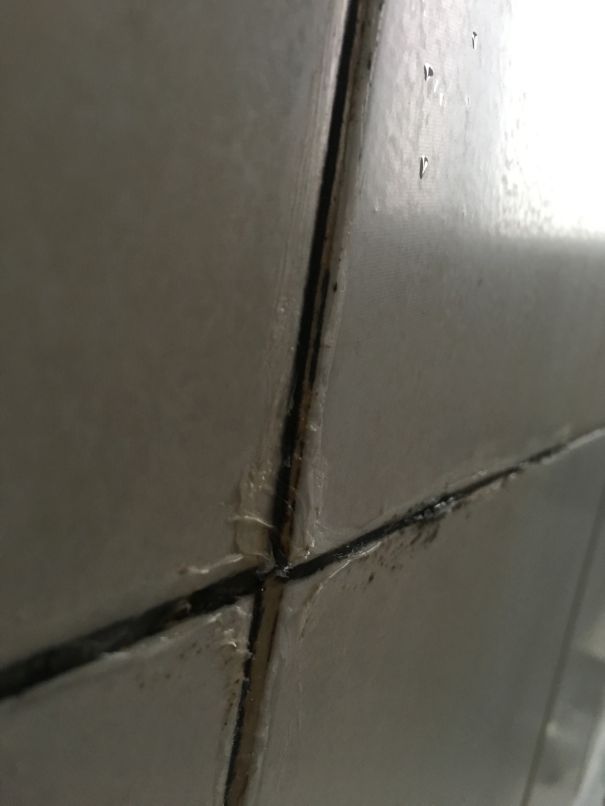

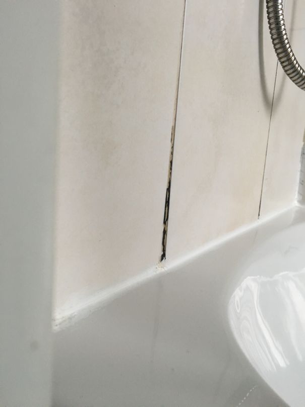

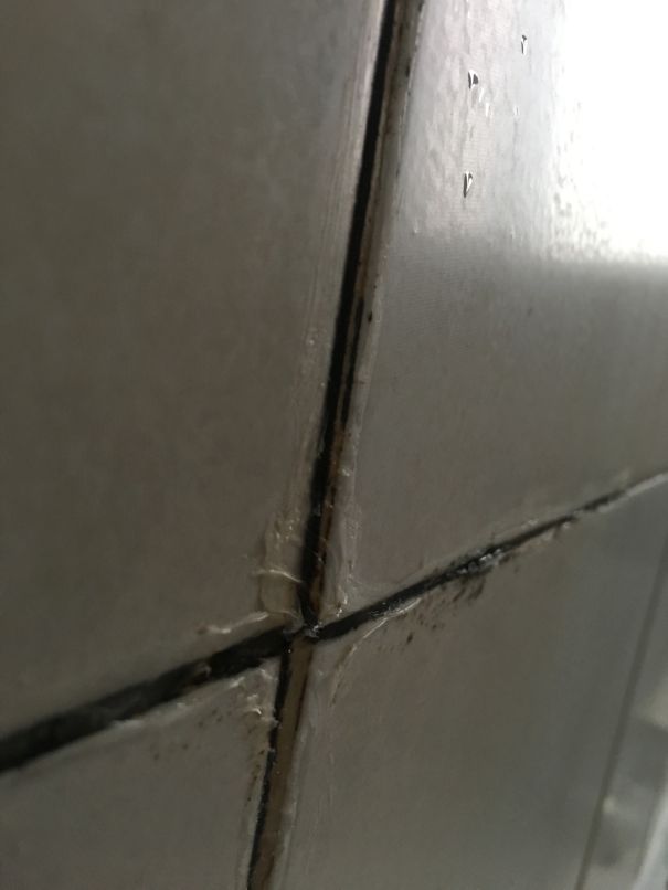

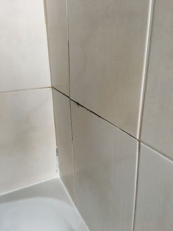

The tiles are pretty flat except for that area that has gone black mouldy due to the silicone - the tiles have started i don't know if it's actually popping off but they're raised.
We've been told about the possibility of sheets and we're interested in this for ease of cleaning purposes (as well as probably a quicker install which may lead to being cheaper at the end of the day - though that isn't the main thing).
Q1: Are sheets decent enough or are they a poor option?
Q2: I'm told you can sheet on top of tiles. I've a feeling that this isn't really a good option though i'm clueless so i have nothing to base this on other than a hunch. Would it be acceptable to sheet on top of the tiles? I assume the raised ones would need to be removed but everything else ok? Just wondering how it'd also work around the window when you start doing that though.
Q3: Are there different types of sheeting? I've seen something (forget the name, splashback or splashwall i think it is) in B&Q though i imagine there'll be better value stuff out there (again - a hunch). If there are then what would you opt for and why?

Some of the plastic wall panels are so thin can see manufacturers track marks within the panel once fitted .
So choose a decent one or will look aweful
Is water that has caused the tiles to pop out .
In theory can cover tiles with the panels , but will only be stuck on as good as the tiles .
You can have plastic wall panel or Formica on sheet timber , the latter being quality and therefor more expensive .

I didnt say dont use , some look better made visually than others .
Performance wise they should not leak any of them even the cheapest .
Cheapest way to patch it up remove loose tiles and any damaged plaster , fill it back level using bonding plaster 2 layers ? , stick the pvc panels on with silicone .etc
Other way is take everything back to brick and do a full refurb , probably be wet rotten timbers under the bath etc

My parents have just had the cladding done -it was a reasonable brand and looks nice. The fitters were going to strip back to brick (it was fully tiled) but after they'd SDS'd the tiles off the bonding was rock solid (it had been redone 10 years previously). How the fitters approach the existing wall will give you a clue about their standards. I did my own bathroom about 15 years ago and it still looked good 10 years later when we moved. The only thing is that if you damage it, it's not repairable - I managed to drop something against mine and put a small chip in it - fortunately I was able to cover it with a strategically placed towel rail! However, I've played with some samples of the more modern stuff (actually given it a good whack with a sharp metal object) and it seems less brittle than the stuff I used. Also, as Foxhole mentioned above - use of trims, particularly on internal corners (rather than a bead of silicone) is a good sign.
I would definitely do the ceiling in cladding even if you don't clad the walls.
