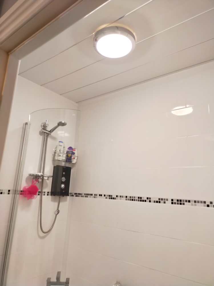

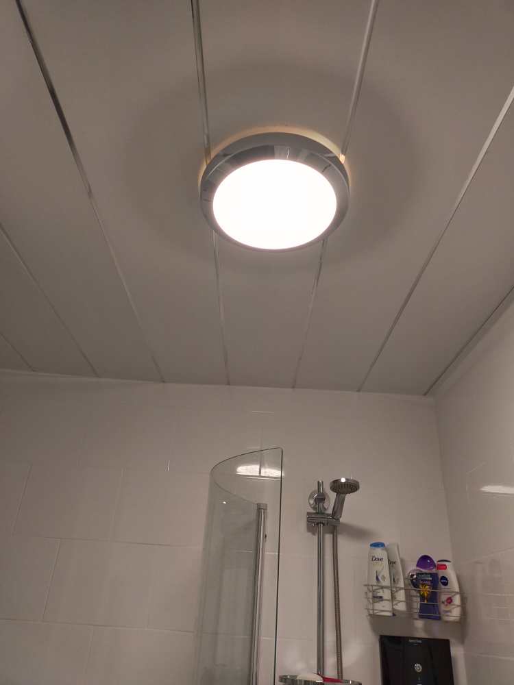

Hi, I would like to know if I could install an ip20 light in the bathroom, some say yes some say no, it will be 2.6m from the floor and but lightly over the bath, as shown in pictures, cheers

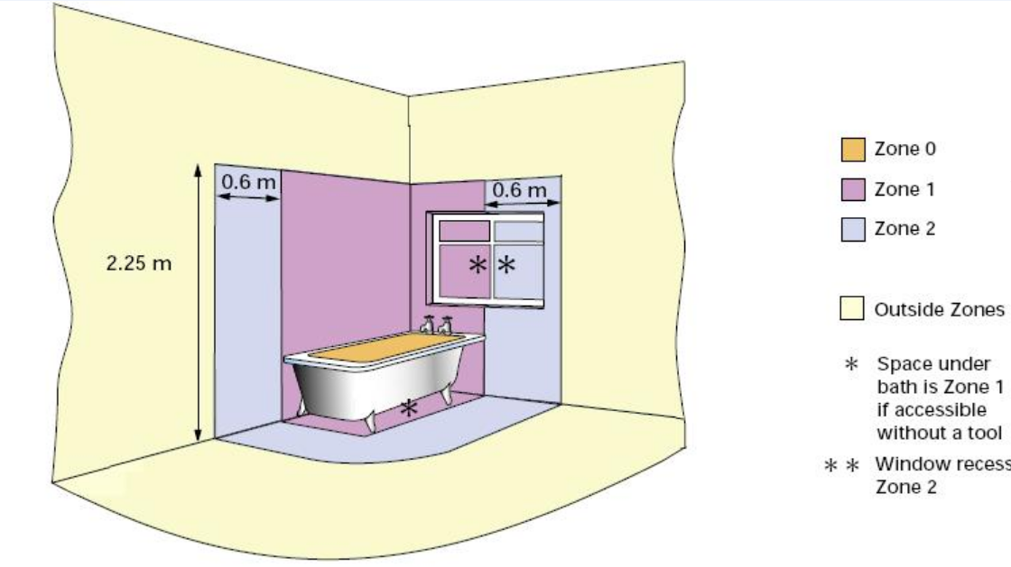

I suppose floor or bottom of bath shower is not going to be too much different.
That's not necessarily the case, in either direction. In one of my bathrooms, the bottom of the ('sunken') bath is about 500mm below the floor level!
Zone 2 is 600mm after that tho in each direction.
Given that the OP has told us that the light would be 'over' the bath, the 600mm (horizontal) limits are irrelevant.
Which if you went from floor still means the posters light would be in zone 2.

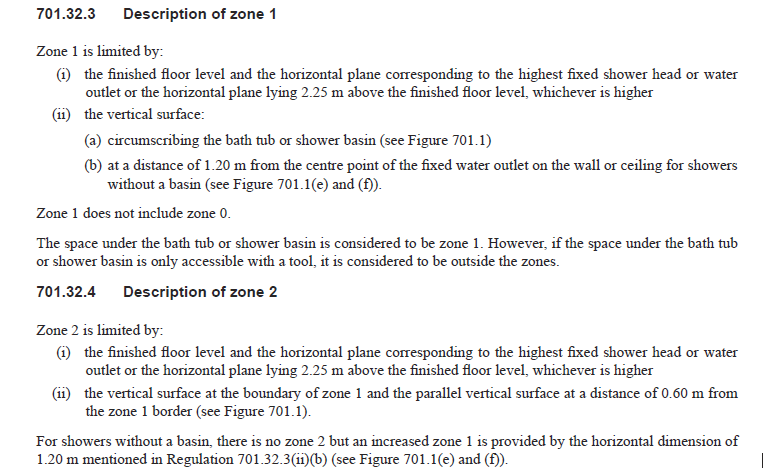

That's all wrong. Since the material you quoted was wrong, and the regs actually say that the zones stop at 2.25m above finished floor level, the light (at 2.6m above floor level) would not be in any zone. However, if it were less than 2.25m above floor level, since it is 'over' the bath, it would then be in Zone 1, not Zone 2.

Been out the game a bit but the last OSG that i have 17th AMD1 Page 83 8.1 Fig 8.1(1) has a diagram displaying the same zones as EFLI has stated.

From BS7671:2018 (the current version of 'The Wiring Regulations') ...
