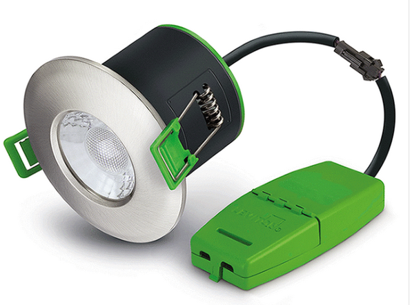

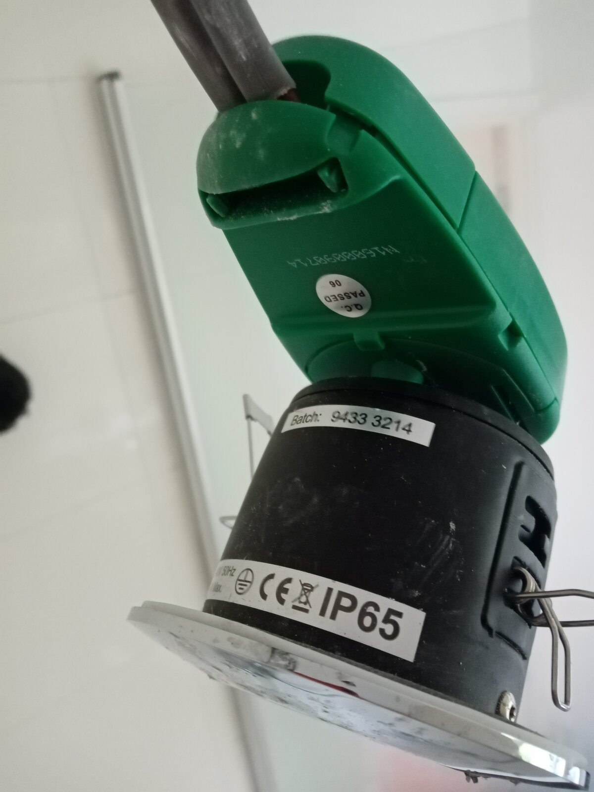

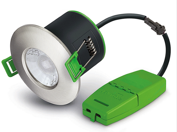

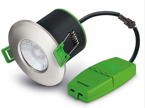

One of the led lights in my bathroom has now finally stopped working and I need to change the bulb.
Have pulled the unit out and can see it's a JC94472. It has a large green connector block at the back made by lennel. It looks like it should just pull away from this green connector but it's very tight and I didn't want to force it just in case.
Can you just replace the bulb inside the unit or must the whole unit that connects to the big green lennel connector be replaced?
Any hints or tips on this would be greatly received.
I quick google gets this 1708252669383.png and the add says 7.5 watt and a bulb holder does not give a wattage so it must be an integral using so whole thing needs replacing. I would guess when you get replacements there will be instructions on how the junction box opens.
Personally I would want GU10 fitting so I can replace the bulb. If a bulb blows I can walk into local shop and buy one, if I need complete fitting got to find an electrical whole sale outlet or buy from internet, so I want a bulb I can pick up in the supermarket when I do the weekly shop.

John done a teardown of a similar one years ago, I don't think they can be replaced.
  • Thanks
Reactions: WSB
I quick google gets this View attachment 333369 and the add says 7.5 watt and a bulb holder does not give a wattage so it must be an integral using so whole thing needs replacing. I would guess when you get replacements there will be instructions on how the junction box opens.
Completely agree with you but think these were fitted originally by the electrician as they are bathroom approved ip65 rated. Hence, approved for wet environments as opposed to the usual that you pink up from the supermarket.

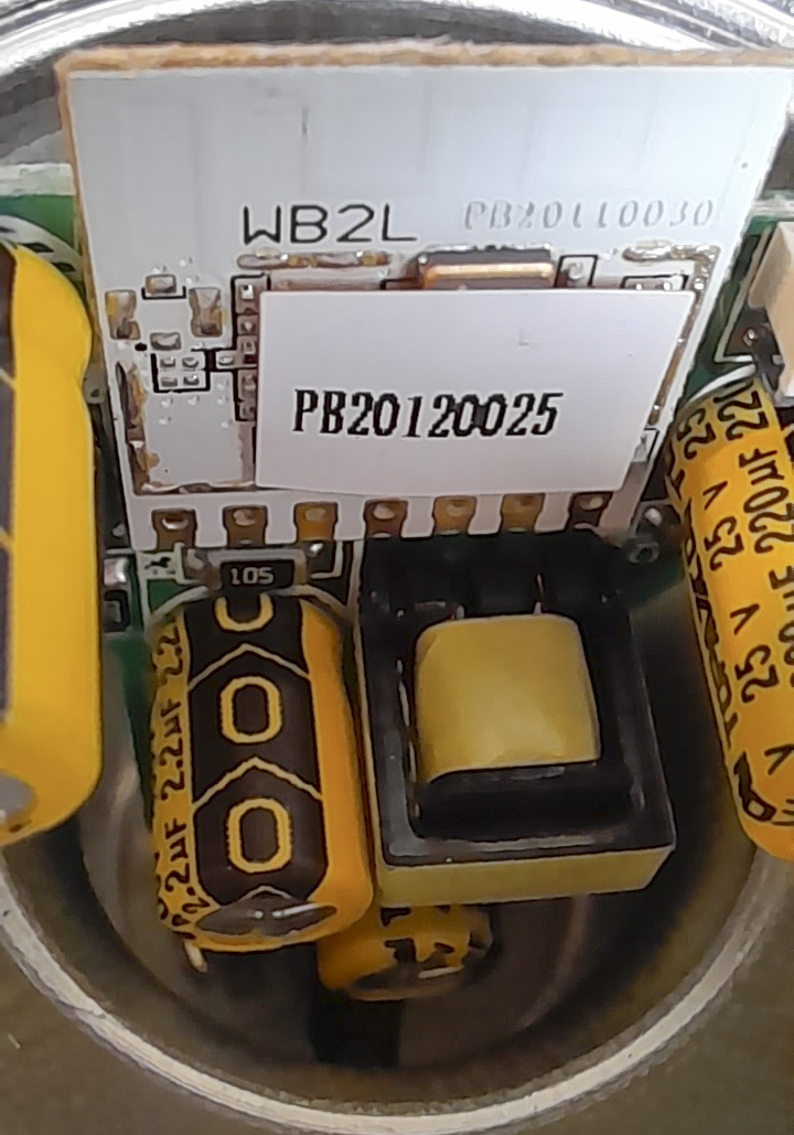

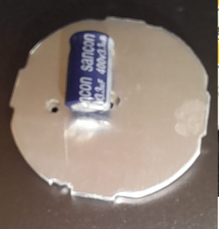

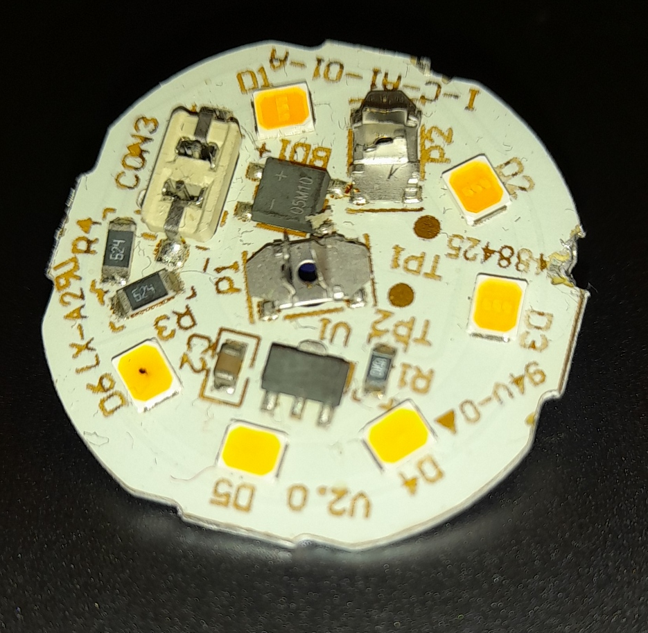

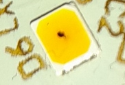

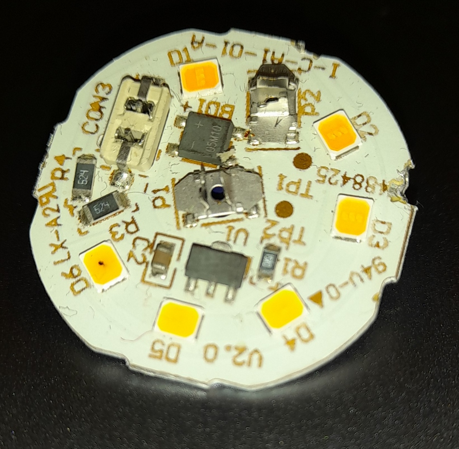

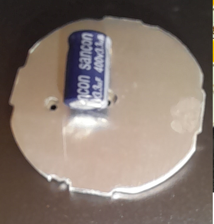

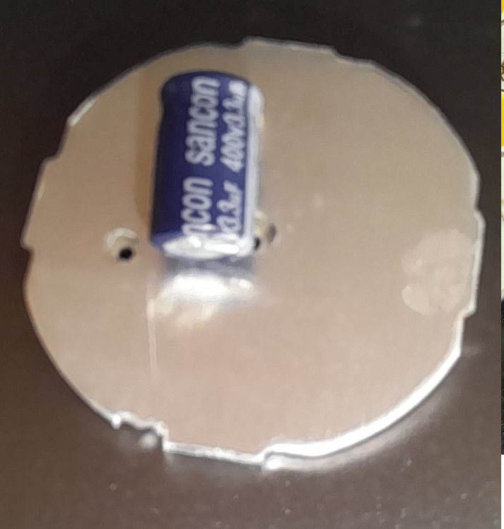

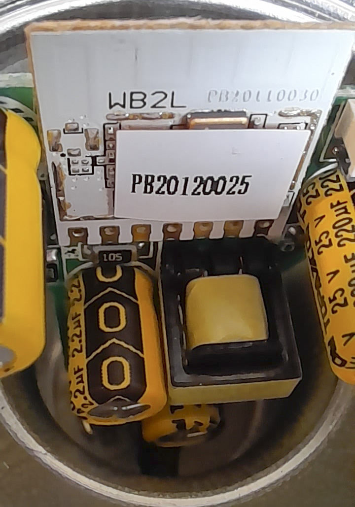

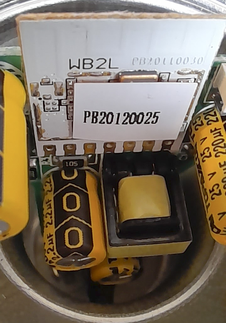

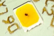

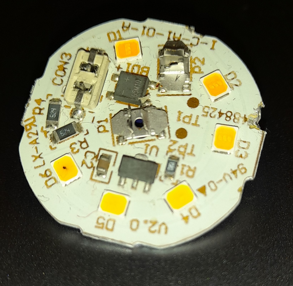

I did break open a standard LED bulb bulb inner1.pngbulb inner2.png not much in them, smart lamp version 20220603_113820_1.jpg contains a lot more of course, the black spot 1708258094607.png in the centre of the LED means likely that was cause of failure, but had not intension of repairing so did not bother to test. Did open up one where saw a clear dry joint so repaired, but took no pictures of it. The capacitor in picture two is what stops the 100 Hz shimmer from the LED and when the whole package is small, the likely hood of a shimmer increases, the capacitor does not like heat, and has a limited life, so that is the weak point in the bulb.
I started fitting LED from Pound World which went to the wall in 2018 so likely 2016 when I got the first, rather pathetic at 0.58 watt, but did not really need the lights, it was just they looked silly with no bulb in, so more like 2017 before I got any bulbs with a reasonable output, I think still around 3 watt, moved house 2019 so LED's in this house no older than 5 years, most a lot less. I must have around the 25 mark, and think I have changed around 4 as dead, but also taken around 10 out of service due to flicker, although not stopped working.
So it would seem average life is around 3 years. This does not match up with the hours stated on the bulb, but considering how many lights around the house I do not want to have to get out tools to replace them. There is always the odd bulb which really lasts, seem to remember reading how some fire house in USA has a bulb which has lasted over 100 years, but that's the odd one out, and it does not give out any useful light anymore, it is just a dim red glow.

I agree but can you get bathroom rated bulbs that can be easily replaced like you say?
I do not change bulbs while soaking in the bath, OK for a rental different when some one may list it as a fault, but too high to in the main come under bathroom rules.
It's for my home property.
These were fitted originally by a registered electrician about 11 years ago so guess he had to do things by the book.
