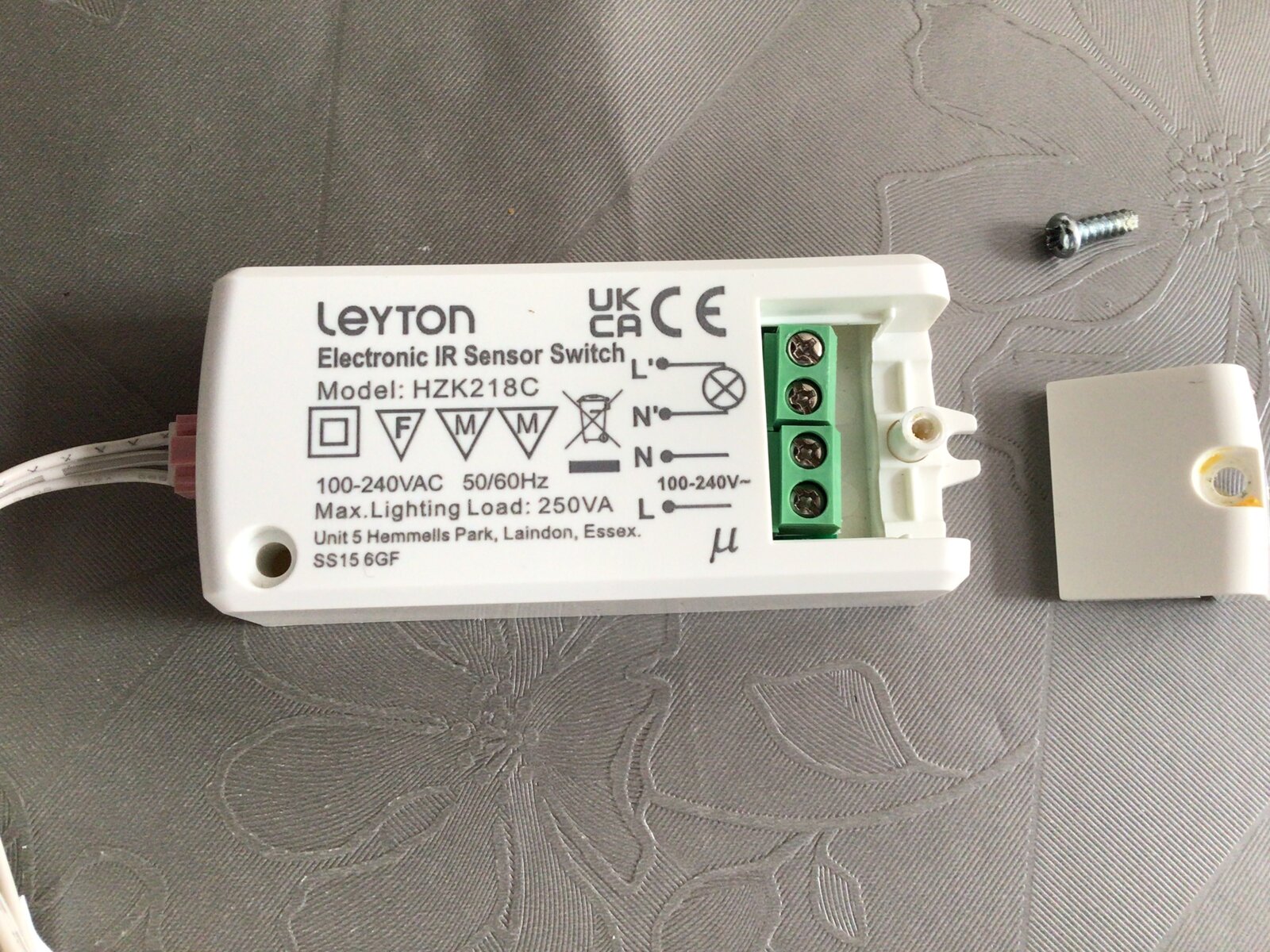

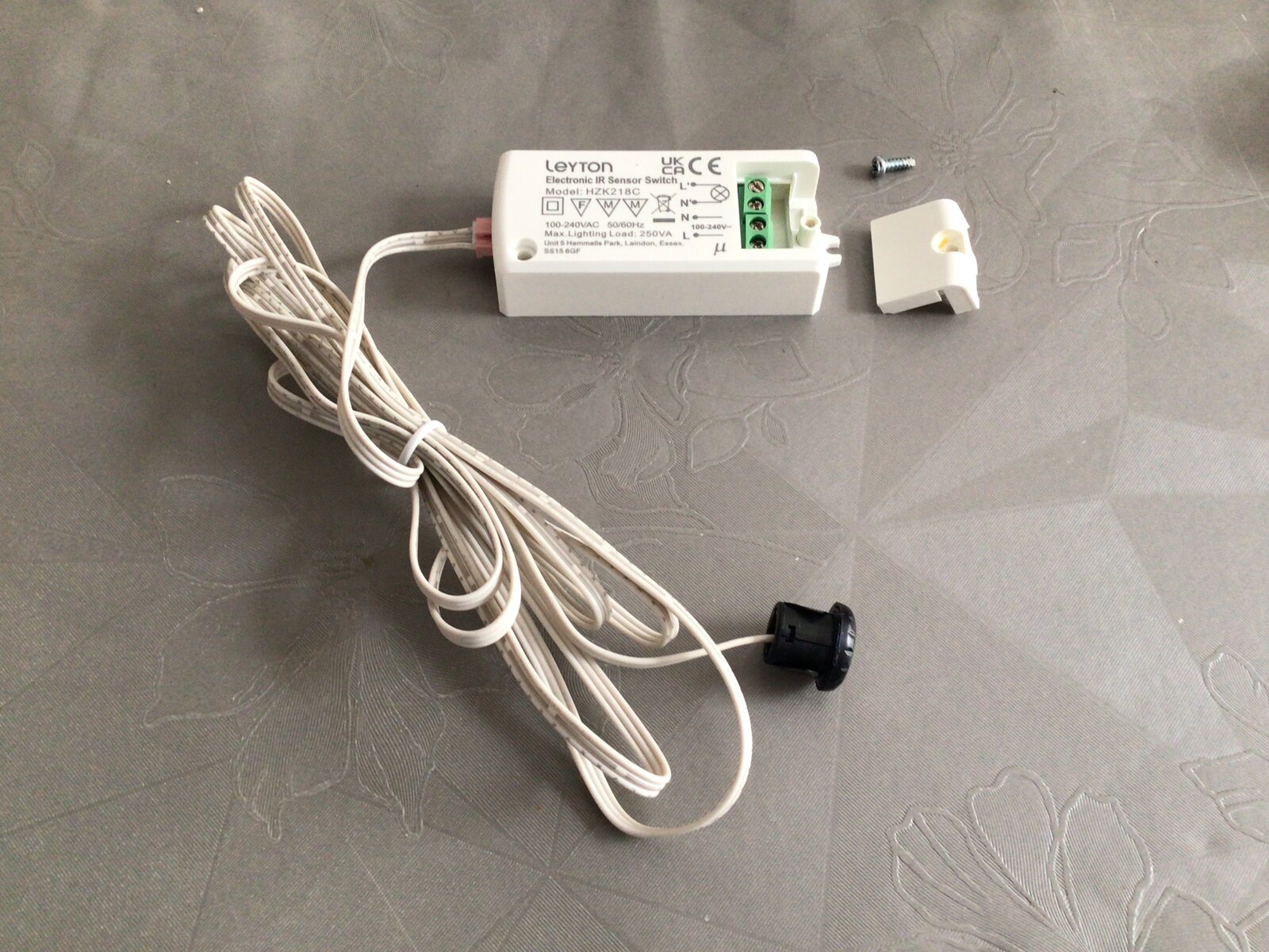

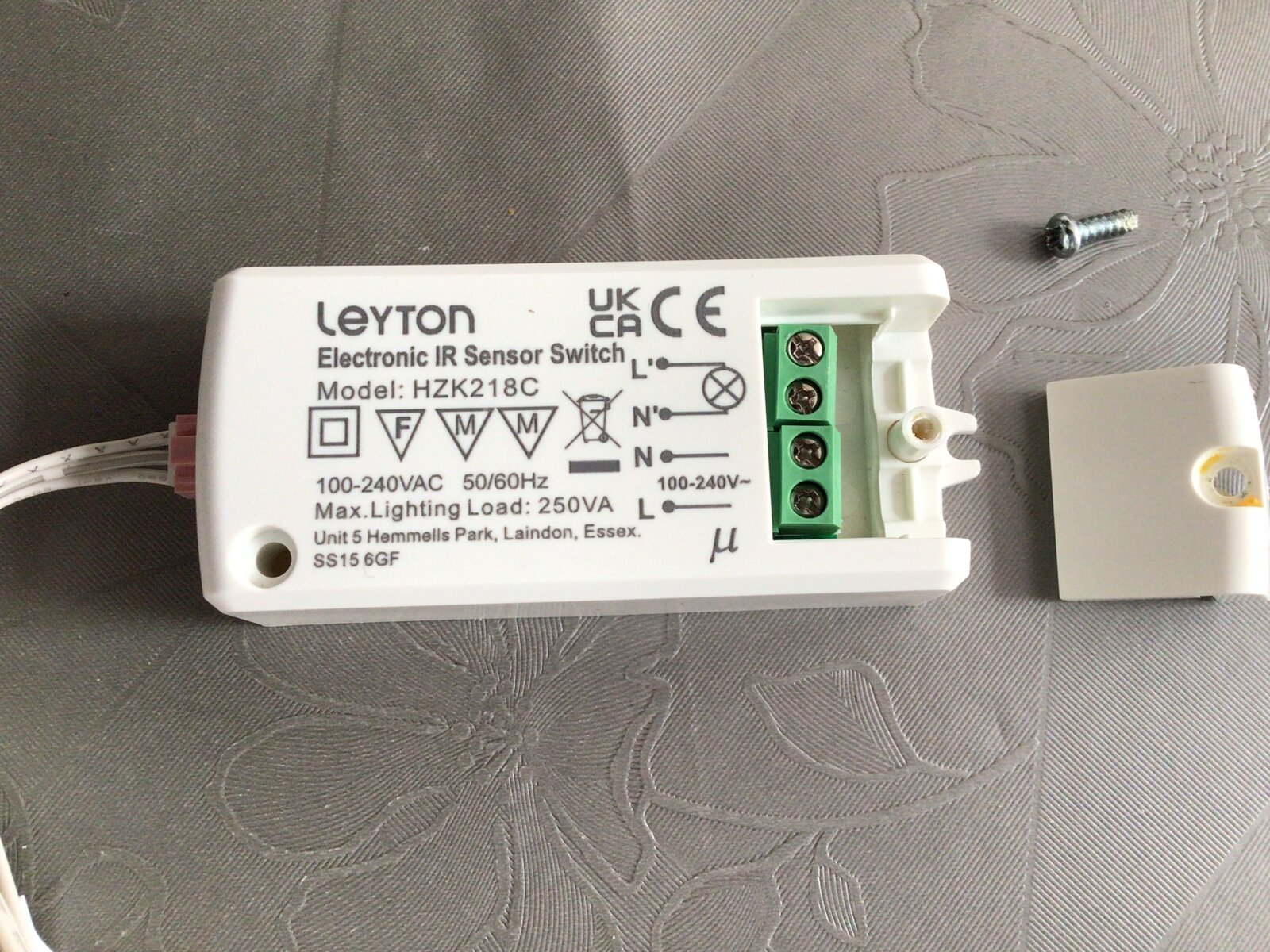

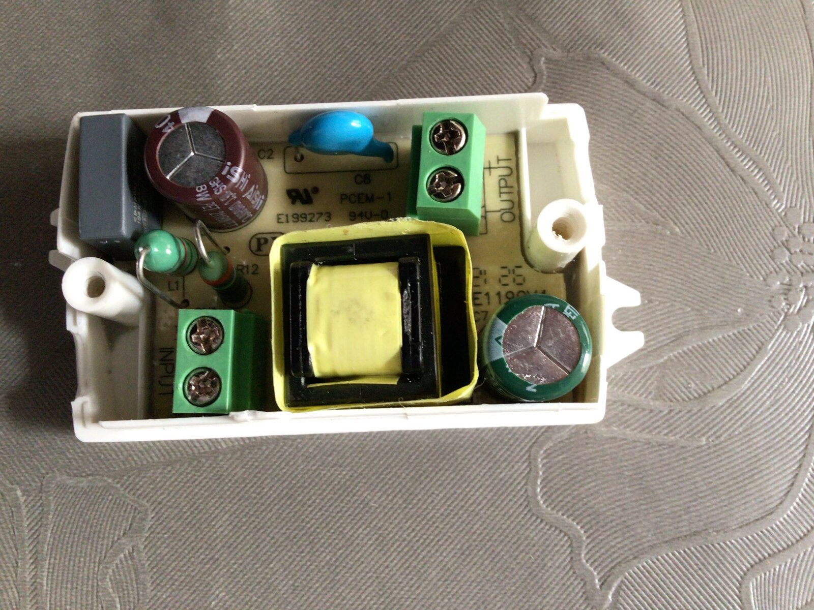

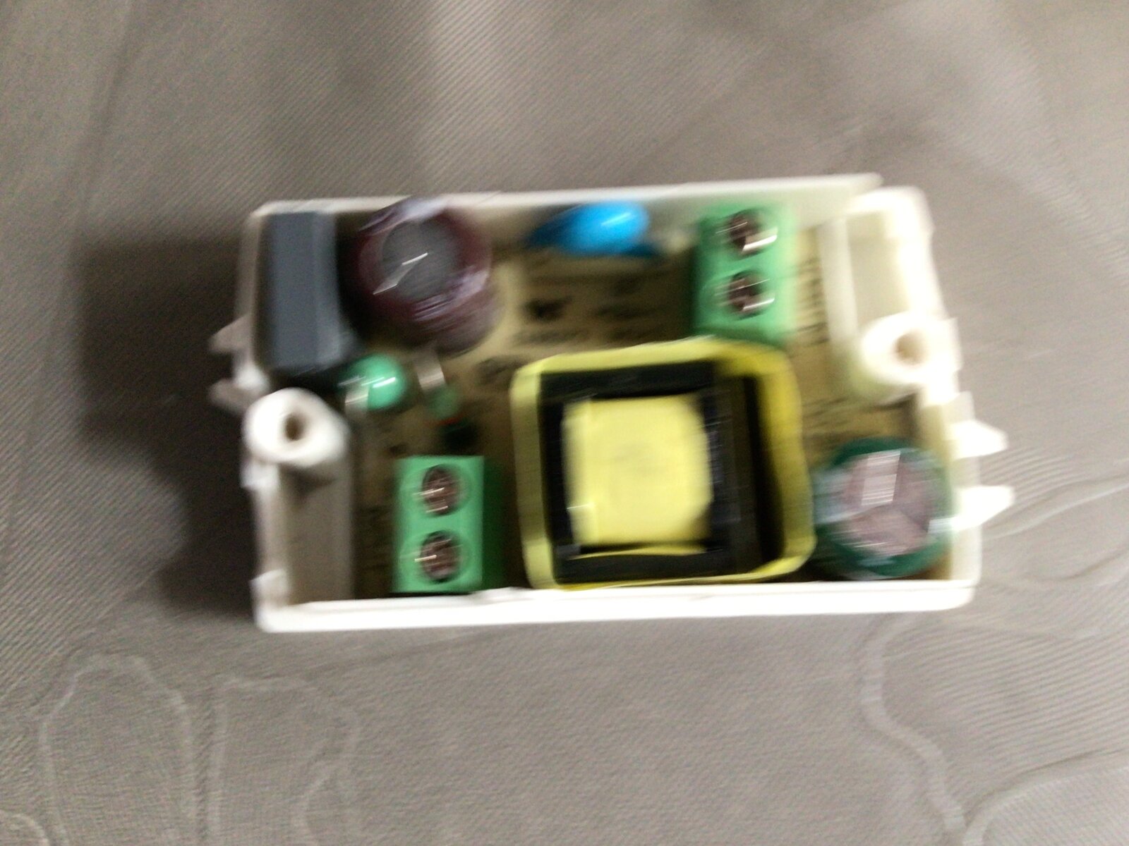

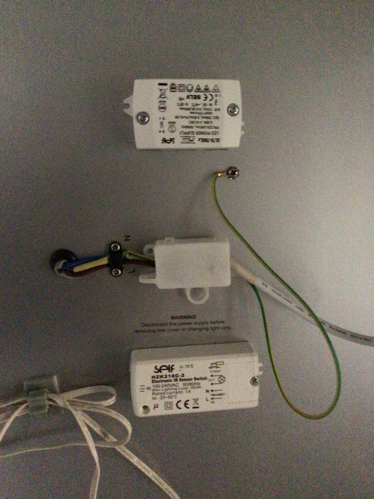

Hello,
I am trying to replace led driver and hand wave sensor in bathroom mirror and looking for wiring diagram.
Please let me know, if possible, with photographs.
Thank you.
Upload pics of what you have and you can get advice based on what is there now.
Blup
Hi Bulp,
Thank you for your response.
Here are photos.
Please kindly advise or send me wiring diagram.
Many thanks.

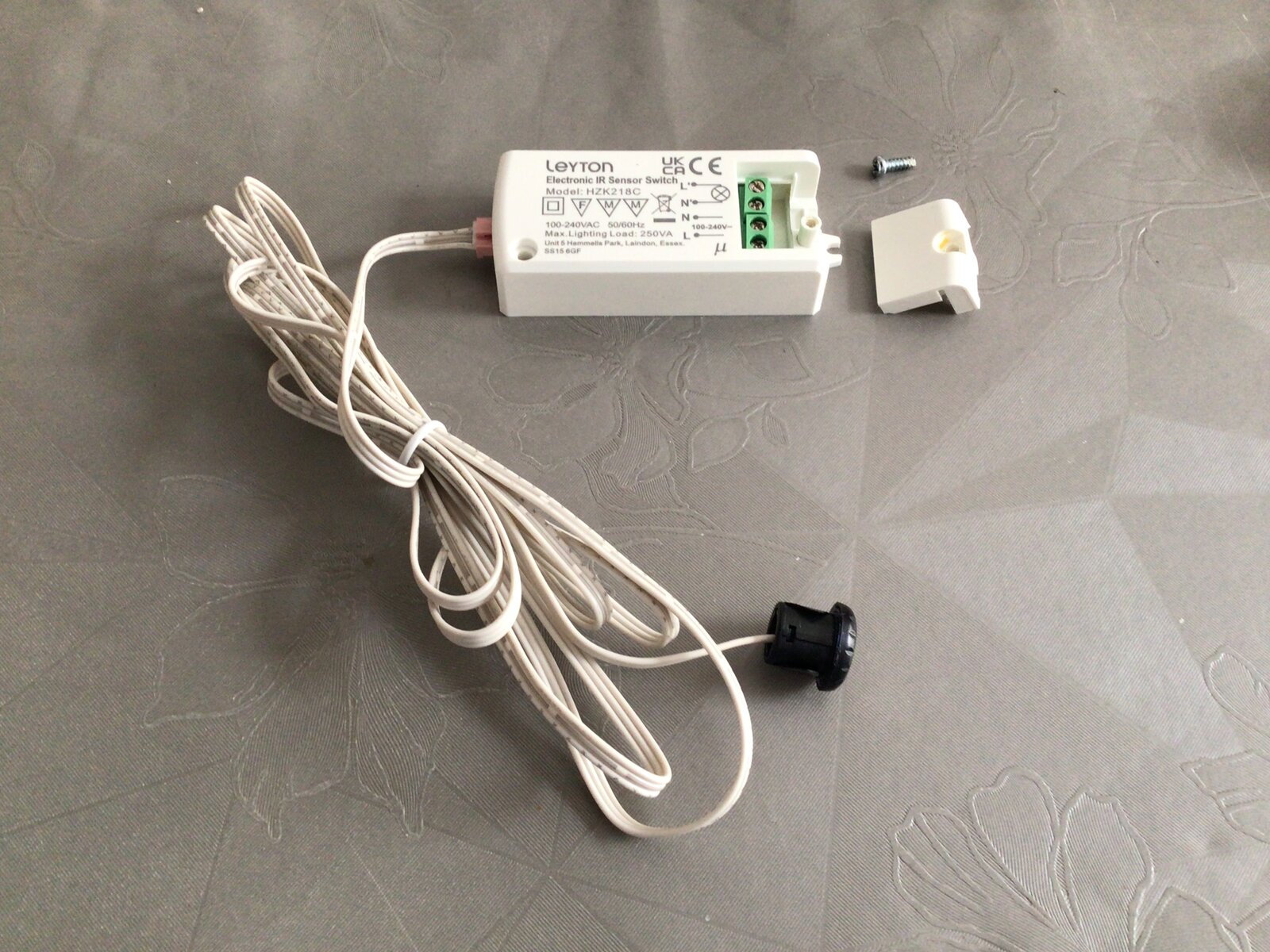

Hi Blup,
Sorry I mis-spelled your name. Accept my apologies.
Please note, the last photo is the old led drive and hand wave sensor, which Ai forgot to mention.
Thank you.
Kantilal
Frodos wiring above is good.

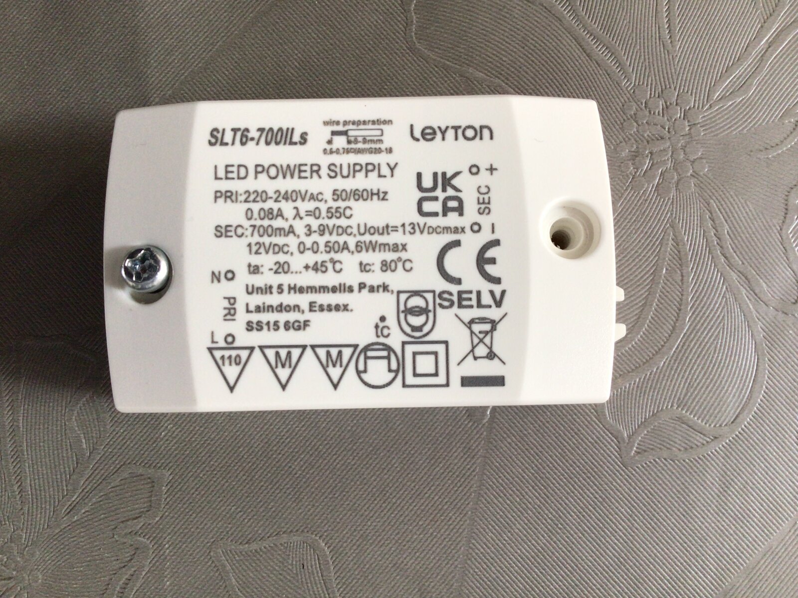

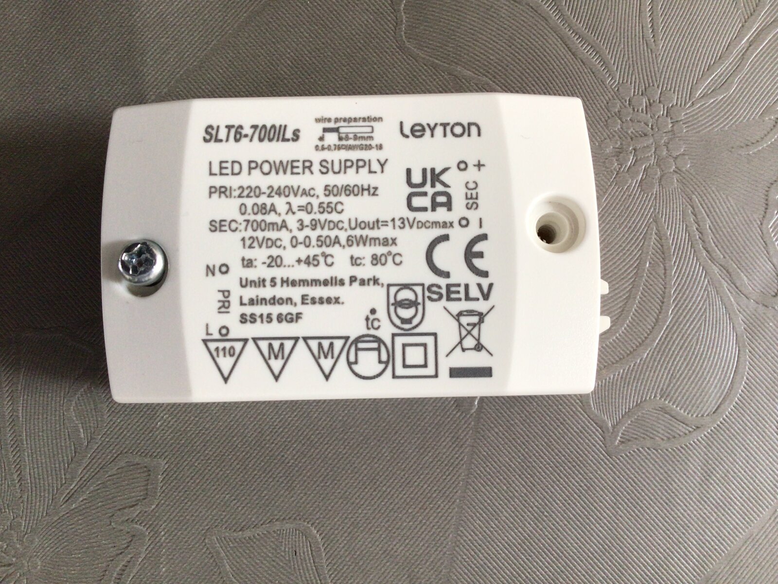

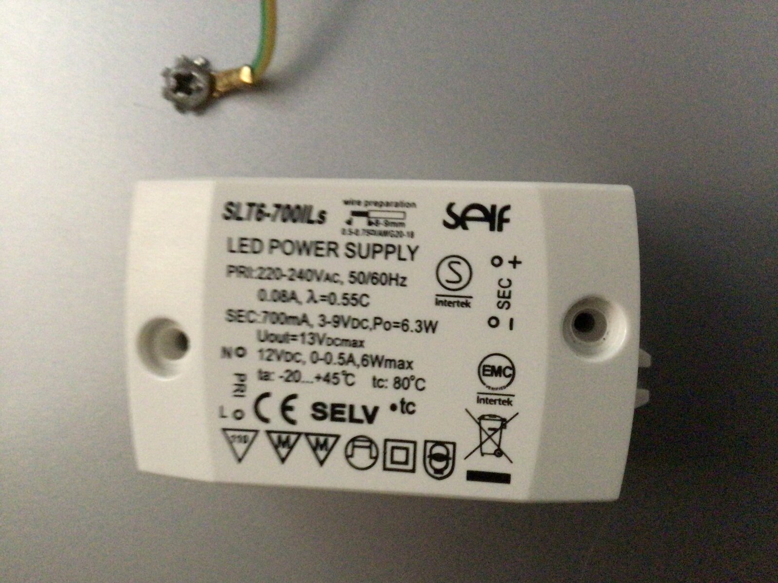

It looks like you have the same part number, but Would like to double check you have the correct led driver as there are two types you could have bought, constant voltage and constant current.
Please can you show two images, one of the label on your old driver and one of the label on your new led driver.
(Ie the writing on the plastic of the LED drivers themselves).
Thx sfk

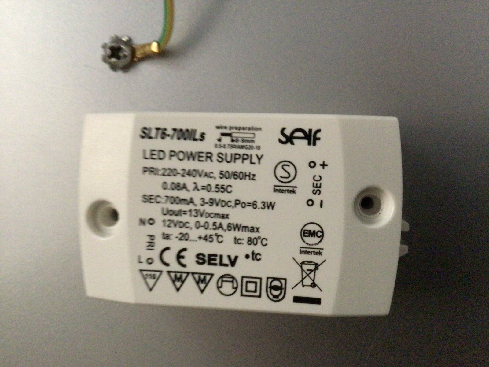

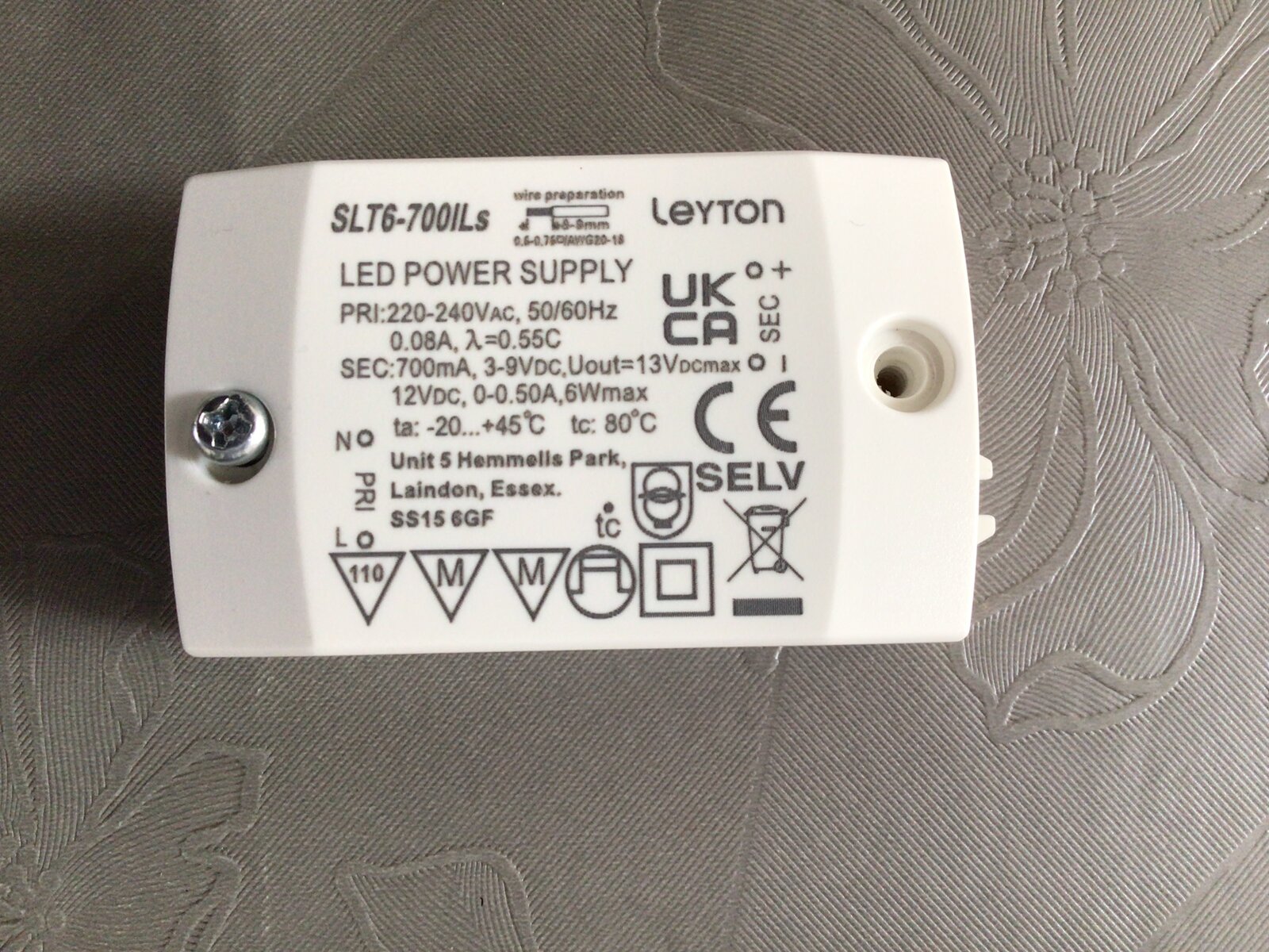

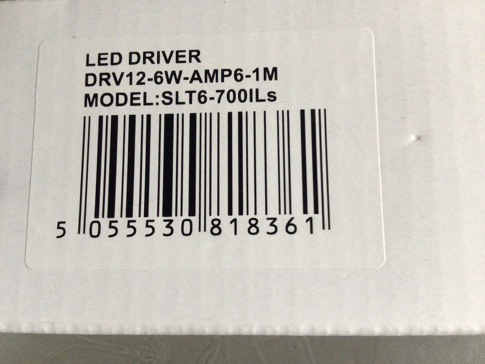

Hi SFK,
Thanks for your comments.
Please see pictures as attached and let me know what you think.
1st pic is old driver and 2nd pic new driver.
Once again thank you for your help.
Both absolutely identical - it was my mistake when I was looking at the images.
To add, be careful when wiring as some of the wires are 240v (dangerous) and some are 12v (safe).
When you have both it can be easy to become flippant / relaxed and accidently touch the wrong wire. Make sure mains are isolated.
Sfk

Hi SFK,
Neither are "Drivers"
They are BOTH 12V "Power Supplies"
"DRIVERS" provide a constant current - to the device concerned.
"Power Supplies" provide a constant Voltage.
Kantilal
For which I thank him/her.
Spec appears to be:
Input Voltage: 100- 240v – 50Hz
Constant Current Output: 700mA
Constant Voltage Output: 12VDC, max 500mA, 6w
Output Voltage: 3-9VDC
Not really sure what to make of that...
