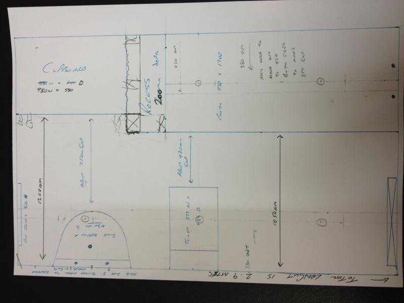

Has anyone fitted these at all and if so how much spacing is between each light? My bathroom is 1.8 x2.9. I've bought 6 but was only planning to use 5 in the space I have please see below a bathroom plan I have tried doing. I was gonna place two above a 750x1700 bath then three more down the same wall where the toilet,sink and window is. The sixth light could come into play if required. Can someone advise

I did get them off e-bay. The whole bathroom is being ripped out including the ceiling so not got any worries with that issue, just was after a spacing from each light. So say they centre over the bath witch would mean 375mm. But how far from the other wall do I also do that at the same measurement?
your plan looks ok but with those fittings I would be installing anoth three down the middle
I was going to central the lights down the middle of bath which would mean they come out to 375 and come away from the other wall at 400 then a 900 gap, another light then that leaves 400 gap at the wall. Wot space is require for the next line?
The spacings look ok to me (subject to there being no Ceiling Spars in the way )
Seeing you have "spare" one I`d fit in between the end Bath point and the Toilet

Would I be just as well fitting four down the window wall they would work out about 580mm between fittings then the other two over the bath spaces almost the same distance?
Yes that will work , subject to where the Celing Spars are , try get one directly over the Washbasin though
