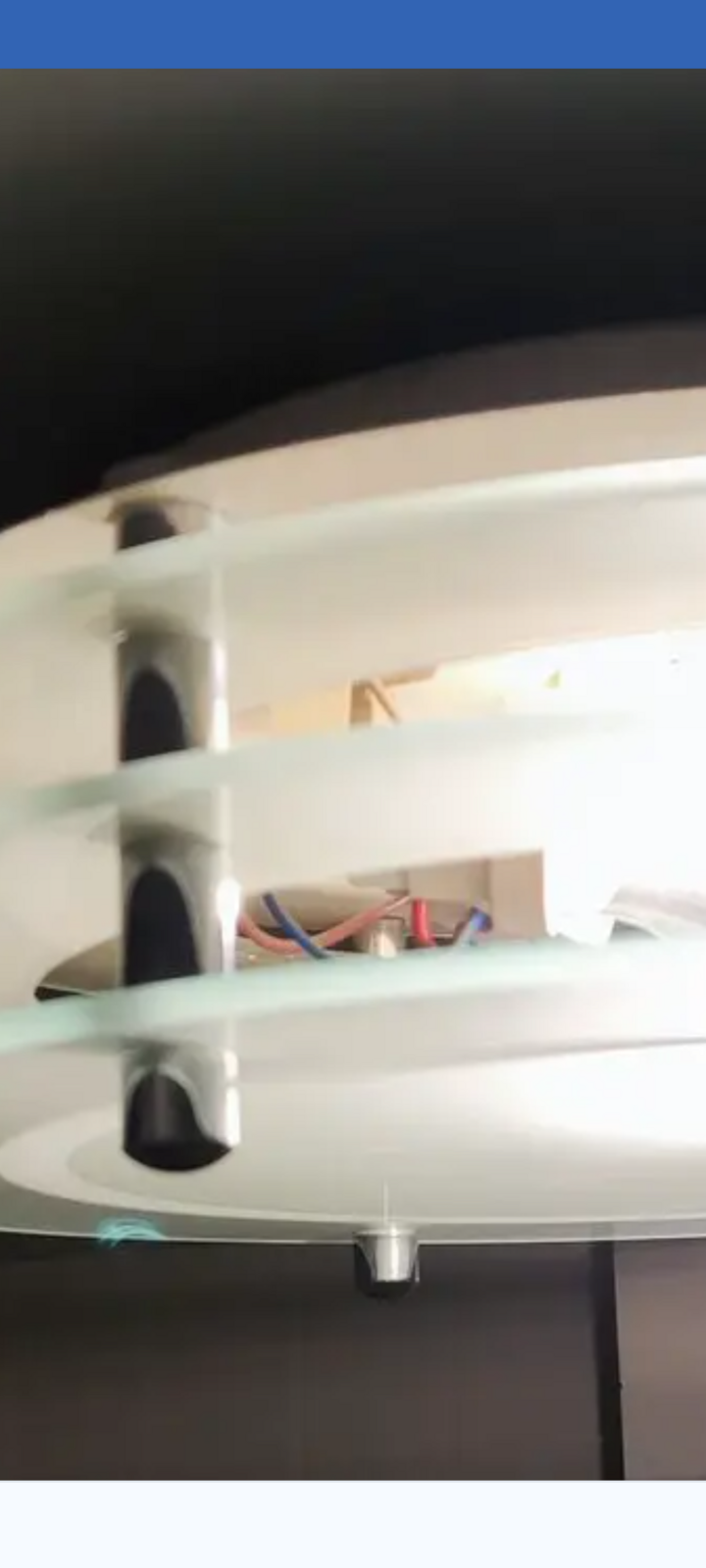

My electrician has advised me that my bathroom ceiling light is not IP rated and should be replaced (photo below). It's not above the bath, but about 80 cm away from a point above the closest edge of it. Its base is 2350mm above the ground, which, according to this website https://www.thelightingsuperstore.co.uk/bathroom-lighting-zones is sufficient for it not to need an IP rating. It is, as you can see, rather open. It came with a semi-transparent plastic circular guard, but this was useless as the heat of the lightbulb quickly caused that to disintegrate. So (a) should I replace the light as suggested by the electrician, and (b) as an alternative, can I source a replacement guard to go in there?
Thanks.

I am a bit surprised that I can see the wires.
Could they be better routed (pulled or pushed up into ceiling?
And does the brown (live) wire have bare copper showing or is that just an effect in the image?

I too didn't like the look of those wires or even the light fitting itself in a steamy bathroom and I think you are right in spotting the bare wires.

It's just an effect - that part of the wire caught the light. I'll see if I can push the wires up into the ceiling.
