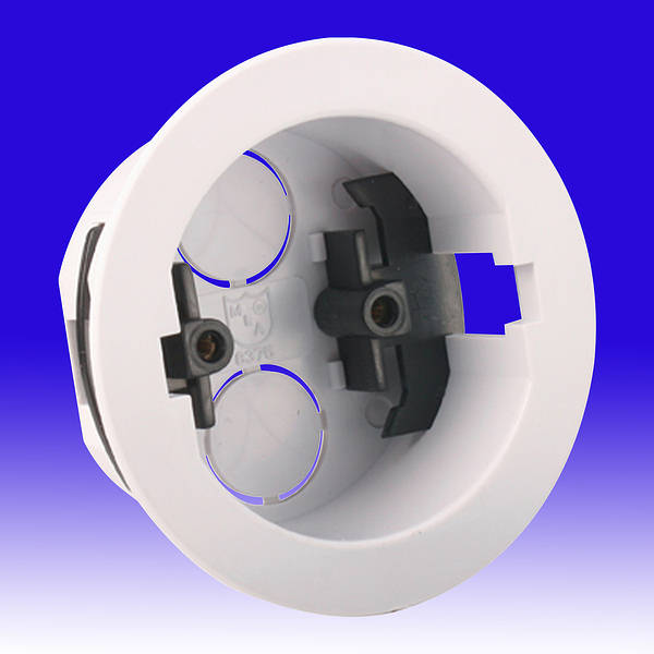

Can I please have a recommendation for a bathroom light please.
The room is 2.5m x 2m and has one central light point. I have the live in, out , extractor and switch cable here. I was after something that will allow me the space to wire these in.
You got access to the space above the cables ? If so use a junction box there and just have one ,3 core going to the light. You can then have pretty much any fitting suitable for bathrooms.
7F77DE8D-0C60-4B55-981F-363B33EE0DC6.jpeg Sink one of these in the ceiling
make connections there. mount light over the box
Simples!
