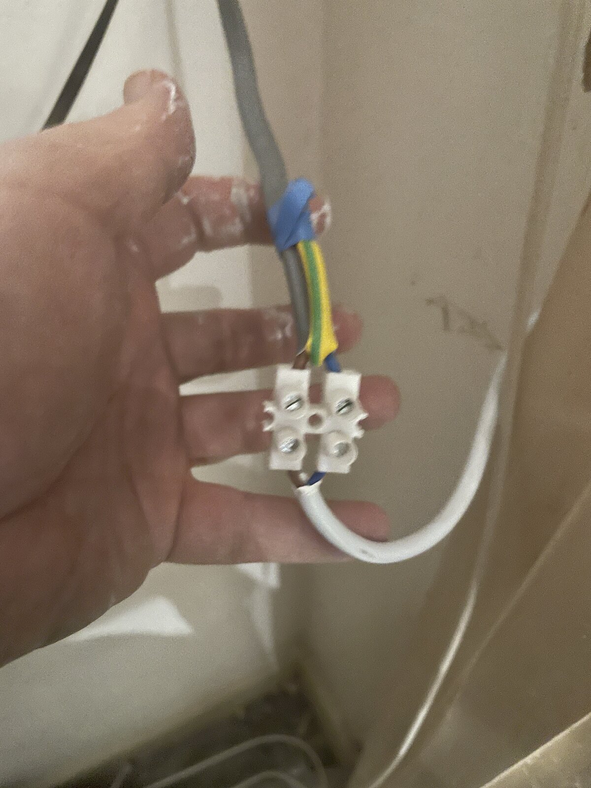

9649BDED-5686-4403-B3DA-E6D2010EA337.jpeg Hi I have been slowly adding neutrals to my light switches by changing to 3&e and finally did the last one (shower room) but found the bathroom mirror wired like the photo( I added the sleeve till I find out better) so traced the cable and it’s wired into a connector block on a ceiling light so powered on when the lights are on( so changing all the connectors now). So how would you connect a mirror with light and heat pad controlled by touch sensors ?
The mirror is wired correctly.
You will need to alter the cable at the ceiling light so that the Brown wire is connected to the Supply Permanent Live instead of the Switched Live.
Thanks so I don’t need any switches or fuses ?
No, but you will have to turn off the mirror when you are finished with it - unlike now when you just leave the room and turn off the light.
