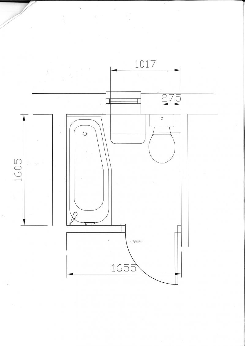

I have spent a year or more getting funds together for our bathroom project and have finally pushed the button on things and the contractors have commenced today. I live in a typical turn of the century terraced house with three bedrooms, the bathroom at present only has (or had) a shower, it’s odd because every other house in the street seems to have enough room for a bath except ours. The room’s is pretty small at about 1600x1600 currently with a corner shower, separate toilet and sink/vanity unit. But we have young kids so a bath is a must.
So I found a small 1570L Bette steel coffin bath which cost the earth but was the only one that fitted, a toilet & basin vanity unit (more suited to a cloakroom really because of the size) will be fitted too and the door will open out as opposed to in as it does at present. The shower head will remain. As the previous bathroom had been done to a good standard with floor to ceiling tiles and funds were tight I have had to resort to just having contractors replace tiles that required replacing though that still amounted to around 35 tiles of which I have sourced.

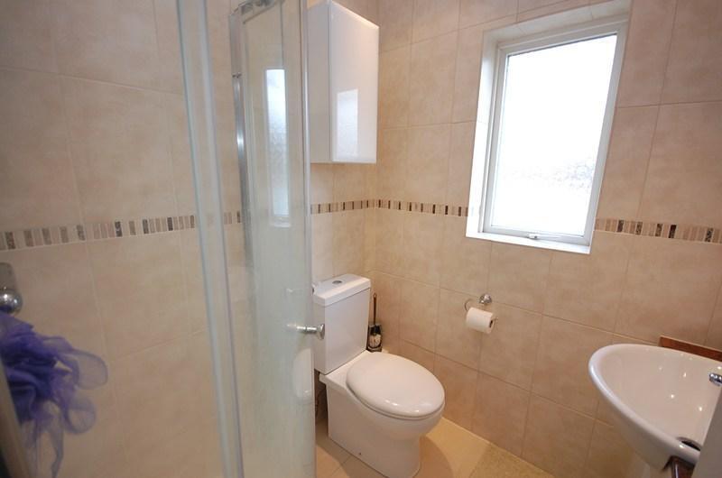

As existing

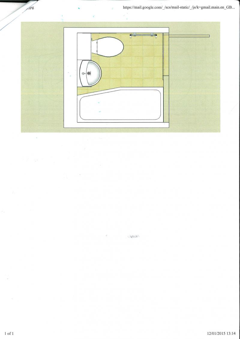

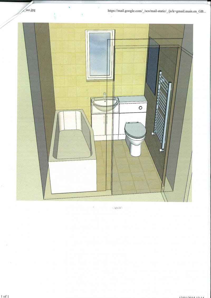

Proposed
Proposed
Proposed

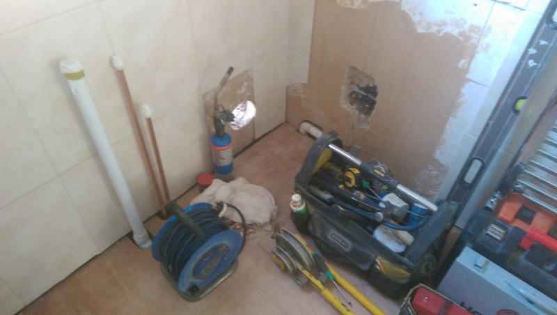

Day 1 Progress Photos
Am happy with progress so far, seems the walls are generally sound as was concerned that half the wall would come away when the tiles were being removed.
As expected the existing floor was chipboard and was wet, to be replaced with Ply.

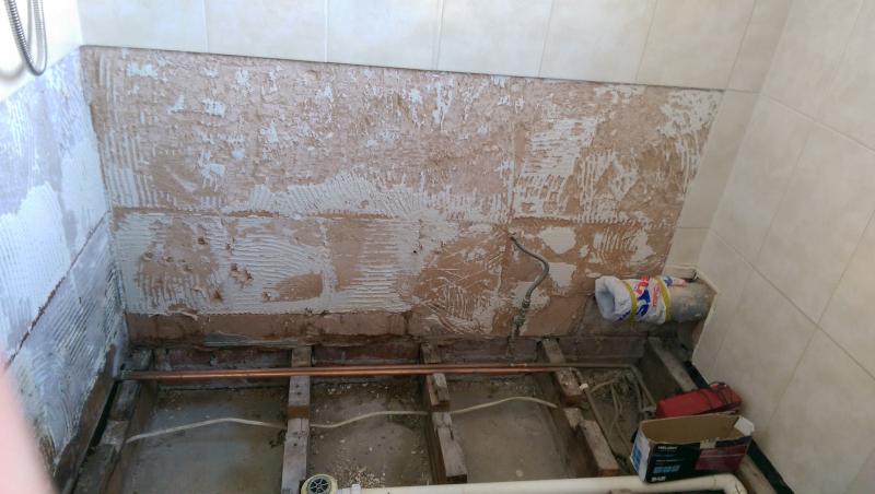

Old vanity unit removed, it appears that on this wall at least the previous occupants tiled over the existing tiles.
The bath will go along this wall.

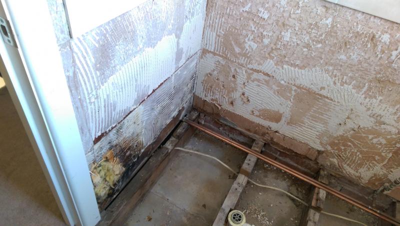

This is where the shower was, water damage to existing ply so that will be removed/replaced as required.

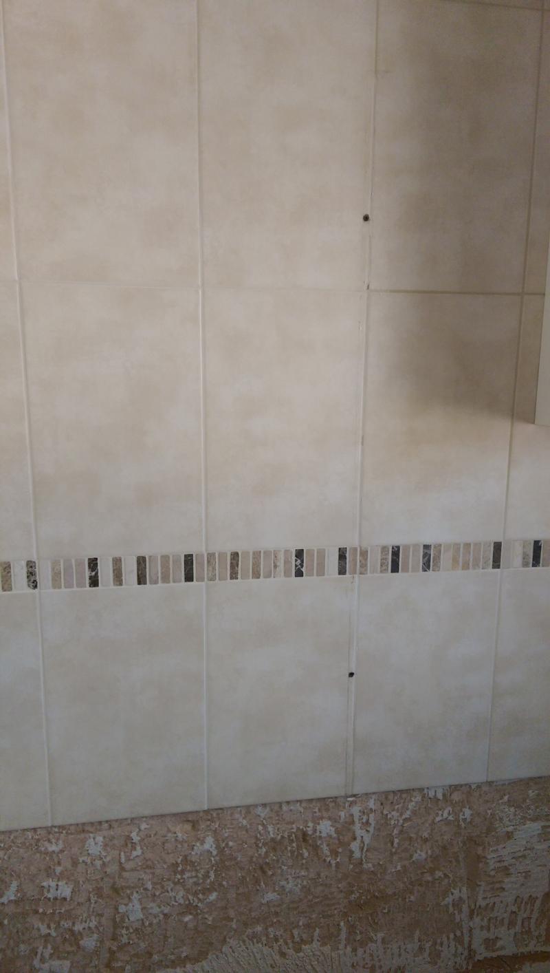

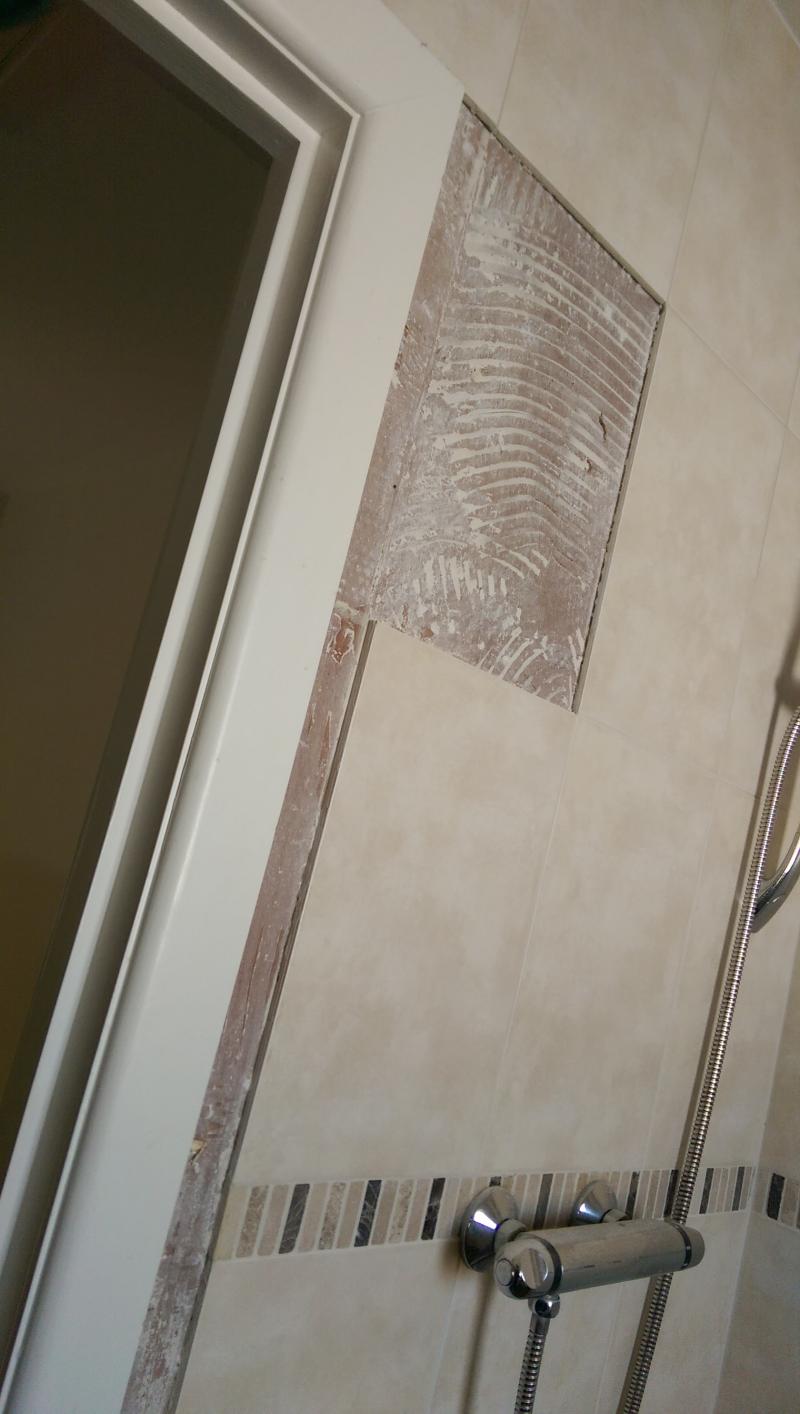

Tiles removed where shower screen was fixed through tiles.

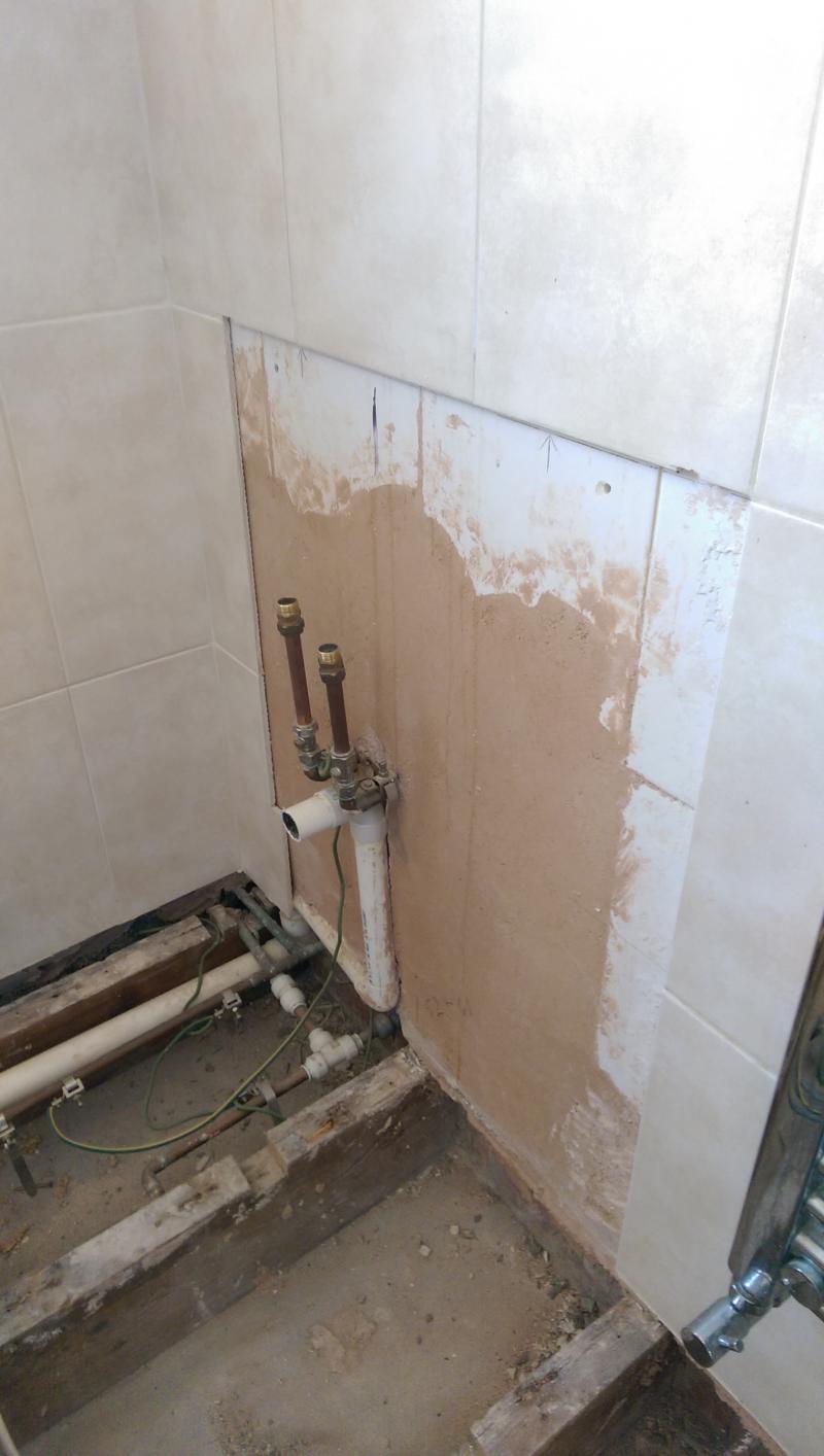

A few more tiles to be removed where existing fixings were located.

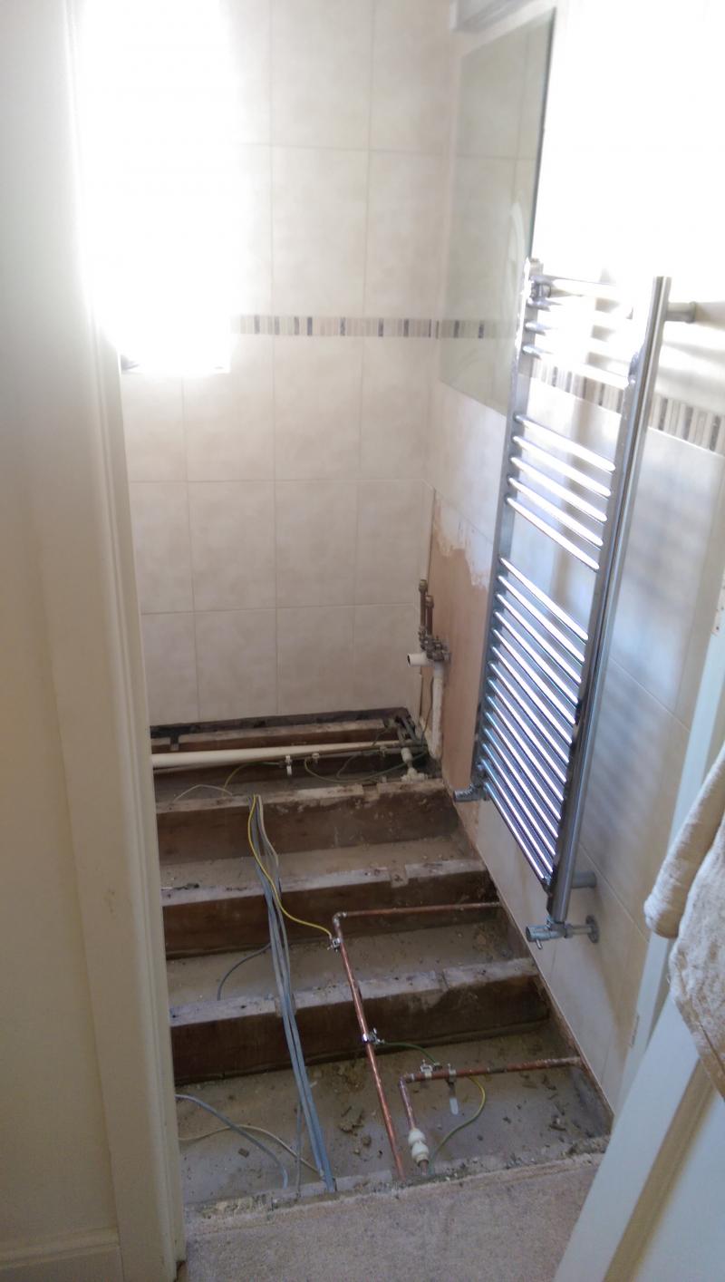

All the pipework and drainage under the floor has apparently been completed and a new plywood floor has been laid. We had tiles on the floor but we will be putting vinyl sheet back down, what is apparent now(and pretty obvious in retrospect) is that because vinyl is obviously a lot thinner than the tiles there will be a big gap between the floor and the bottom row of tiles so I will get them to add another layer of 9mm ply to raise it up a bit.
Behind the shower where the plywood was damp the plan was to fit a sheet of aquapanel however the existing plywood is 9mm so it will be plywood going back as aquapanel is 12mm.
New floor down

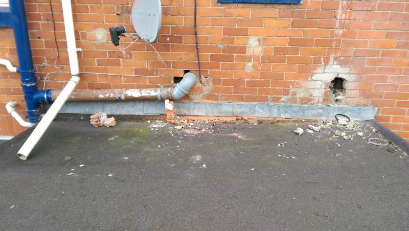

New toilet waste hole through wall
Existing plywood behind shower now removed

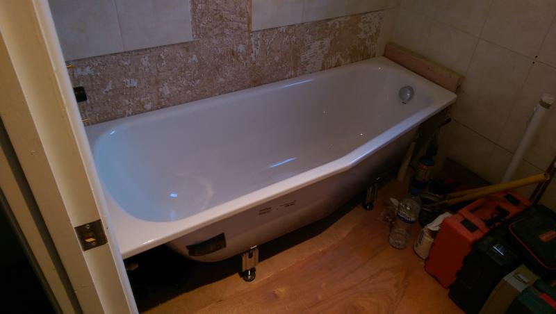

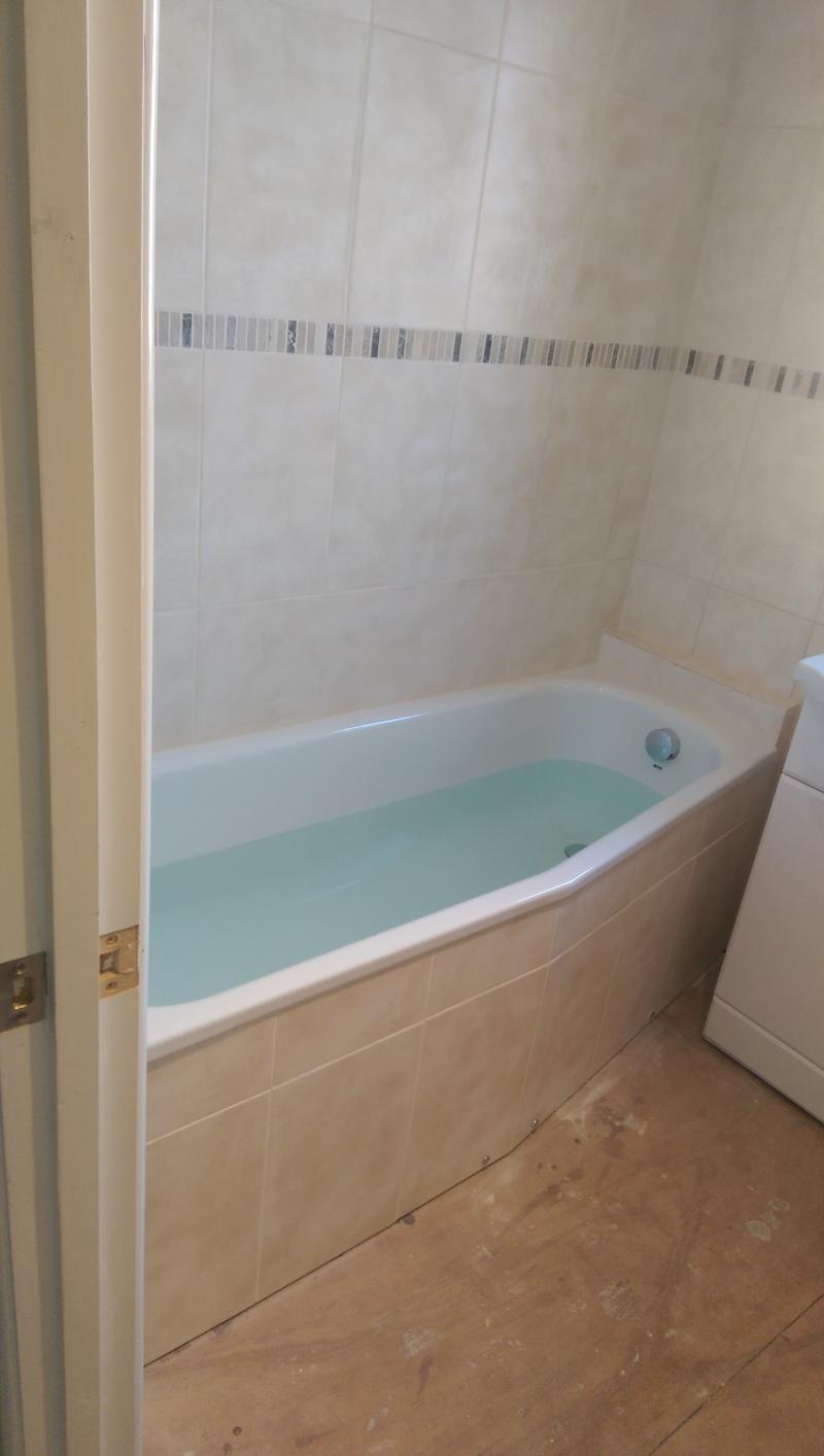

Bath in position
Bath was a nice snug fit, far more room in the bathroom now and room to stand in the bath to shower which was a concern because the bath is quite narrow as well as short.

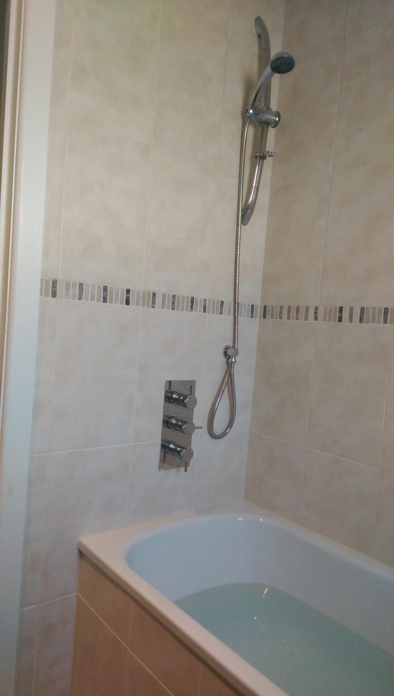

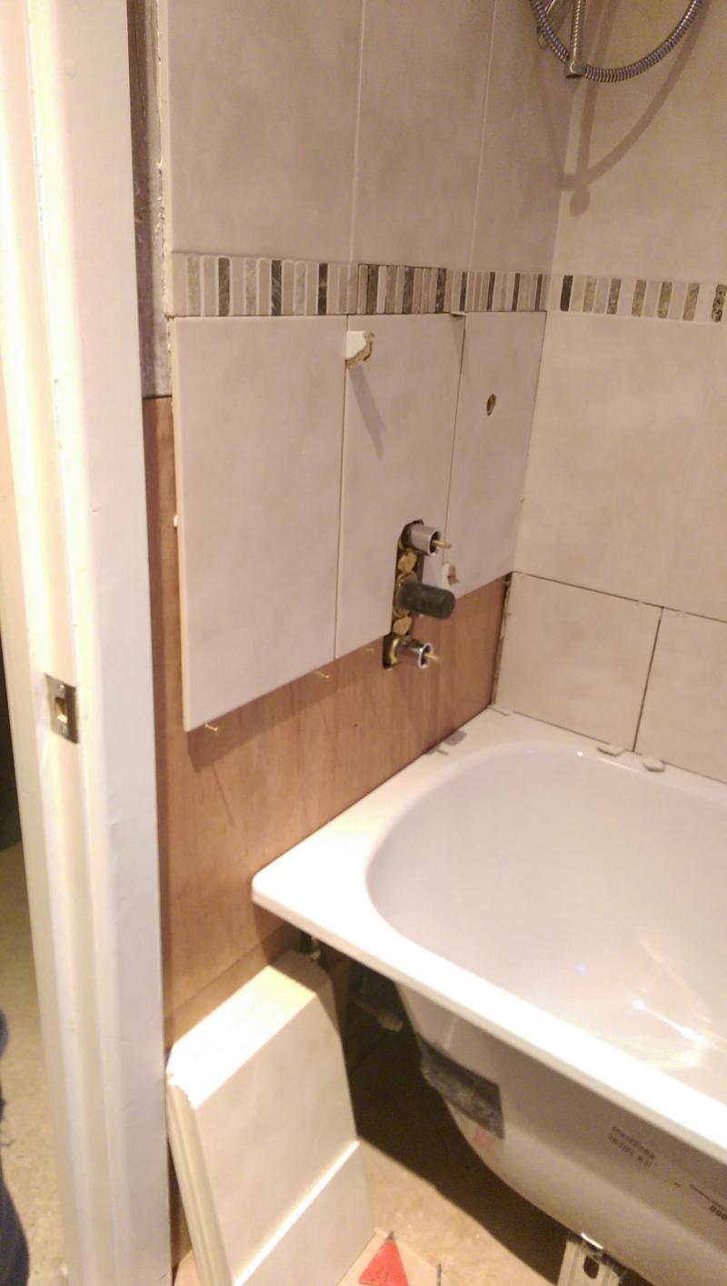

Shower valve in position, there happened to be a stud and noggin bang in the position where the shower valve would have ideally gone (in the centre of a tile), so its gone centred over the bath and as high as possible. funds would not permit the additional work involved in moving stud/noggins.

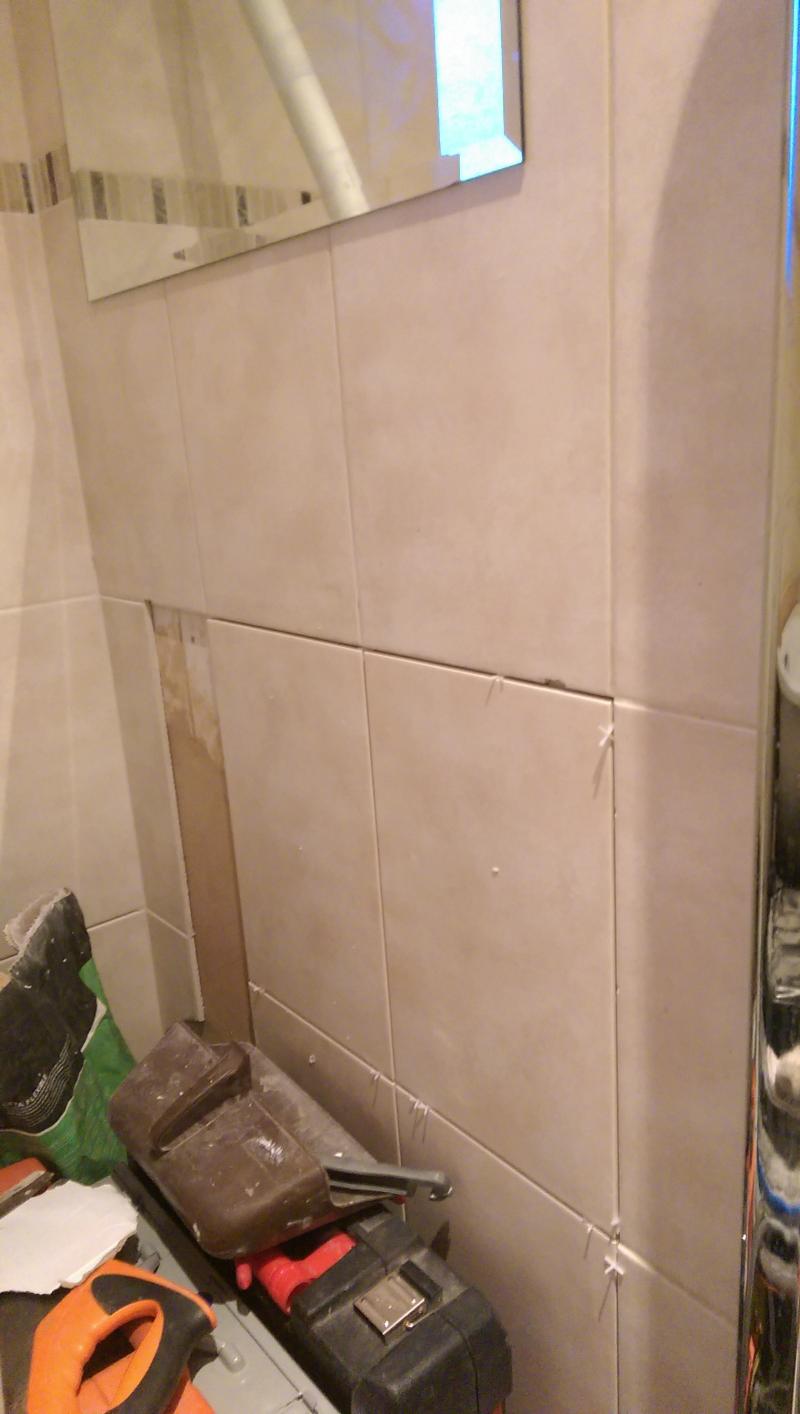

There is a tile cut-out in the bottom edge of two of the tiles that’s under the mirror on the right hand side which can be seen (the mirror not the cut-out) in my 3D image and the first photo of my second post, next to the radiator which was done by the previous fitters to make the old vanity unit fit. As the toilet is going against this side wall it may be that we can fix the toilet roll holder over the cut-out, but I won't know if this will feel right until the toilet is in place. If it’s not then the tile will be replaced which will mean the mirror will have to come off and probably all of the tiles the mirrors fixed to, about 6, so that will be an extra if it happens.
Cut-out in the bottom of tile, if you have keen eyes you can just about see one down the other end too, the mirror is just above, bonded to the wall

Day 4
Some tiling has gone on, though progress is not exactly rapid otherwise. Though they could not work from between 10.30 and 1pm today as events in our household meant it was not convenient for them to be there, though they didn't seem to mind. the new tiles are fortunately a good match to the existing.

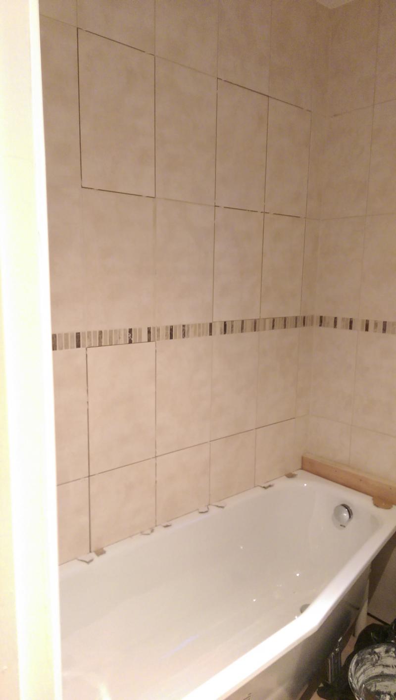

Tiles under mirror attached.
Tiles surrounding bath going in, the existing cabinet removed, four tiles replaced at high level.
Tiles to end of bath nearly completed.

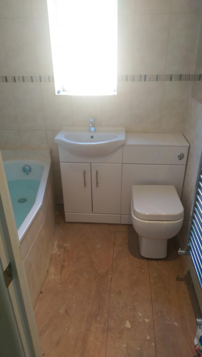

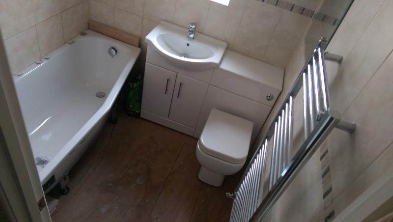

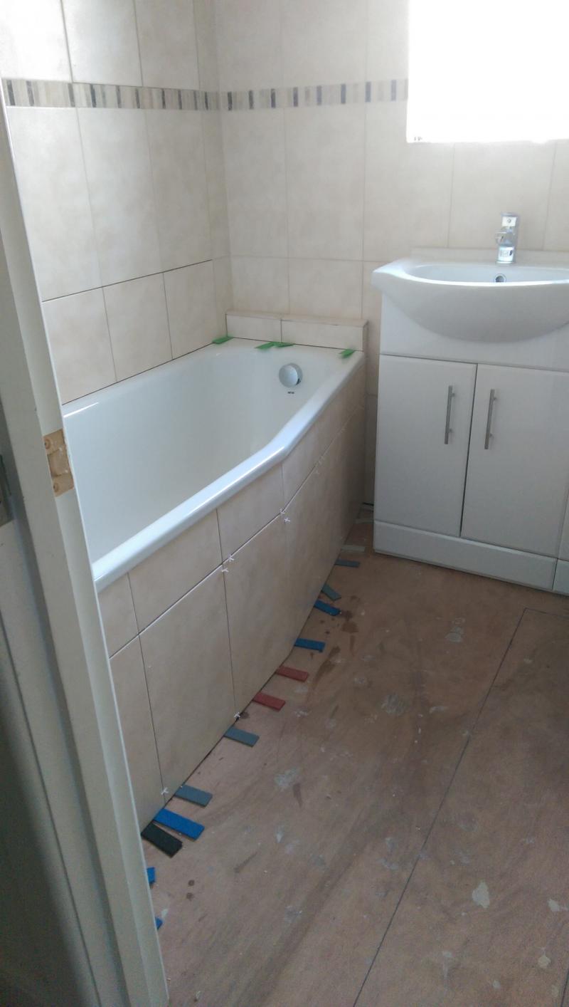

OK so the vanity units and sink & toilet have gone in, really chuffed at how much room there is now (compared to before). Cocked up a bit on the toilet choice though to be frank, its a very compact fella with a very rectangular pan and with it being so close to the radiator you can't sit on it perpendicular to the rear wall, as you should so you kind of have to sit on it at an angle as your knees hit the rad so hardly comfortable. Still at least no one will be taking their time to have a dump! :p May shift the radiator when funds permit to alleviate the clash. Tis a good flusher though which is always a bit of a concern when you buy a new toilet and (apologies for the crudeness) your turd drops into the water rather than on the porcelain as it seems to with some toilets so that's good.

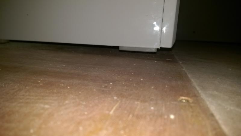

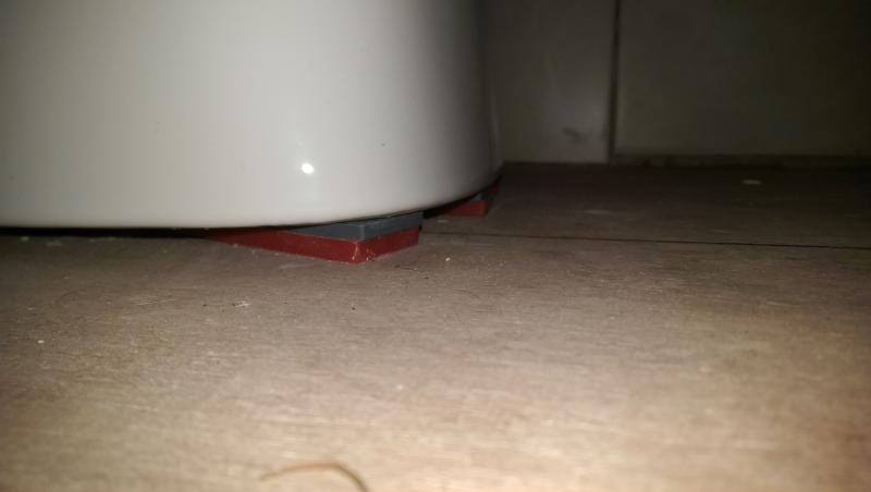

The muppets, sorry workmen, fitted the vanity units back to the wall, as you would expect but clearly the thought of ensuring the floor was level beforehand had not even entered their minds as there was about a 6mm gap under the feet under the front of the vanity units, tapering back to about 4mm at the back.
Exactly the same occurred with the toilet pan, which they sat on various spacers.
This is obviously outside at the end of this day, the old sP on the right and the new one on the left, supported on some bricks, hardly impressive!
Now fortunately they hung around on this day and I managed to leave work a little early so as to be able to see them before they left. The first thing I said as soon as I saw the vanity was why is there such a big gap under the vanity units any water that's spilt would simply flow into the gap. Some scratching of heads occurred and a silicone solution was proposed. Not impressed. The floor will be vinyl sheet and will be sealed at the perimeter with silicone anyway but a 10mm silicone joint was too much of a bodge for me. Anyway all was fairly amicable and they left for the weekend to return on Monday to continue.
Over the weekend I gave it plenty of thought as to how I felt it ought to be resolved, clearly levelling the whole floor was a little impractical at this stage so I concluded that building say a (level) 30mm plinth, facing it with ply and either tiling it or applying some pvc cladding to it was the best way forward, but meaning both vanity units would have to be removed and refitted, as a good will gesture I was prepared to pay for an additional toilet vanity unit as the one already fitted would have been scrapped because of the toilet cut-out, my argument being that its an old house and uneven floors are to be expected so addressing them before the fitted the vanity should have been allowed for.

But Monday arrived we had a good old chinwag about the vanity unit and their faces were a picture when I suggested a plinth was the only practicable way forward and that removal and refitting was on the cards. I could see the beads of sweat developing on their foreheads but it all remained nice and peaceful and amicable, so I left them to it with the conclusion being that they'd have a think abut it and we'd discuss it later that morning when they'd had a think about it. We did speak later and they proposed fitting a mitred piece of gloss white kitchen plinth under the vanity units which would sit straight on the floor and fill the gap so I agreed on the proviso that they took some progress photos and we would reassess it afterwards so in the end I drive home at lunchtime to check it out. Well it wasn't ideal but the gap was largely gone meaning there would be something to seal against when the vinyl goes down so I accepted it. Can't say as I thought too much of the mitre tbh but they seemed confident that they'd sealed it well, as they do kitchen worktops and the like.

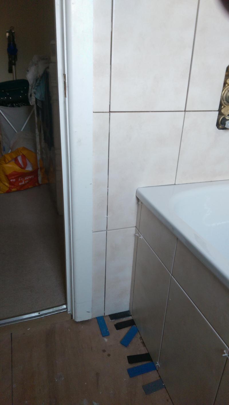

They spent the afternoon doing the bath panel which is semi-permanent, that is there are two panels with a joint down the middle which cane be removed if necessary, each secured with two screws at the base. They'll be siliconed at the perimeters.
Day 7
They seemed very confident they'd be finished today but I knew they wouldn't, it was clear that they'd suddenly realised their fixed fee wasn't looking quite so good now (bearing in mind that they said all along before they started that they were confident of having it all done within 5 days. According to my wife they worked like troopers, the radio wasn't blaring they weren't standing around chatting or singing to the radio etc.

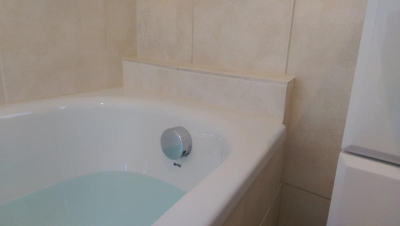

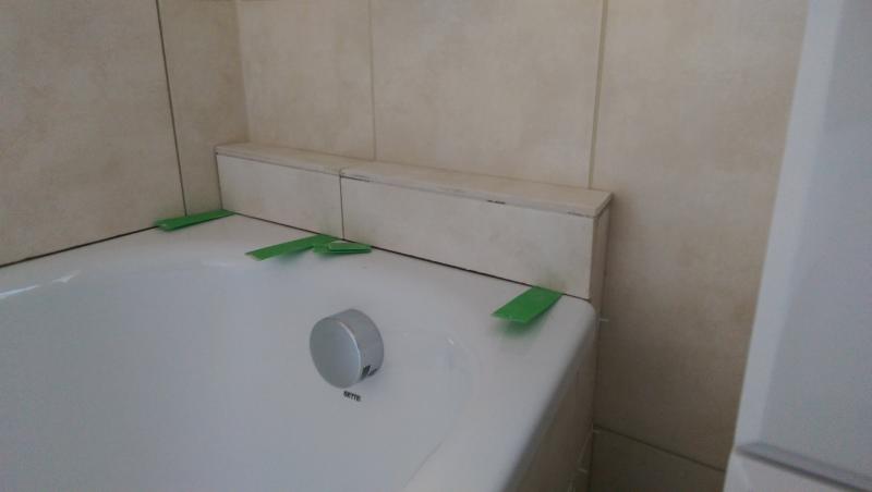

Shelf at end of bath now tiled
Bath panel tiled
Tiles to end of bath finished

OK after about four days it seems that the mixer tap that feeds both the bath and the shower is restricting the temperature, it gets hot enough for a shower and for the kids baths but not hot enough for an adult bath or a really hot shower so they are coming back to have a look. Its odd because it worked fine for those first few days and really there's not much to a mixer valve so maybe it'll be the cartridge though again it's odd it worked ok initially.
Of course I'm well aware that because I supplied the valve they will likely be reluctant to get too involved if it turns out to be faulty. Anyway I will update once they've been round to have a look.
