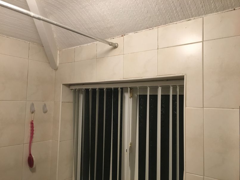

Looking at a bathroom install. We currently have no ventilation system and I wonder whether this has caused/contributed to our ceiling (like a vinyl wallpaper) staining a strange colour. Also in the hallway outside the ceiling paper was getting black spots of mould until we put bathroom paint on there.
We often Karcher vac the walls down after we've finished in the shower but we wonder whether it would be just better to get a ventilation system installed when doing the bathroom.
Our concerns are based on memories from many moons ago - houses with noisy flappy vents letting all the cold in. I'm sure the vent systems must've come on some in the past 20 years though.
I don't think anyone can get in to the space above the bathroom as i'm sure the loft doesn't reach out that far.
Also the ceiling is not a high one so we can't really lower it any. The potential installer was talking about making the ceiling flat by lowering it (currently curved) with plastic panels - but i don't want a plastic ceiling for starters and i'd prefer the ceiling to not be lowered.
Which i imagine leaves the window/wall (can't remember whether my gran had hers in her window or wall but this was over 20 years ago).

Yes, the iCon fans are good, but go for the more expensive iCon 30 - it's both quieter than the iCon 15, and also has a higher extraction rate. They aren't the absolute quietest on the market, but they do give excellent performance for very low noise, and can be set up to work on humidity control as well if required. TLC are excellent suppliers who have everything you need at reasonable prices. Alternatively if you want something even quieter (but with reduced performance) there's the Xpelair Contour range, which are much quieter but do have lower extraction rates

I got a vent axia from screwfix and it’s almost silent. Look for the lowest decibel rating, a few lower than most makes a big difference in a quiet bathroom. We can see the steam flying out the vent when it’s cold outside.
Although some will disagree, my opinion is that room temperature is just as important as ventilation in preventing condensation. If you have a central heating radiator in your bathroom then increasing the size or just swopping a single for a double is much easier & cheaper than providing mechanical ventilation.
