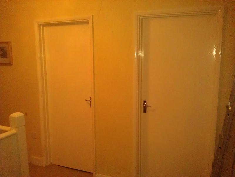

Next job is to remove the toilet door and frame and block the door up.

Right hand side door to be blocked up

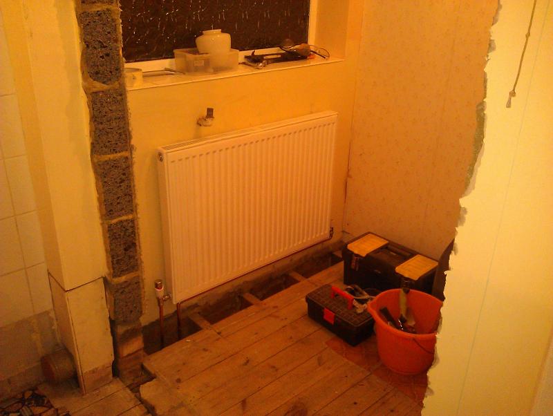

Removed wall between bathroom and toilet - this was stich drilled / chiselled after the following website put me off using a cutting disk - warning - case 3 pic looks grim http://www.head-face-med.com/content/4/1/1

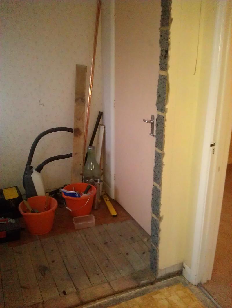

Door to be blocked up. New shower enclosure to be installed in the corner where the buckets are - the blocked up door will be the wall with the shower valve and pipework in it with a tiled finish).
Will put an approx 15cm plasterboarded top frame to cover the ceiling hole and to complete the framed opening between bath and shower areas

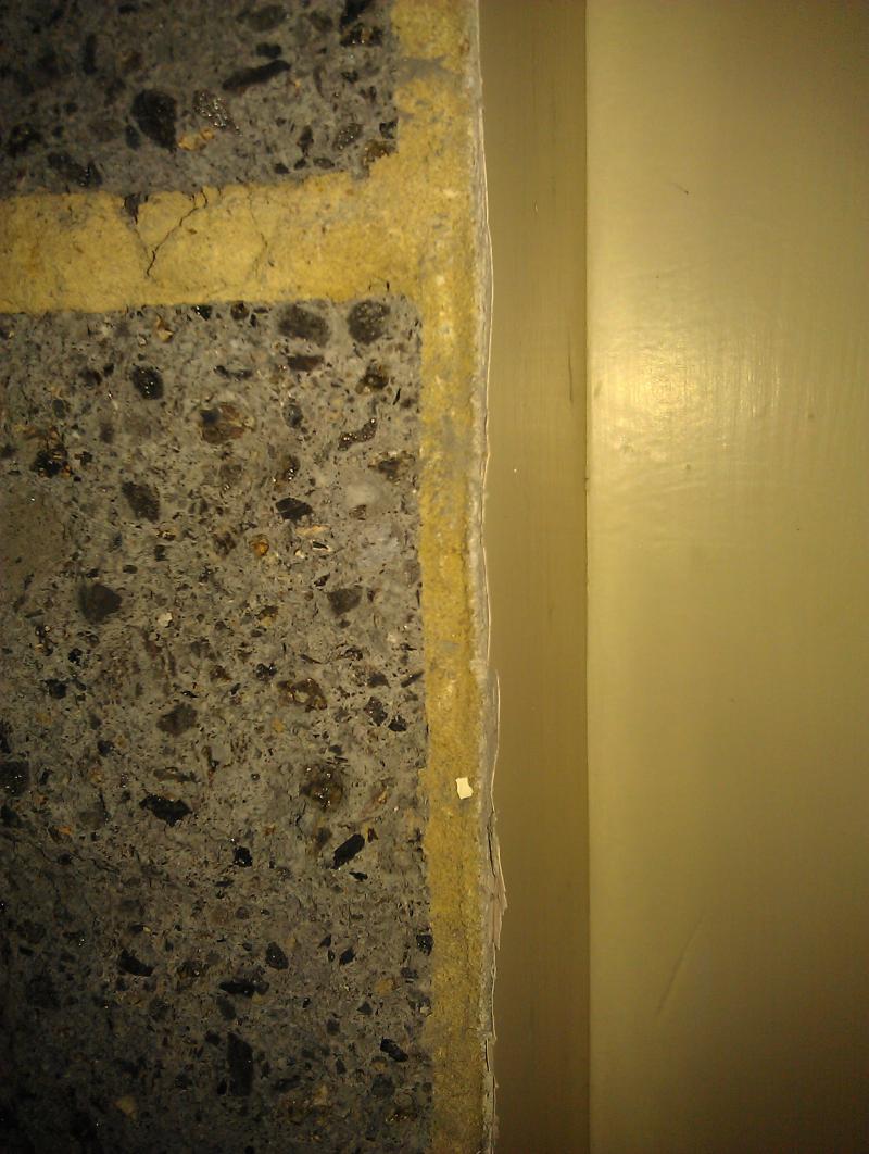

Blockwork, render and plaster finish to small section of remaining wall between bath area and new shower area
Much as I love my SDS I dont want to go at the small area of wall between the bathroom and toilet doors too hard to remove the render/plaster - the wall is load bearing. Am I therefore better off going for option 3 which Richard listed and hoping I get lucky and avoid cracks ? From the shower side I would probably aim to borad the whole of the wall including over the existing plaster to minimise any risk of cracking on that side.
