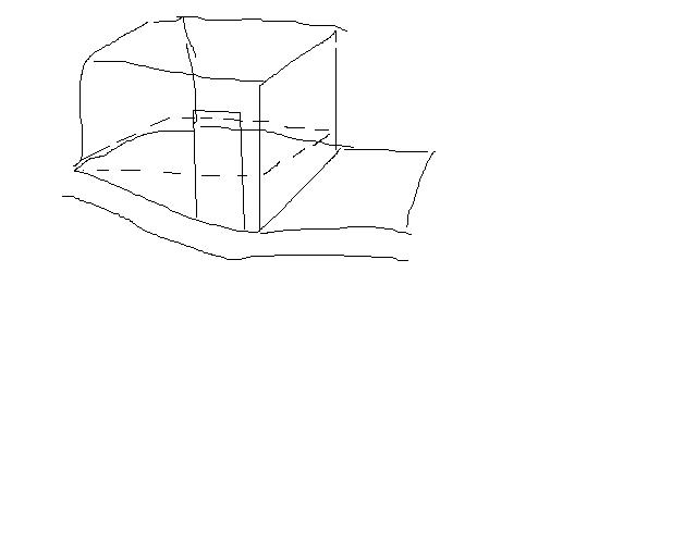

Seem to have encountered a rather substanial problem.
The floor slopes not only side to side but also front to back.
From the high point in the bottom left corner it drops by about 5cm over 1.6m. I have thought about levelling it but it would then mean a large tapered step into the hallway.

rip your floorboards up, run a spirit level over the joists, pack them with ply to level them up if necessary, then replace floorboards with 22 -25mm wbp ply, nice level floor to tile onto, jobs a good un
But what do I then do about the step into the hallway?
Do I level that up as well?
Part of the problem is the stud wall into the bathroom runs across all the joists and one of the floorboards.
How big is this step going to be?
You can get angled/ramped trims to overcome this. Also you can raise the carpet a little in front of the "step".
If your talking about a step of around 20mm trust me once you put a ramped trim in and lifted the carpet in front of it a little you won't notice it.

if you are just replacing the floorboards with 22-25mm ply its just like tiling straight onto your floor, only the height of adhesive and tile to contend with, not a step as such
But if I'm levelling the floor won't the ply will still end up being 5cm higher than the hallway as a starting level before tiles etc are added?
I must be reading your posts wrong mate, I thought you said floor was all over ( sloping here there and everywhere )
Have you checked the joists to see if they are already packed out ?, 5 cm Is a big difference across such a small area, are you sure your measurements are correct?
Excuse the crudeness of the drawing - I've over exaggerated the slop for clarity. Basically what's happened is I think the previous owner put up a stud wall (rhs of the bathroom) and that has pushed down the floor (it is a Victorian house so i'm not expecting things to be level anyway).
I ran a self-levelling around the room and there is definitely a drop of 5cm.
Currently there is no packing on the joists.
So assuming bottom left of the bathroom is the high point the bottom right is the lower point (approx 5.5cm lower). Top right corner is about 5cm lower.
The hallway outside the door follows the slope of the bathroom. The bedroom to the right of the bathroom slopes down from right to left i.e. into the stud wall between the two rooms.
