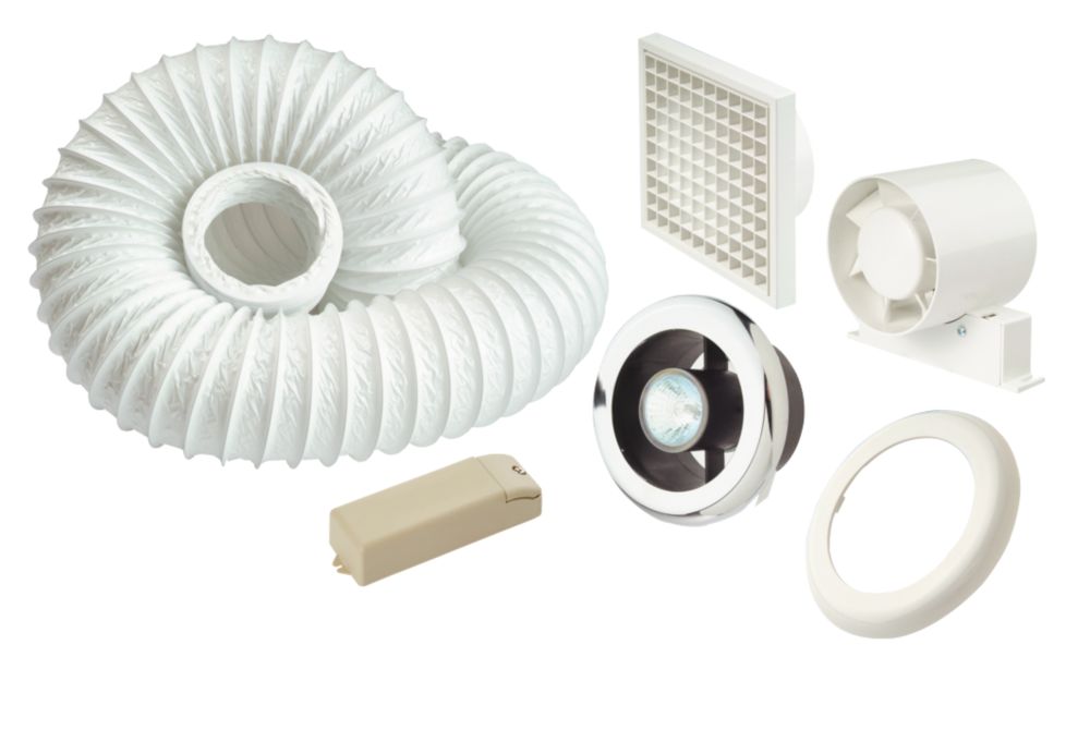

Cheap rubbish
ae235
https://www.screwfix.com/p/manrose-shower-light-extractor-fan-kit-chrome-100mm/25652
  • extraction Rate 85m³/hr
  • Noise Level 41dBA at 3m
  • Adjustable Timer: Max. 20min

Observe that the cheap one is not only noisier, it has about one-third the power of the good one.
