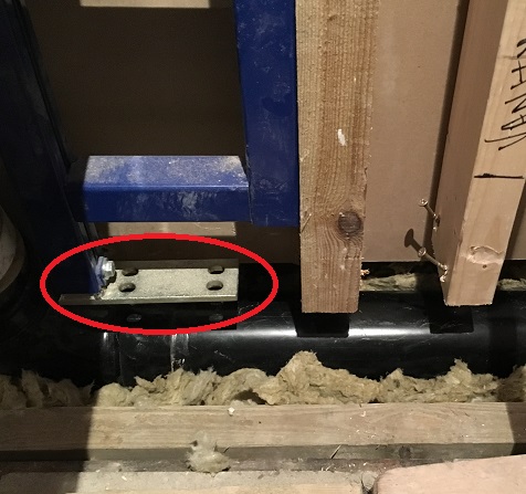

that wall hung wc frame is shocking, when it's on that toilet is going to need to be able to support the weight of a full grown person, therefore the base needs to be secured to the floor structure, also using a flexi connector in a concealed location is never a good idea.

As mentioned the toilet support is not fitted properly, one foot of the frame appears to be floating in mid air. The forces on the frames are vertical AND horizontal so all fixings need to be secured to rigid structures.

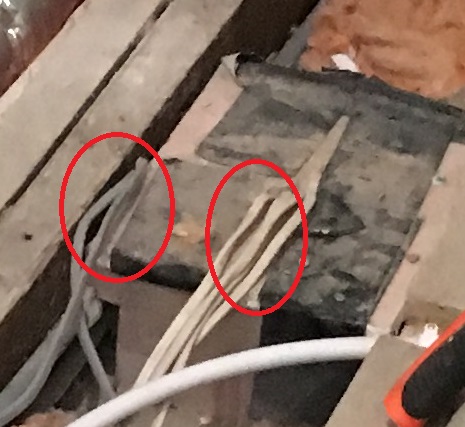

There are electric cables which appear to be in danger of crush damage
To be fair, the toilet mount is going to be fixed: we are sliding a few small pieces of solid floorboards underneath, between the two joist and then add the timber between the floorboards and the timber stud. It was cut off in order to install the new soil pipe, but he's going to fix it. The flexi connection is only temporary for the old toilet. The new one will have a rigid fitting (supplied with the geberit frame).

1) The wall on which the frame is mounted is unsound - there is no support to the studs as the floor plate has been cut out and, due to the soil pipe position, cannot be retrofitted adequately. The structure as it is cannot support the wall hung pan.

8) The cabling needs to be protected. If the switch to the left of the pan (in the new stud wall) is live then it needs some temporary protection as you will have potentially exposed connections
That probably won't work..
Why did the manufacturers make that frame out of such substantial steel and did they provide that bracket for mounting to the floor. ?
Do you believe a few small pieces of "solid floor board" will take the strain. It is NOT only a weight pressing down but also a horizontal force that will try to slide the floor boards along the joists. It may pass a static load test with a person gently putting their full weight on the toilet. But the reality is people will sit down heavily on the seat and that kinetic energy could exert a force two or three times their weight onto the frame and its fixings. ( A steel ball can rest safely on a glass table but the same ball dropped onto the same table can shatter it due to the kinetic energy of the falling ball )

1) the top of frame is also fixed at the top to the stud wall, both sides. All together won't be enough?

8) Yep... :(
All very good points... to my questioning, the answer was that the frame is also fixed to the stud wall. (see the picture attached to newboy quote).
