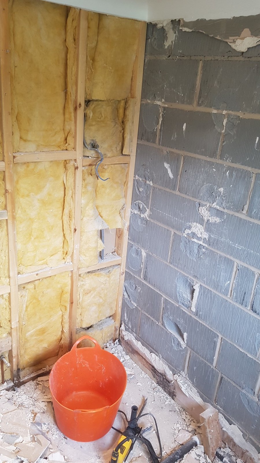

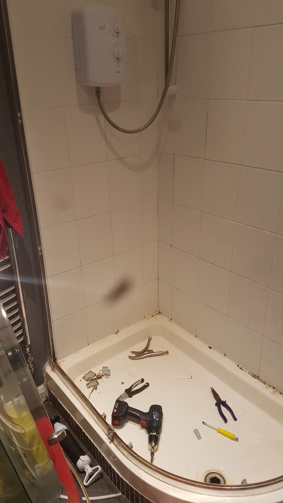

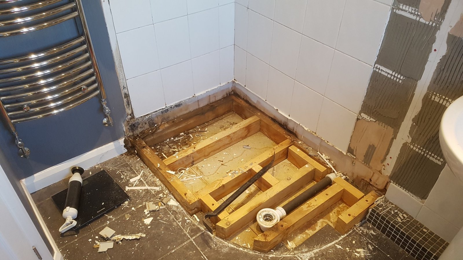

Starting off with the satisfying task of removing old fittings I cracked on with the shower.

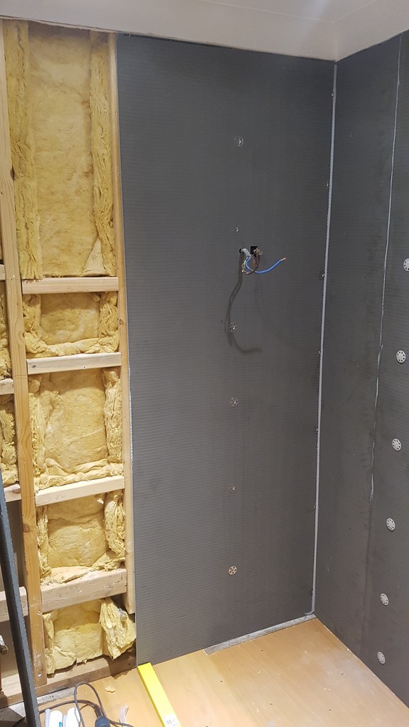

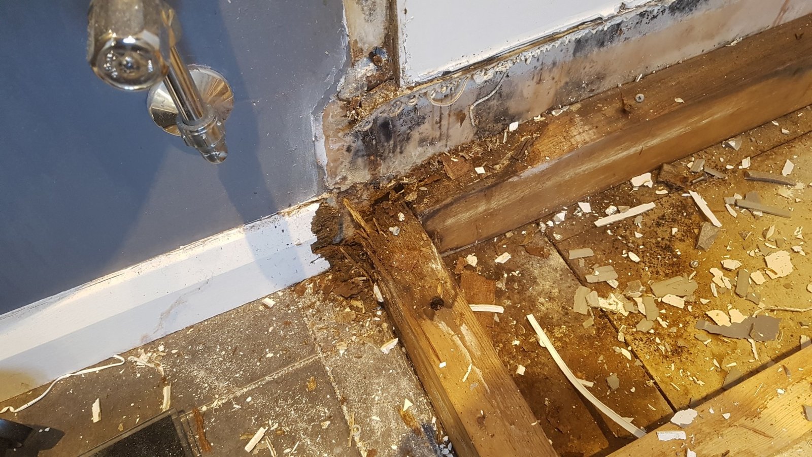

With the concrete base broken up it became obvious that the leak had damaged the wall.
This bathroom was part of an extension - with the plans drawn up as such. So why was bog standard plasterboard used on the walls??? Not even the moisture resistant one at the very least!

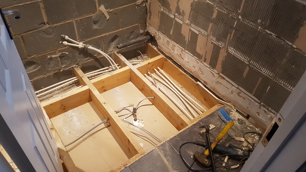

You can see the damaged stud wall here. This was cut out and replacement studs fitted. Fortunately the floor joists were fine and not affected as the t&g chipboard had taken the brunt of the leak.

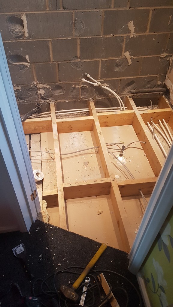

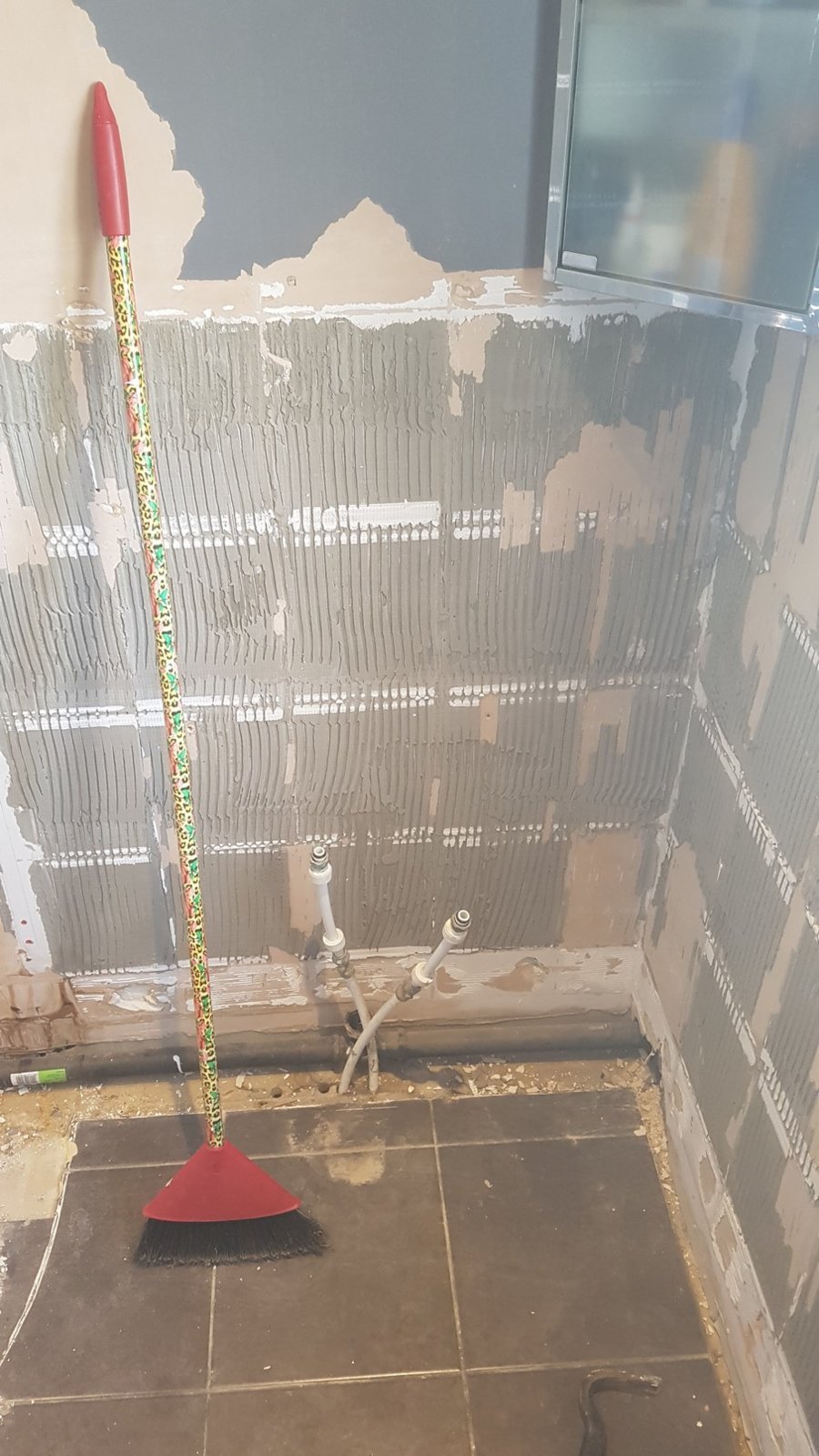

The floor was taken up as we wanted to retile everything. The walls by the door and the window were sound so only 2 walls were taken back to the substrate.
The ****e bog end was taken up and the unnecessary vent pipe blocked off.
The room now an empty shell:

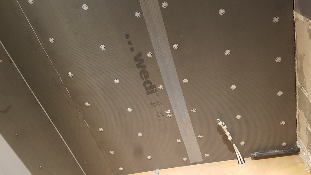

Not too many pictures at this stage but 18mm WBP ply was used for the floor. Extra noggins fitted where there were any suspended overlaps. Pipes for the rad were re-routed and the two bare walls (where the corner shower will be) had Wedi board affixed.
I used dot and dab and plastic dowels on the solid wall and screws and Wedi washers on the stud wall. Wedi 610 was used on abutting ends.

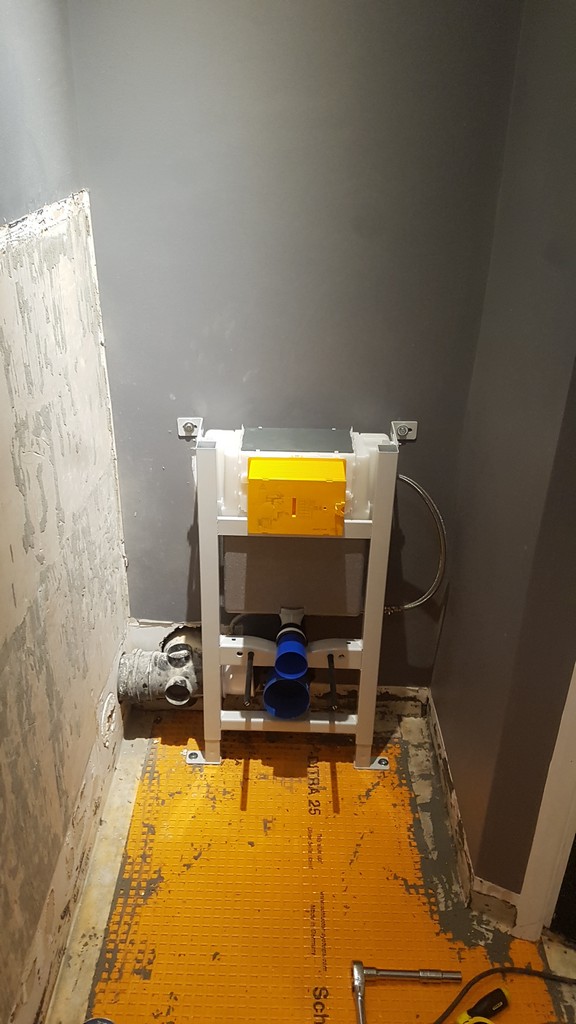

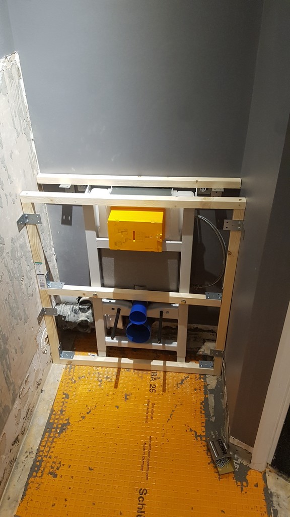

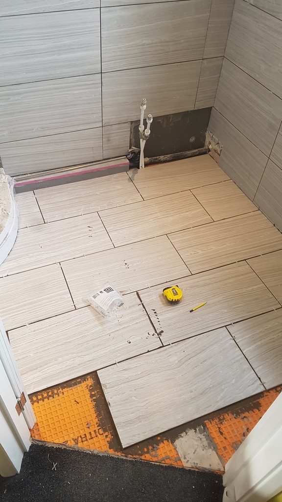

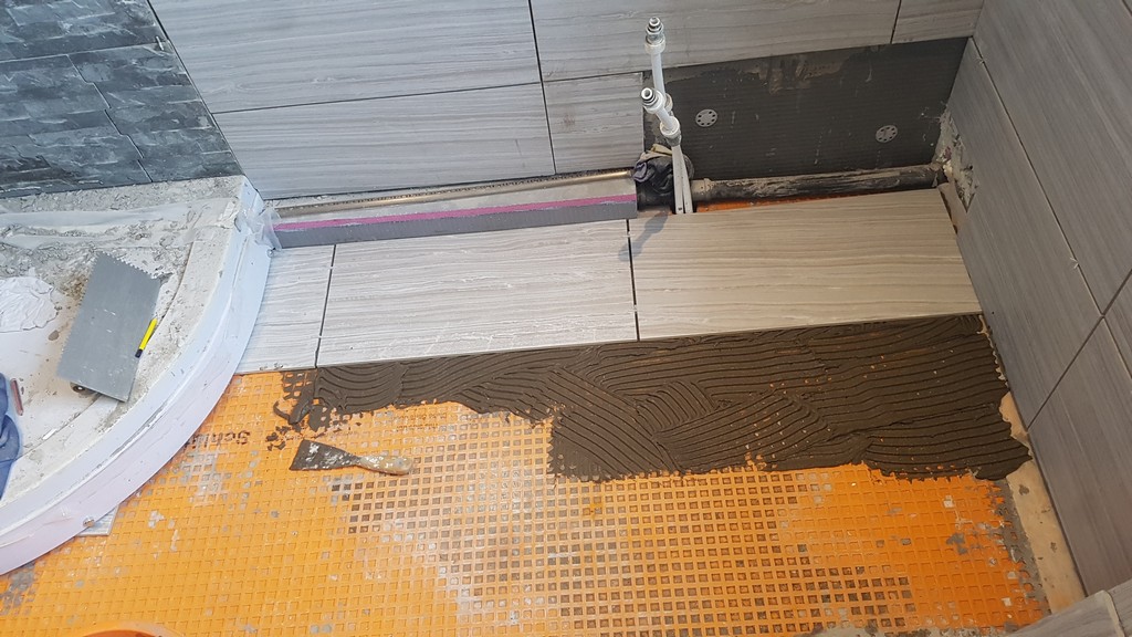

The floor was covered in Ditra matting and Kerdi band. Maybe a bit of overkill and it's only a bathroom - not a wet room. Anyway, we decided on a wall hung bog unit.
The unit had to be fitted slightly off-centre as the soil pipe got in the way. The idiots who built the extension also had the soil pipe facing the wrong way. The unit was simple to install although some of the instructions are akin to decoding hieroglyphs!
A frame was built:
And then 20mm QBoard - similar to wedi was installed.

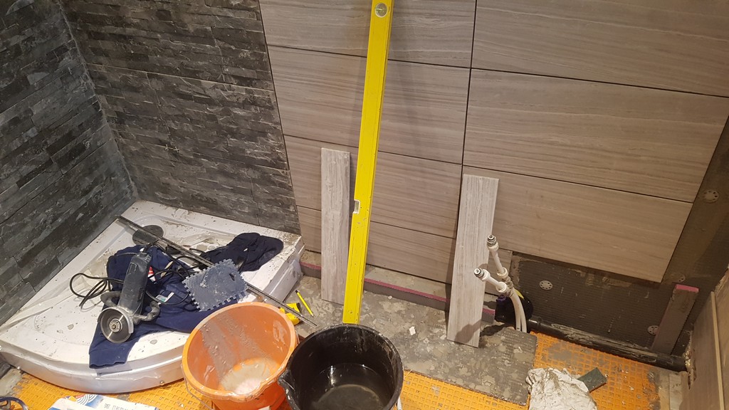

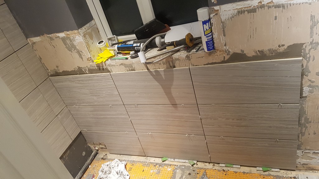

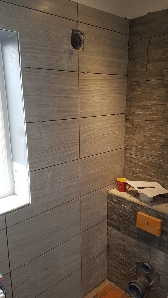

A big jump in effort and time and I got to this stage, the dark tiles are textured and as I found out later a nightmare to grout!
With it being a fairly small room and with using large tiles there were only a few that didn't need any cutting of some sort.

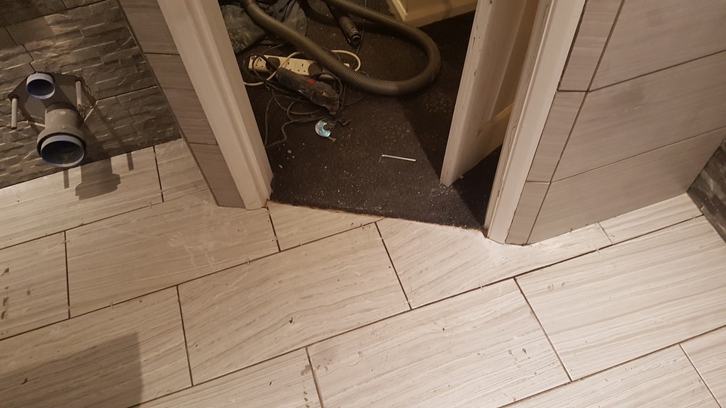

Once the walls were done I started the floor
Which progressed quite rapidly:
until the floor was finished.

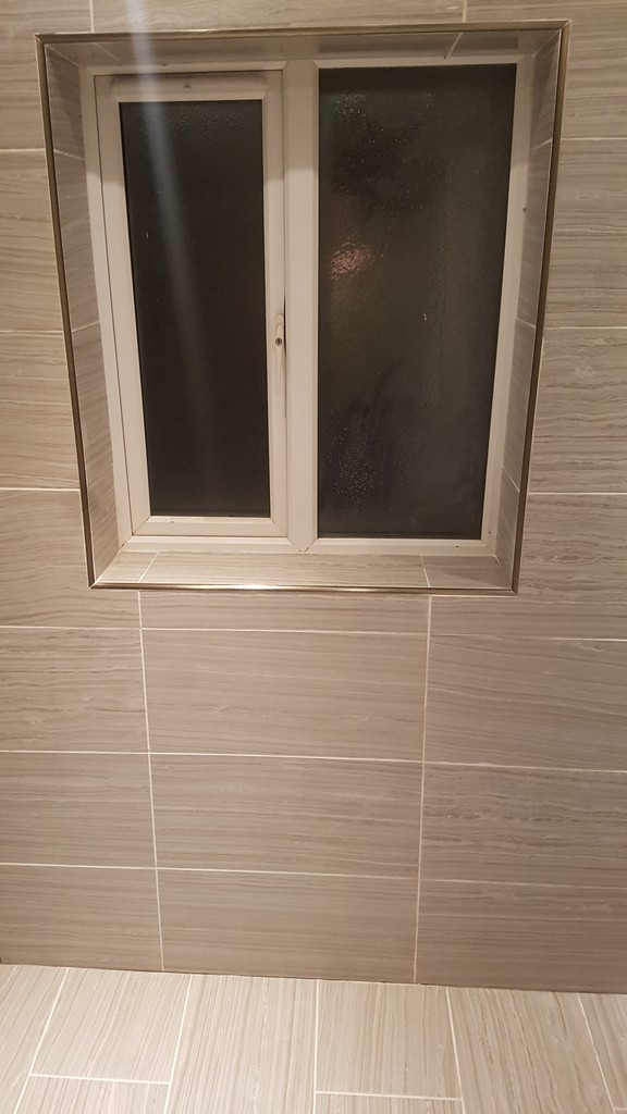

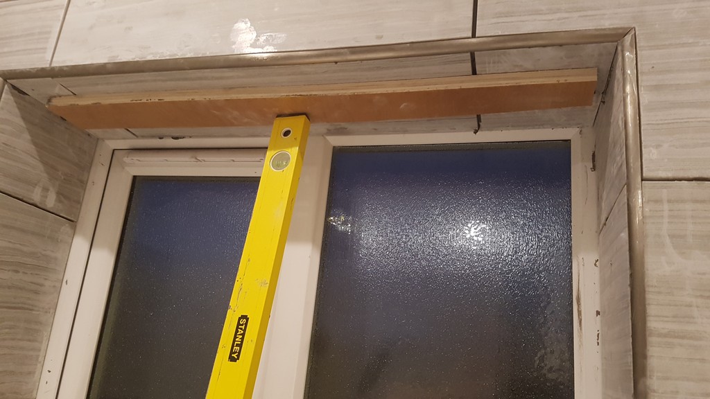

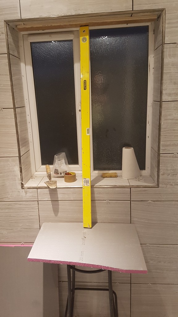

The window was done with my system for holding the tiles in place

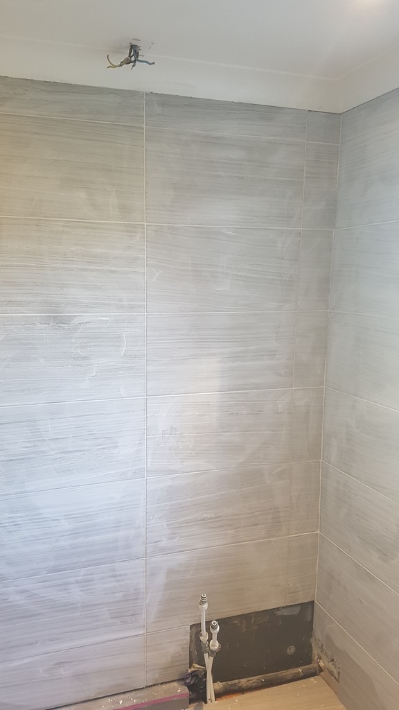

Grouting the lighter tiles was easy enough. The dark grey ones were difficult with them being textured.

I used a cement residue remover to clean the tiles, the dark tiles needing several applications to remove excess grout which wasn't always easy to spot.

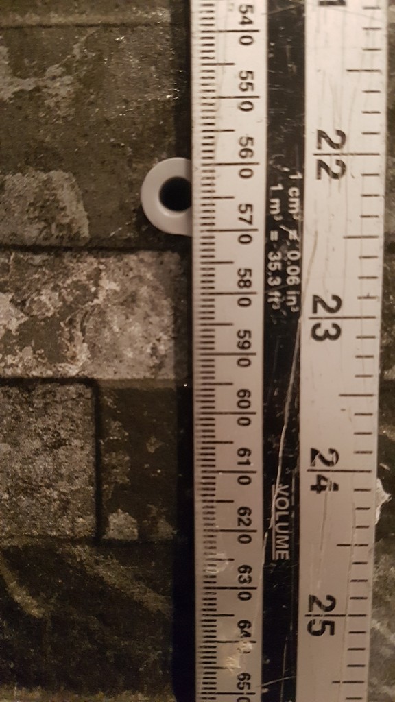

Installing a B&Q shower rail was problematic. Not with drilling the holes - by this point I was getting very good with the diamond drill bit, starting at a 45 deg angle and slowly working my way to 90 degrees. The instructions said to drill holes 567mm apart. I managed 565 mm but in the picture immediately below it's obvious that the centres are 572/3 mm apart. With barely any adjustability the rail didn't fit. B&Q gave me a £10 voucher and I did manage to get the rail installed by drilling part of the plastic housing. Poor instructions!

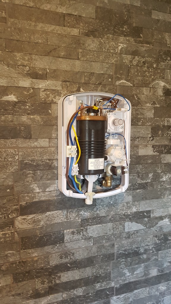

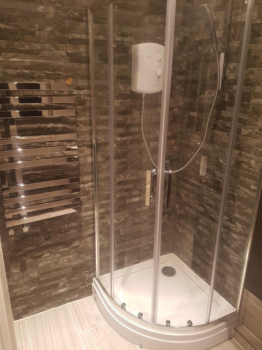

The electric shower was duly fitted

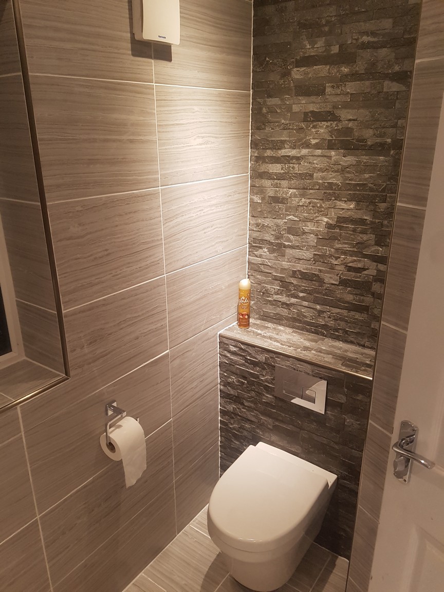

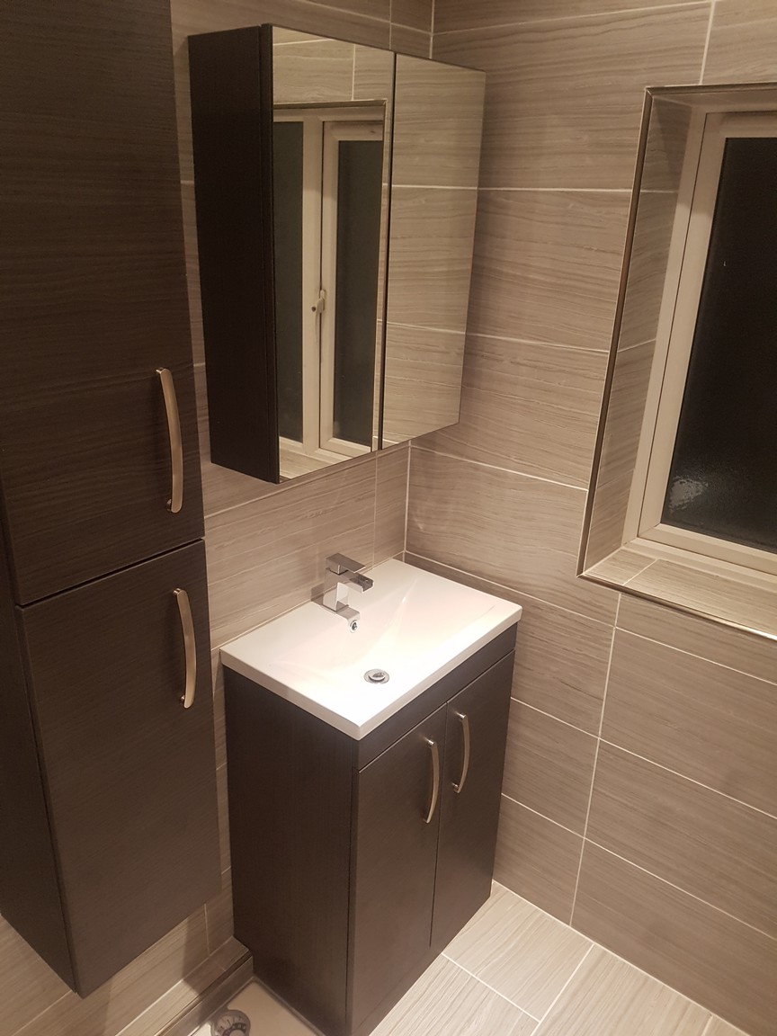

This is the final result after fitting the enclosure, wall hung units, sink unit and wall hung toilet.
Wife very happy - so happy wife = happy life :)

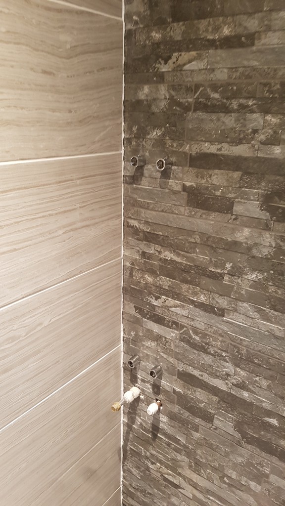

Thanks, I did have a couple of little hiccups along the way. The textured tiles although swish - are a nightmare to work with. The ends are interlocking as so will always need cutting at the edge of a wall. Grouting is a pain as the grout can't be smoothed off with a rubber float. In the end I had to enlist my daughter to help with a sponge to remove excess grout before it dried. We chose anthracite grout which of course makes it hard to see bits we missed! I'm quite good applying silicone and using those rubber profiling tools but it's very difficult with those tiles to try and get a neat edge. I had to spend a while going over it and tidying it up.
I had a problem with the toilet pan leaking, at first I thought it was the flush cone as it only leaked when flushing. Water from a bucket didn't result in a leak. The flush cone was a good rubber one though so couldn't understand where the trickle of water was coming from. Then I found it - a manufacturing fault in the actual pan about an inch downstream of where the flushcone sits in the pan. There had obviously been a hole which appeared to have been patched up poorly. I applied a liberal smear of wedi 610 on both sides of the hole and that cured the leak.
The radiator was fun to install as all 4 brackets have to be perfectly aligned otherwise the radiator won't fit - again not so easy on the textured wall, but I got there in the end. :)
