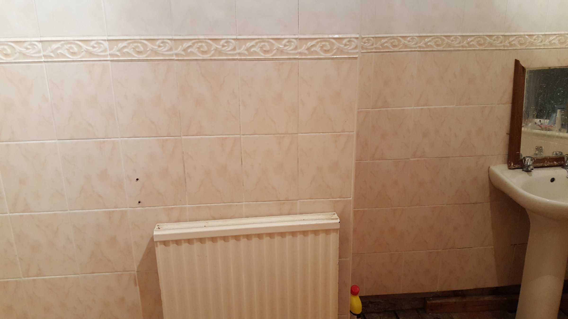

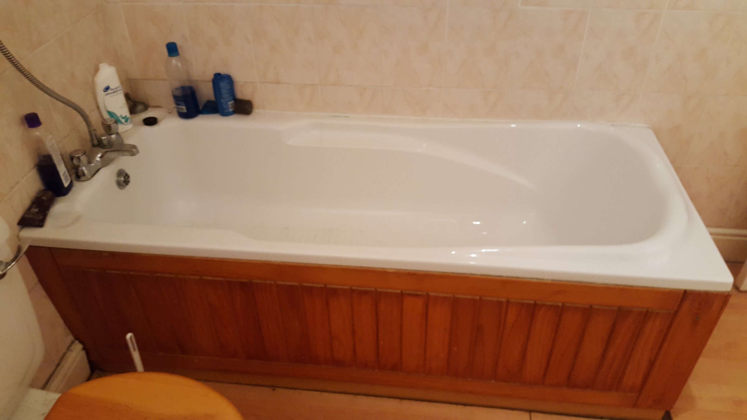

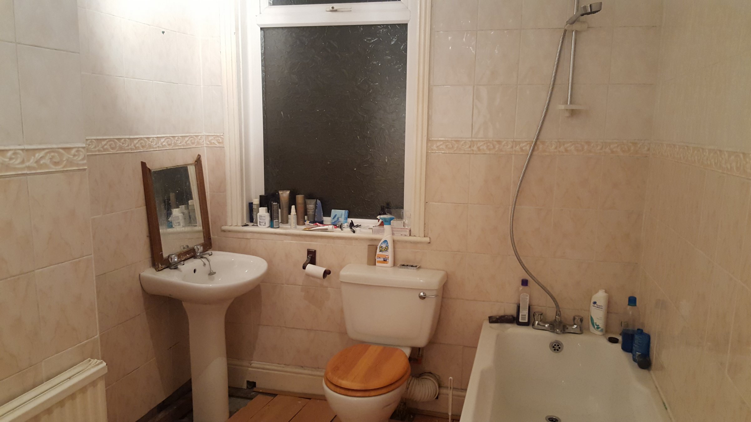

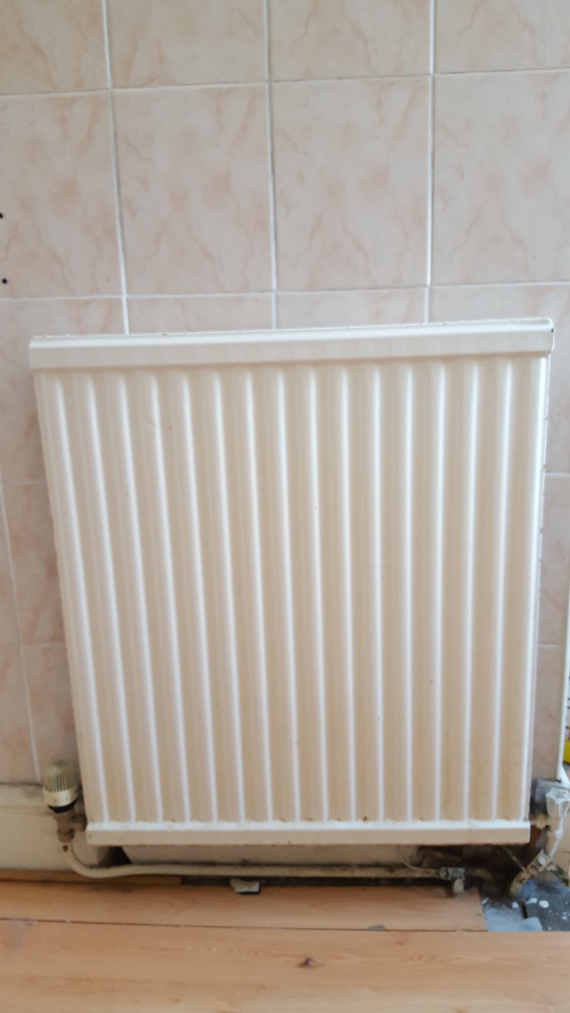

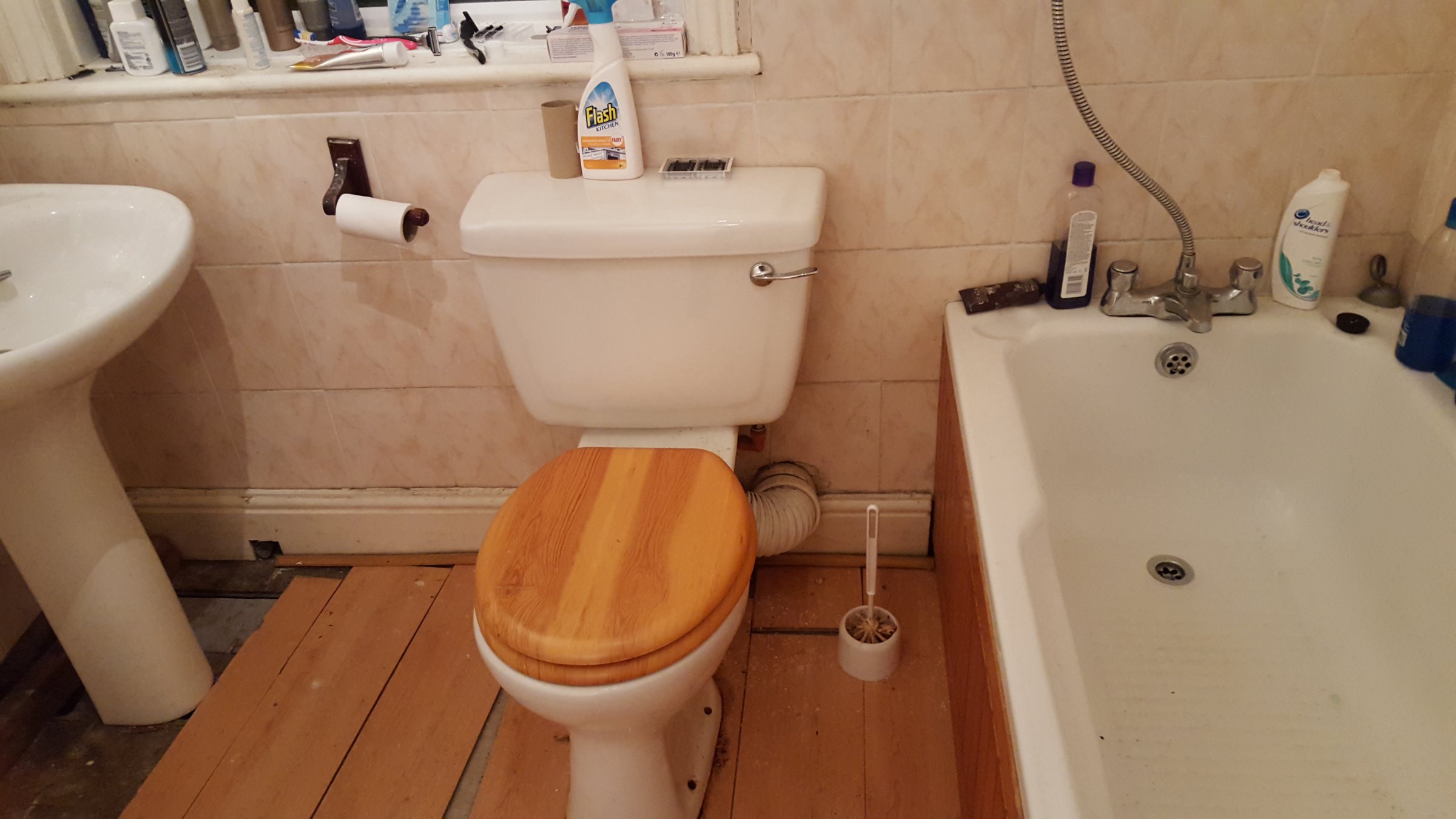

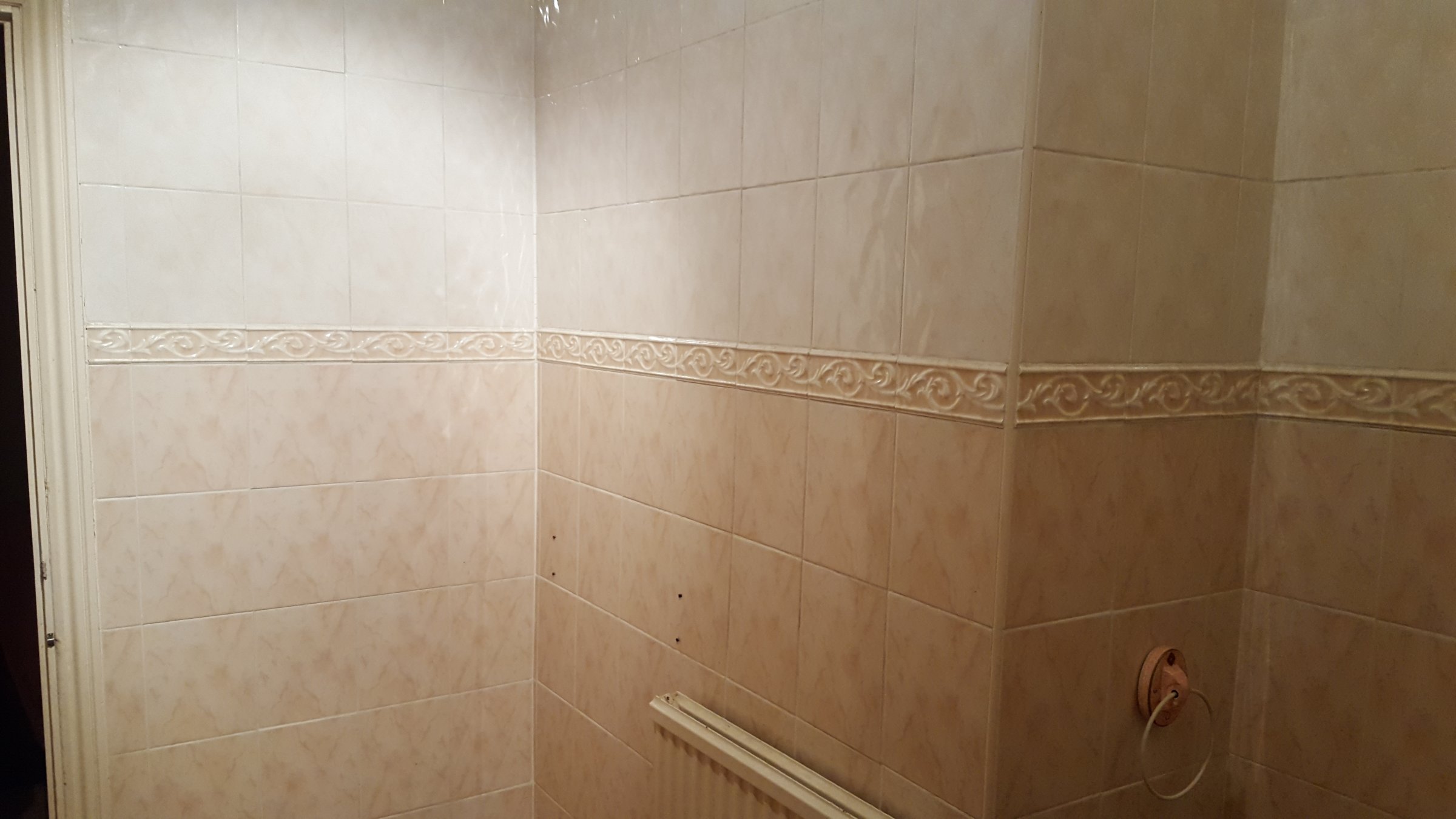

Sorry for the delay - Valentine's all all that. Here are pics of my bathroom - seems pretty easy, no?
For someone who hasn't done any DIY before, that bathroom is a whole world of disasters waiting to happen.
For the walls, what were you intending to do with the existing tiles?
Smaller, easier things should be attempted first, then you can experience just how easy/hard things really are.
Such as moving the pipes for that radiator so they both exit the floor vertically in the correct place, then fitting a towel radiator there and fixing it onto the existing tiled wall.
Or remove the toilet and the pedestal for the basin, sort out the flooring and put the pedestal and toilet back where they were.
What disasters? I was intending to hack off the existing tiles, get a guy in to replaster, and then retile. If it is such a big job then I'll be open to paying someone to do it but everyone I've talked to has said tiling is easy and to do it myself. If I pay a guy to do the bathroom then I'm doing the kitchen - just some areas between worktop and cupbaords/splashbacks etc so either way, I need to get ti grips with tiling like every guy of my dad's generation seemed to manage without hassle.
