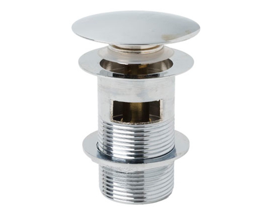

I take it you're talking about the top bit of the waste that sits in the sink? I've unscrewed the plug bit and can see two slots either side like in the photo below:
Reading around, it looks like I should be able to unscrew the spindle with pliers. Will the waste flange just unscrew or is there something else I'm supposed to do?

You need to unscrew the large nut under the basin - inside the cupboard - and shown on your picture.
