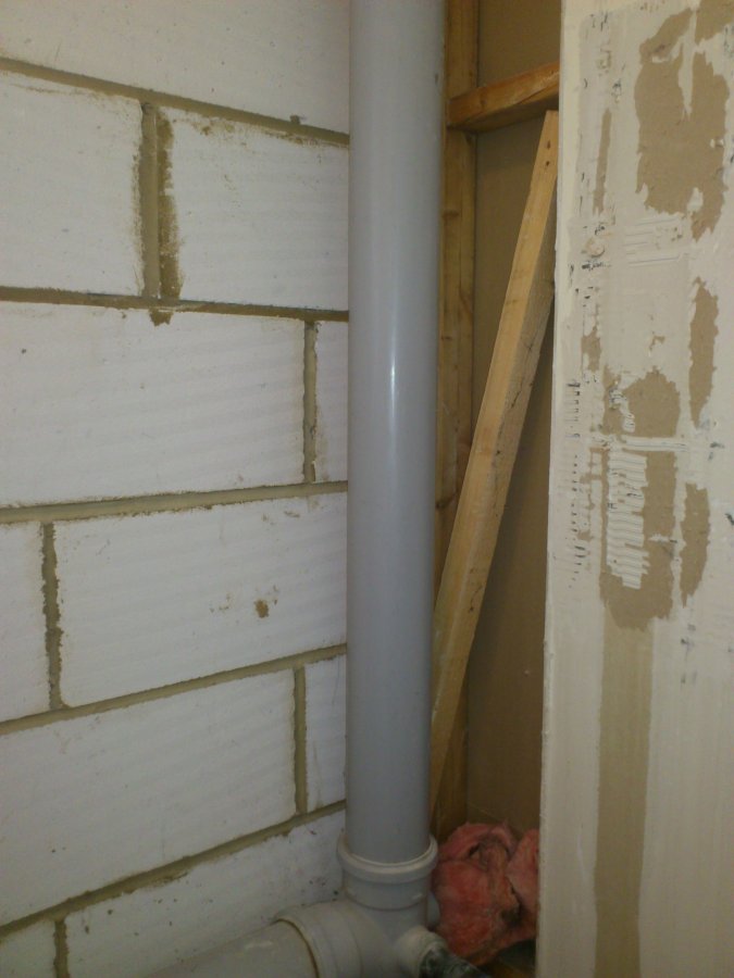

The soil pipe venting in the loft.

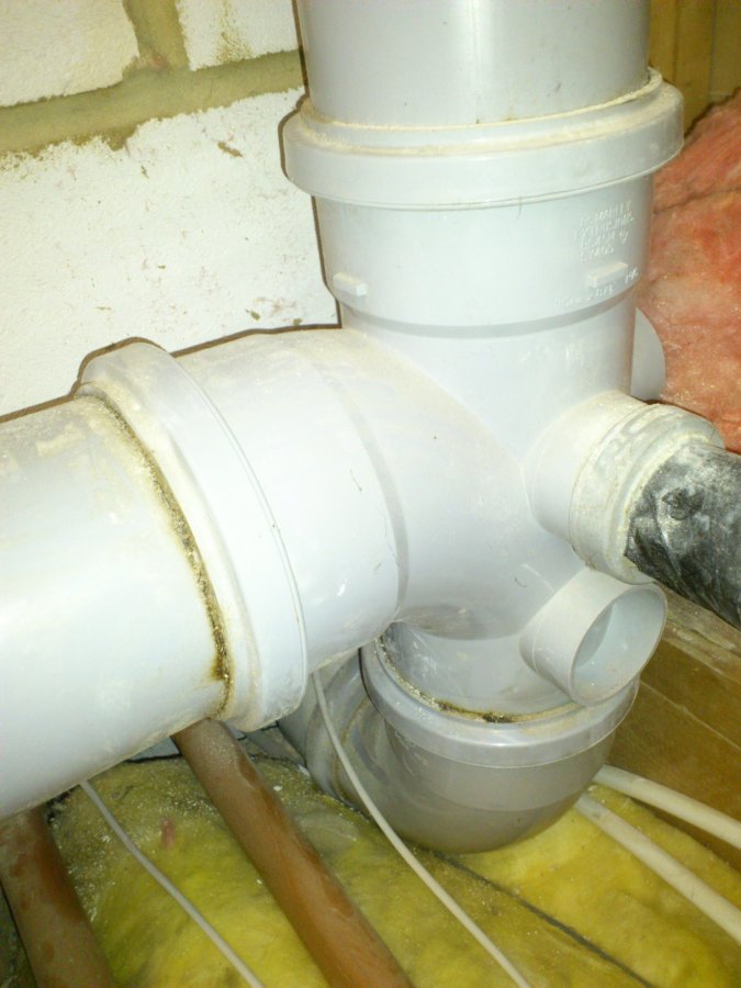

The current soil pipe connections visible above the floor. The black item is covering the old bath waste hole. The toilet waste comes in from the left.

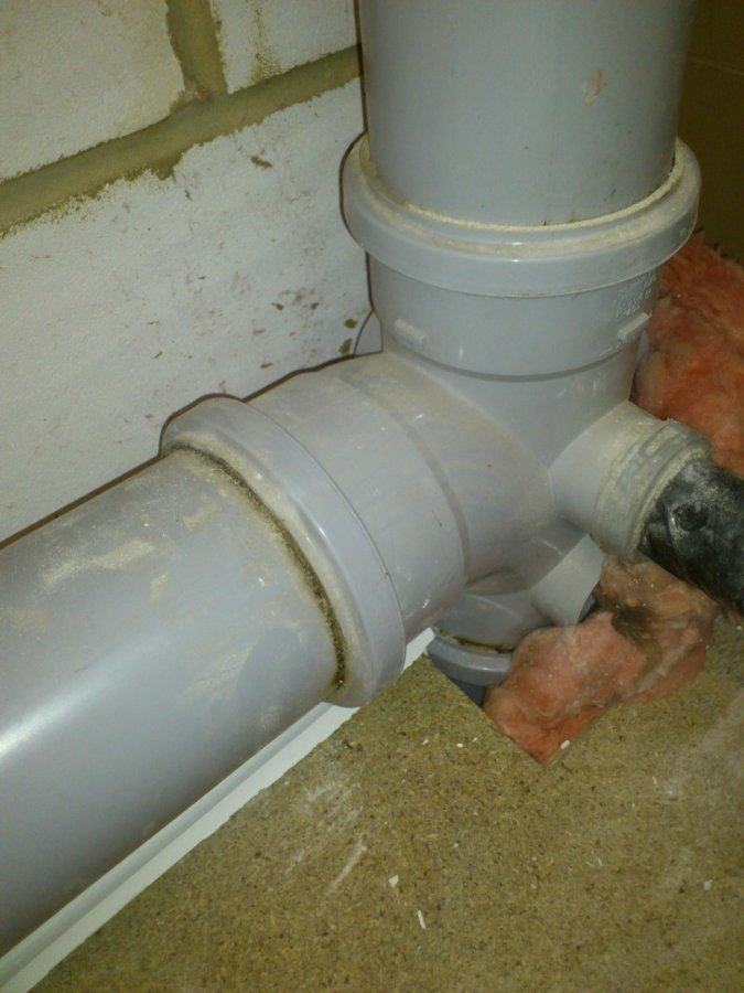

The floor removed.

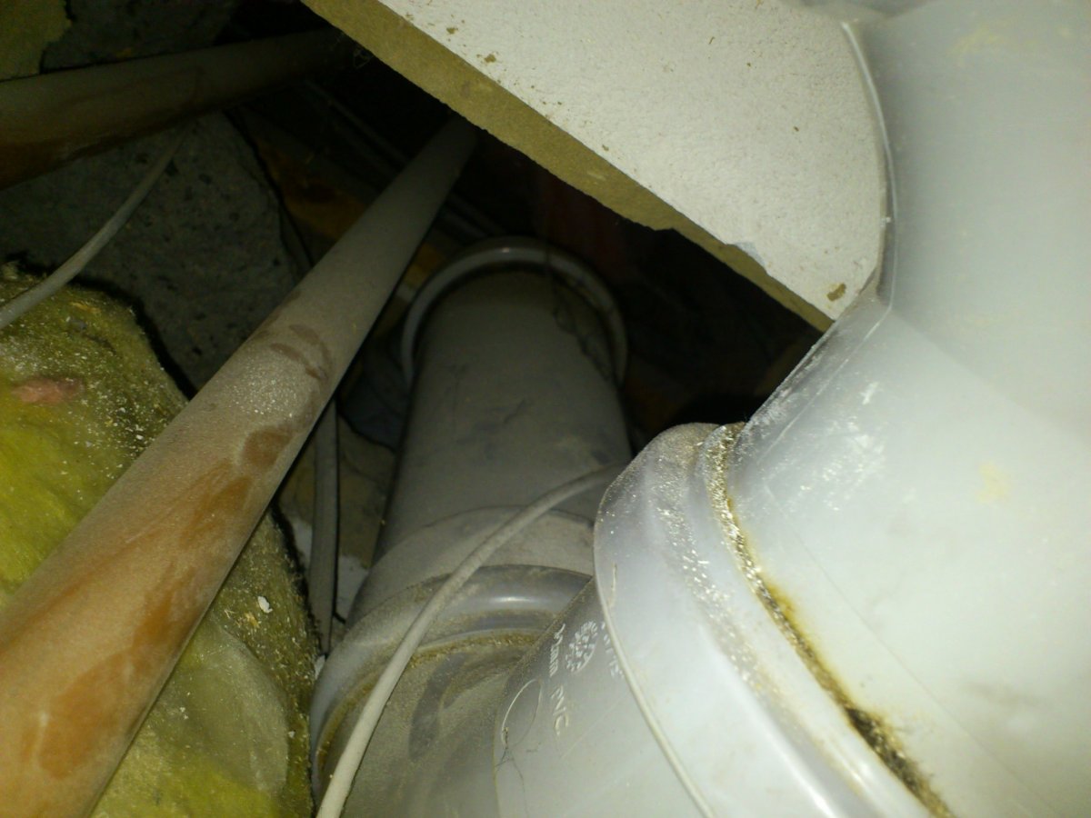

Under the floor, the soil pipe going to ground in the garage.
