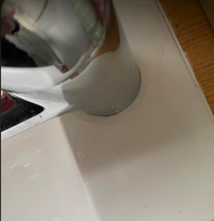

My bathroom tap is leaking where the tap fits onto the washbasin. Could this be repairable or is it a new tap? It's an Ideal Standard single mixer (and is the best tap I've ever had ):cry:
I stupidly took the photo after I'd dried it up, but it's round the base that I have puddles
taps are often repairable. A pic of the whole unit and where the dribble is coming from would tell a fuller story but its possible it just needs a new cartridge. Although mixer tap cartridges are pricier but still not as much as a full tap plus labour to refit.

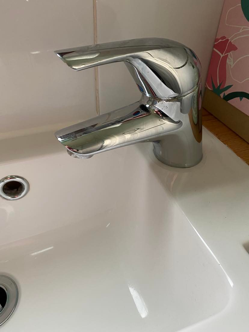

Sorry for the delay. Pic of tap attached.
The water seems to be oozing out of the base at the back. I dry it up and it just starts oozing out again immediately

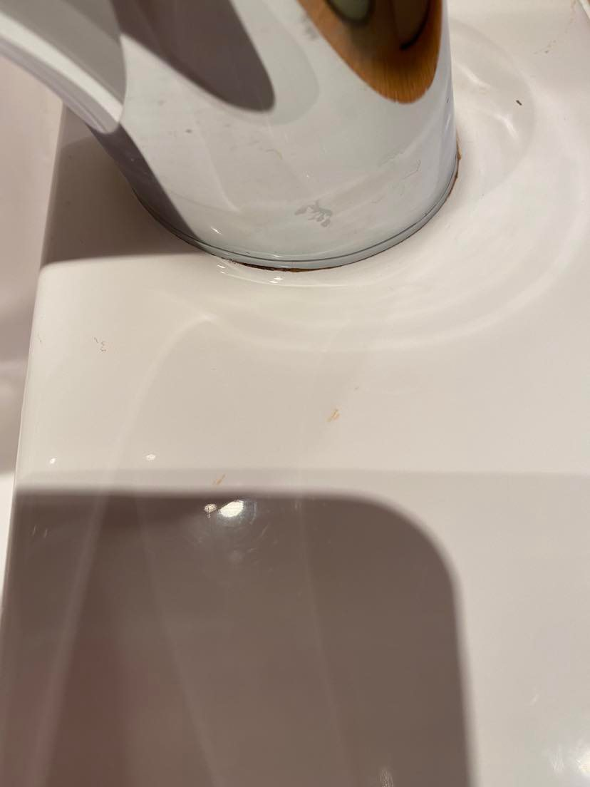

Looks like it’s the middle where it’s leaking from on one photo, in which case a new cartridge should solve your issue. Email photo to Ideal Standard, if you’re unsure of the model.
I don't think it can be, as if it was, surely the water would eventually drip onto the floor? I'll double check though. It could actually just be when I've had the tap on (never thought of that)
I dried it last night and checked this morning, and there was the same little puddle and I hadn't used the tap. It's not like it's pouring out, it's just seeping. Gonna have to get under the sink I think and get the tap off.
I do wonder if I'd be as well just replacing it - it's about 14 years old, but it's getting a good quality tap without having to sell body parts. My kitchen tap is absolute crap and doesn't mix in the slightest.

Looking at the build up of limescale under the lever, yeah, I think you need a new cartridge.
Waiting on a new tap coming into Toolstation. I thought that was the chrome coming off - I think I need specs lol
Of course, once I got in at the back of the cupboard, I discovered there's no isolation valves - not sure why I expected them cos the guy that did the bathroom originally hasn't put them anywhere.
