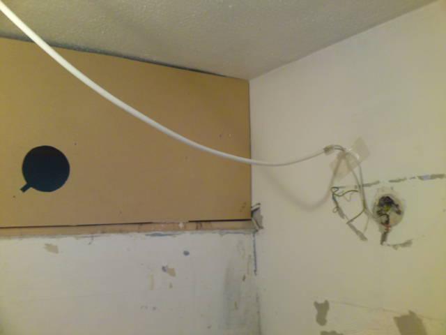

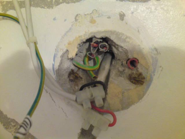

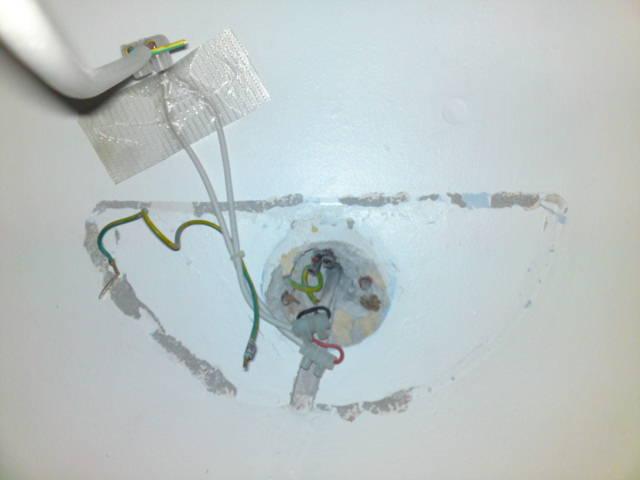

We really need some photos. BAS, if its looped in looped out at the switch the neutral could be there. If you show us a photo of the wiring inside the light we can advise better. You need to take the permanent live switched live and neutral all from the same circuit via a three pole isolator located outside the bathroom.

Pictures as requested.
Behind the boxed in area I have two power feeds. 1 from the old light fitting and the other one is from the removed bathroom light and heater.

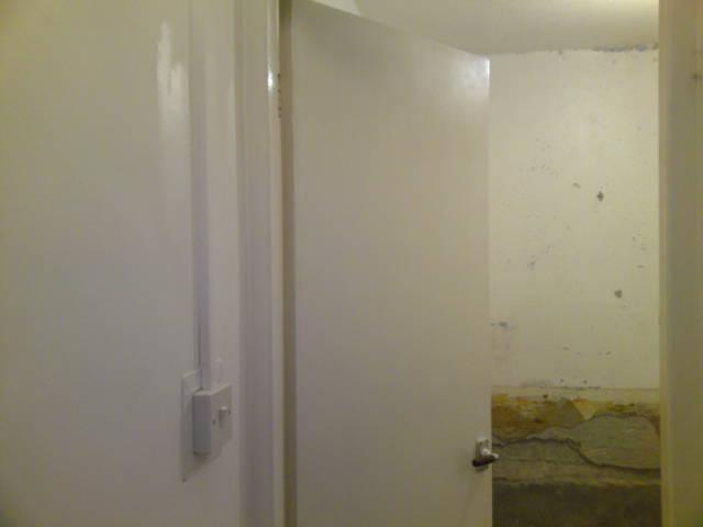

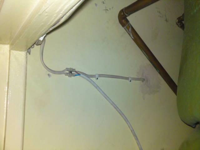

so you have a trunking in from the switch?
then it's a simple matter of swapping the existing T+E from the switch to the light with a 3C+E..
as it's fed from the rear of the airing cupboad and wall mounted then it's a really simple job that you seem to be making over complicated..
