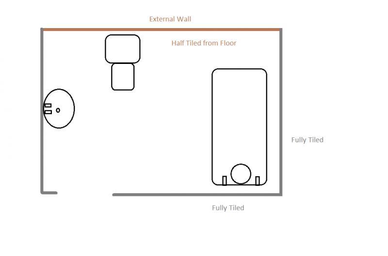

Oh dear I ma sorry looks like I have totally confused the whole issue!
Maybe a diagram would help?
I would thermaline the exterior wall as its single block, maybe get it plastered and tile from floor to mid point using small tiles?
I would then build three stud walls using Aquapanel or Hardibaker and tile from floor to ceiling
The bath with shower over would be in the corner so maybe extra tanking needed there?
OK that’s’ now clear; problem is that although Thermaline Plus (which I assume is what your using) has an integral vapour barrier, the internal face isn’t moisture resistant & you should really be using MR board in a bathroom! I have used standard wallboard rather than MR in bathrooms in the past but no longer do it & if you plaster it will reduce your max tile weight. With the MR board I now always use in “dry” areas on ½ tiled walls I mark the tile line, skim down to this & waste the skim into the area immediately below the tile line, tile away & you’re then left with a nice plaster finish above the tiles. You should also mechanically fix the Thermaline Plus, don’t just rely on dot & dab.
You only really need to use tile backer board in wet areas, MR plasterboard is fine in all other areas & you can tile directly over as long as your tile weight don’t exceed 32 kg/sqm; but, as I said, if your ½ tiling any areas & want to plaster above you must prime before plastering but if your getting someone in, any “proper” plasterer should know that.
You can tank if you want additional piece of mind but IMO it’s not necessary & I wouldn’t; a wet room is another mater. If you use a backer board on the back wall behind the bath & at the back end where the shower will be, taking it slightly beyond the shower screen (300mm), it will be more than adequate; then use MR PB everywhere else. Again mark the tile line & plaster any non tile areas before you tile but remember what I said about not all backer boards accepting Gypsum plaster; well they will but the manufacturer doesn’t recommend it & you have to do extra prep!
I was thinking of fixing MR plasterboard ontop of the Thermaline? My thinking was as its single block external wall this would aid the thermal property of the wall and not have 'cold' walls?
Understood, I would use MR throughout for internal studs walls and soundbloc on the outside, I was thinking of using tile backer board in the corner where the shower/bath is?
Thanks again :)
You can I suppose but I doubt you’ll get cold walls with the Thermaline; I’m just concerned about multi layers & how this will affect support when tilling; as I said you must ,mechanically fix, don’t just rely on Dot & Dab.
To meet the minimum sound insulation requirements the boards must have a minimum mass of 10kg/m2 on BOTH sides of the wall; where your new walls require sound insulation, use either Soundblock or Wallboard 10 on the outside & MR Soundblock on the inside of the bathroom. I would use tile backer board on the whole wall behind the length of the bath & on the adjacent wall, taking it around 300mm beyond the shower screen.
