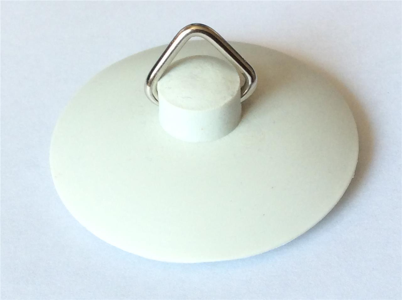

You could leave as is and just buy a traditional plug ,that you fit and remove by hand.
Thanks, I'll get a traditional plug and somehow put the chain around the knob. Would a rubber one be good enough? Or could I get a metal one as long as the size is the same as the old one? Not very stylish but that's all I can do. Will be looking for a plug saying 'don't waste water'.

I had a similar fault and found that the hole for the pop up plug is not the same size as for an ordinary bathplug.
I am using a rubber mushroom.
I think I will never buy another pop-up.
:ROFLMAO: how do you take it out?
It has a metal loop in the top.
Ok thanks, I might add the chain, to make it easier to pull out.

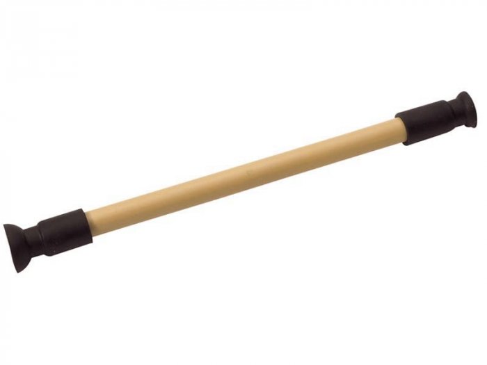

When I had trouble with ours, my 'temporary' fix to remove the pop up plug was to use a valve grinding stick. I got 6 months out of it before I got round to replacing it.
As I very often put off solving problems, I will try and use the non-perfect solution of a rubber plug, hoping it can be a final one (at least in the life of my bath). Thanks anyway.
