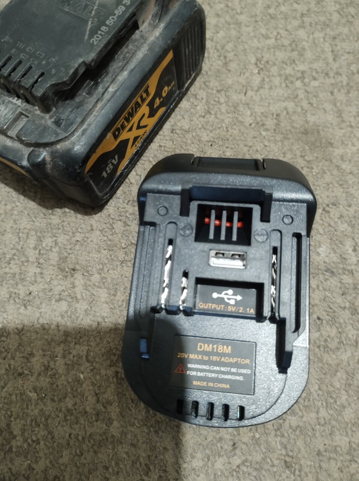

This is the underside of a Makita to Ryobi adapter. You can see it only has the positive and negative pins. ...
But, if you look under a Makita tool, you'll see extra pins which do the current sensing/temperature monitoring/etc...
What I don't know however, is whether the battery itself would cut the power when over-discharged, or whether it's the tool that monitors that. That's probably brand specific.
Charging the batteries will be as normal of course, the charger monitors the current, voltage and temperature of the battery.

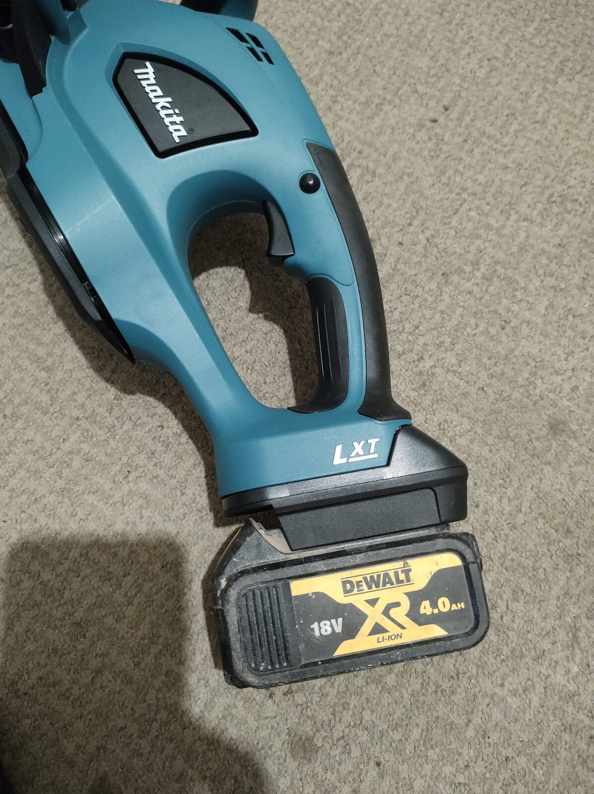

It's arrived. Battery adaptor seems to work ok:
and has a handy usb output:

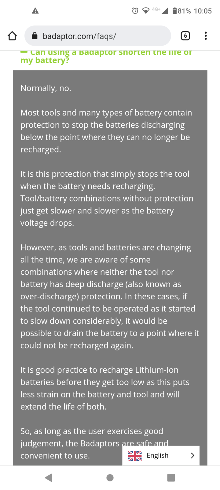

I found this info which suggests they are ok if used with care - should be obvious with a hedge trimmer so I'm going to sell on the Makita battery/charger set, and I've submitted my radio claim.

I've only user it once but it worked perfectly. I kept checking the battery level with the little button and there were still two out of three LEDs lit up when I'd finished so I didn't find out what would happen with the battery protection.
