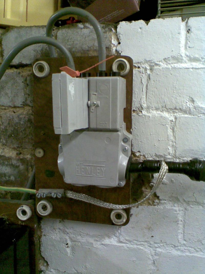

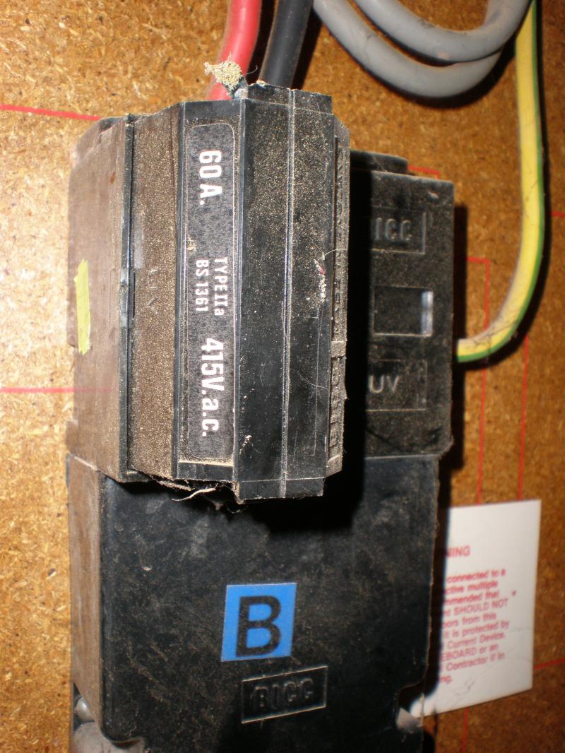

p.s.
A main fuse is usually 60 to 100 Amps, adjacent to the meter, and inside a black or grey plastic enclosure like
or
