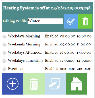

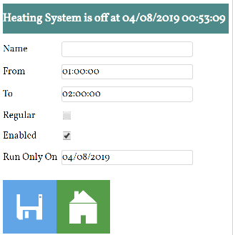

In the end, I made my own timer, with a Raspberry Pi 3 and a photo-optically isolated relay board, and a schmitt gate to pull the pins low (off) if the Pi lost power. I installed a lightweight web server called Jetty, and wrote some java servlets to enable me to define "profiles" (groups of programmes e.g. Autumn, Warm Winter, Cold Winter etc), programmes (which can repeat on multiple days or just be for a one off date), the ability to switch on for the next x minutes (5,10,15,30,60,120 etc) or ensure that it stays off for the same.
It works really well, and being web-based means that I can access it from my phone or any other computer in my house (if outside the house, I use a VPN to access it securely). I had plans to get it to operate a wifi or mesh connected radiator value, but I haven't found any that are not using a proprietary protocol, and to be honest the only time I need that is infrequently when I want to switch a zone on or off entirely.
