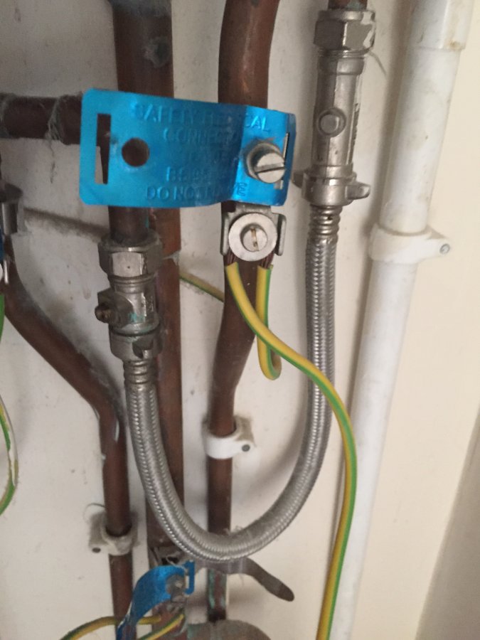

Hi
Our boiler has low pressure. Am trying to increase the pressure but cannot work out how to release the valve on the filling loop as there is no handle.
Hopefully a picture is attached.
I presume I need a tool?
Thanks for any advice.
The handle is missing but a pair of pliers or similar should do the trick (on the left hand valve).
Just used pliers which worked. Thanks very much!
