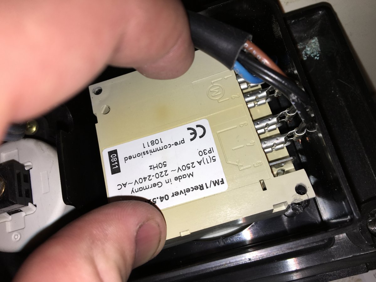

Hi,
I've got the above boiler but the transmitter started going faulty and not turning on properly. Turns out the plastic switch inside had snapped so I'll have to order a new one
My question is, how do I revert the boiler back to manual so I can turn the heating on and off via the boiler??
Is it a case of just unplugging the receiver or do I need to join some wires somewhere?
Cheers
you will need to fit a link into the receiver , post a pic and I will tell you what you need to link out
Here's a picture of the back of the receiver
link wires at terminals 3&4 and you will be able to control with the boiler controls, until you can get a replacement receiver
