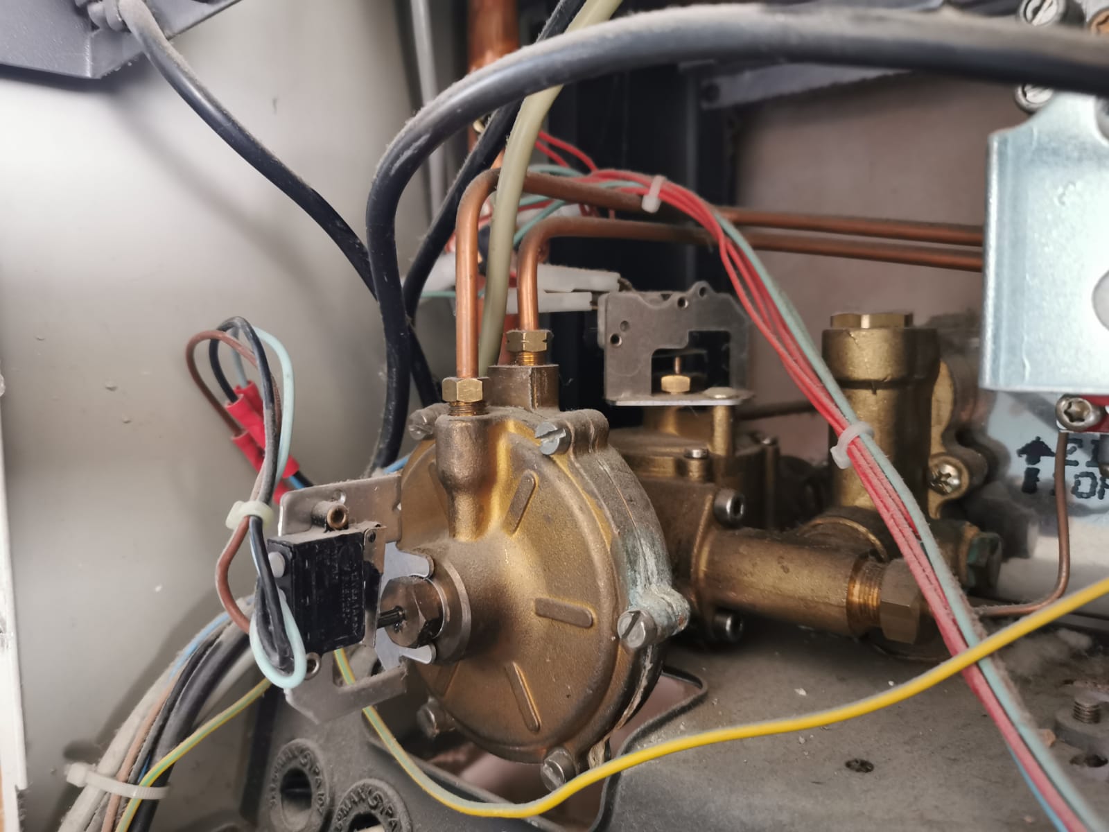

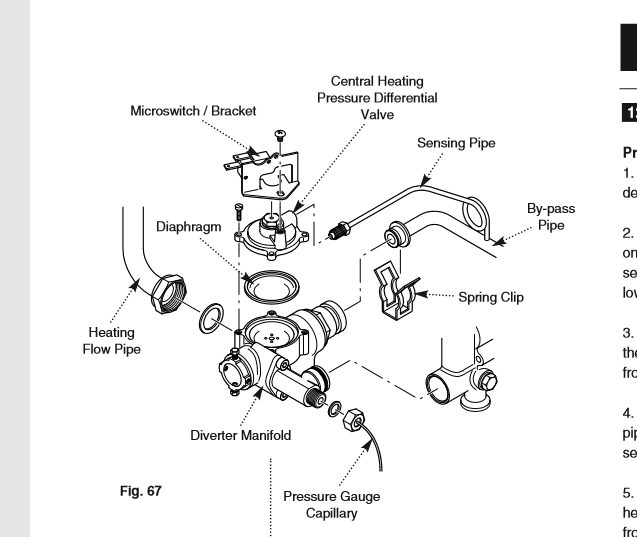

Pump proving switch diaphragm probably worn, there is another pin that sits on top of the diverter valve that also comes out and makes a microswitch, have the pump running and see if it moves.
Thanks for the schematic. Both pins are moving fine.
try linking out the microswitch.

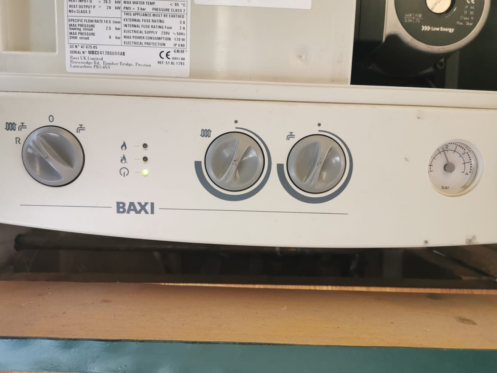

the lights on the boiler that show the temp are also fault lights what lights are showing when it does not fire up ? Pics are good , post a pic of the control panel when it wont fire
OK edit your post, That is not a Baxi 80E you have a baxi 80 Eco, they are not the same boiler, totally agree that manus call all these boilers by confusing names, the Baxi E has a fault code of leds on the control panel yours doesnt , did your boiler pressure drop recently ?
