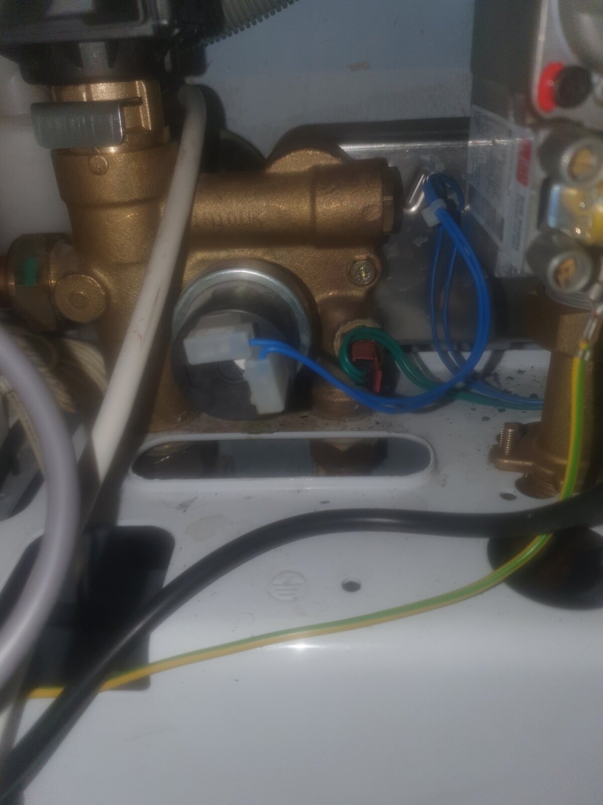

the main ch sensor on these also acts as a frost stat and one of faults when they go is it thinks its cold and brings boiler on
part number 5114725 sits in a dry pocket in pipe on left of divertor valve

sounds like when you are isolating it the knob on flow isnt actually turning the valve off

Is it this red one on the right with green wiring?

The clue was on the PIPE to the LEFT of divertor ;)
but it looks like that ;)

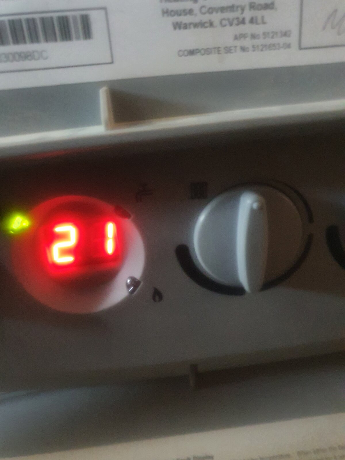

If I open first valve and run hot tap, the pipe goes warm which I believe isn't meant to happen (I do have a loft extension which I've noticed first pipe has a run off then goes up)
And then ch light comes on as per pic
Edit. After several minutes light has gone off but can still hear boiler doing something for few minutes then boiler does go off
You'll probably find you need a shock arrester and one way valve fitting to the cold water inlet pipework to the boiler. What's happening is when you run cold tap pressure in pipework drops. When tap is turned off the pressure returning activates the flow switch momentarily. The boiler will see this as a hot water demand and will go through its start up sequence. Then it will shut down and go through shut down sequence.
