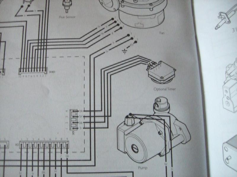

I am currently trying to install a digital timer in my boiler, this I thought would be straight forward but confused alittle and don`t want to damage the boiler.
This is the wiring diagram that came with the boiler which has 4 wire connections

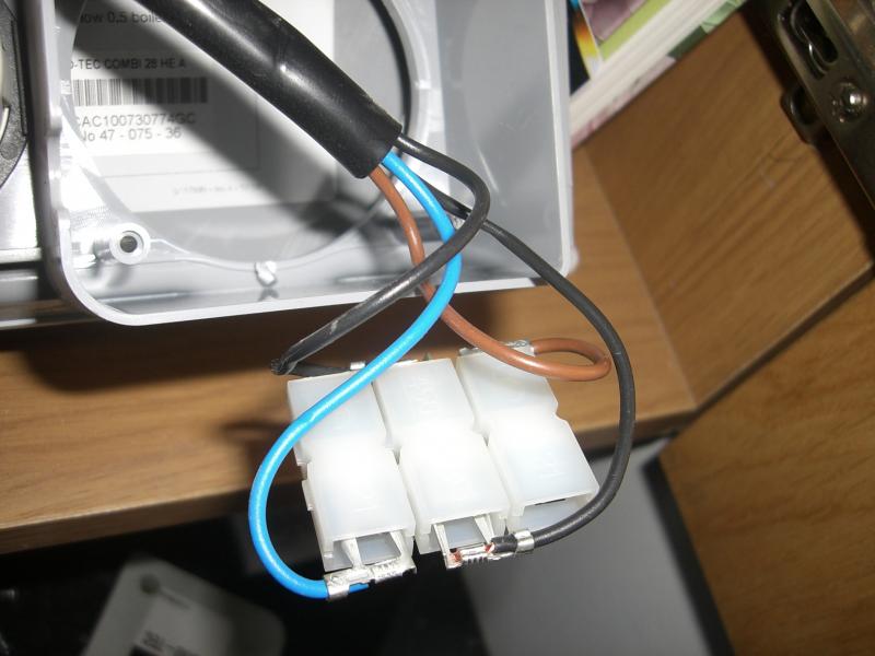

here is a pic of the timer with 5 wire terminals
and finally the terminal block that the wires go into
in pic 1 the wiring diagram shows 4 wire connection but in pic2 the timer has 5 wire connecctions numbered 1-5 and pic3 shows the terminal block with 3 wire connections!! does anyone know how I should wire this timer up?
all advice appreciated
blue to 2,brown to 1 , 2blacks to 3 and 4, job done, nothing in 5
Thanks for the reply shawd
The two blacks are in the both ends of the terminal plug, should I connect both blacks to 3 and 4 so in effect connecting together at the timer?
ok I`ll sort that out tomorrow and let you know how it goes
thanks for your help
I would be a good step forward if you could tell us what boiler you have, for instance are the switch connections meant to be volt free?.

The Duo Tech uses volt free switching so connect as shawd suggests
spraggo
Thanks for the help and advice spraggo
