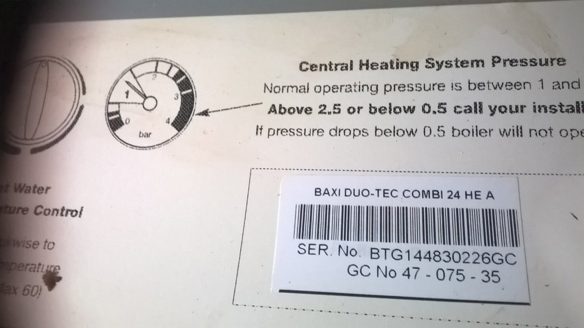

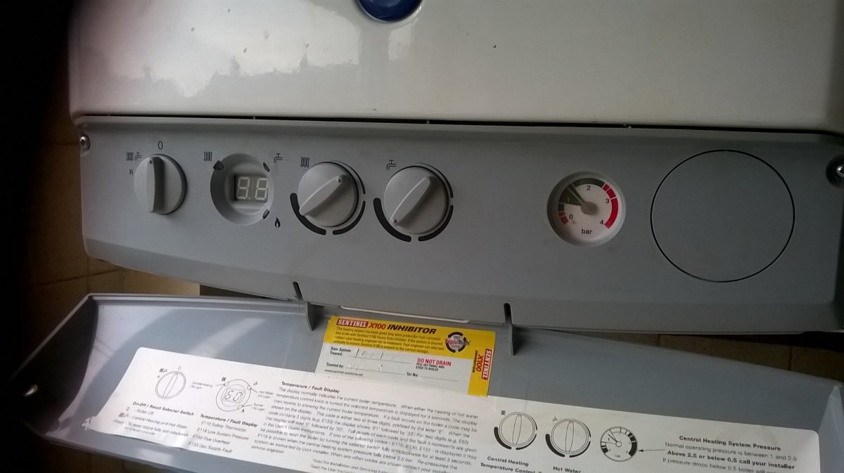

my brother just bought that has BAXI DUO-TEC COMBI 24 A. However, we cannot allocate heating program/timer either on the boiler or anywhere in the house. But there is a room thermostat (an old Drayton) one in the sitting room. When the boiler switched on the CH starts immediately. Can some help please, see attached pics

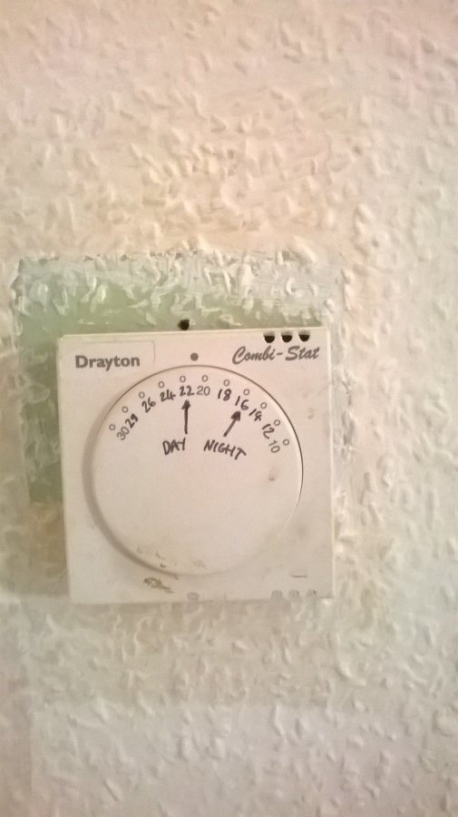

Pic of the thermostat? It's probably a programmable room stat
I do not think it is. is about couple of inches square one with a big dial in the middle. I will upload a pic tomorrow.
It's possible it's been fitted with just I dial thermostat. It shouldn't have been but shouldn't be ruled out.

Pic2 - that large circle on the right hand side will punch out, you can buy a baxi time clock which simply plugs in. Turning the room stat up and down is probably the only method that's ever been used to control the heating .....it's simple and uncomplicated!
Many thanks for the sped reply guys, I managed to get my brother to send me a pic, (see attached). If you think this stat is the only way to control the boiler. How can I disable it and fit a Baxi programmer as servotech suggested. Is this thermostat connected back to the boiler, if so to which terminals?

No need to, it should work in conjunction with the time clock, but the time clock once fitted will have priority over the room stat.

thanks but how?, is it as simple as disconnected the one on the wall now and fit the one you the digistat
Yes there will be 2 wires.
Turn power off remove old fit new connect 2 wires.
You will then be able to program different temperatures and times for up to 6 slots a day each day different if required.
If you keep that stat and go for the Baxi plug in clock. You will have on/off times and a dial stat. Which is less efficient way to run a system than programmable high/low temp
The batteries power the screen etc but it has mains voltage supply for switching.

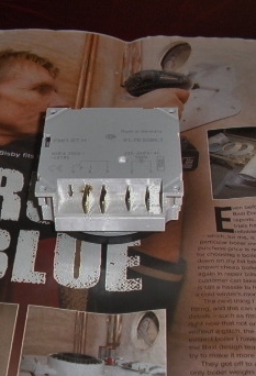

Yes, you will get an instruction leaflet in the package (just connect the terminals). I've a picture of a mechanical one somewhere.
I know us older ones (who can't see the modern tiny digitals very well) just like things to be really simple.
Mechanical plug in timer picture.
Once fitted you can adjust the clock to over ride and give priority back to the room stat should you require it.
