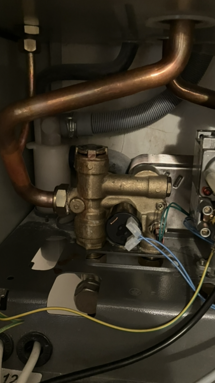

Hi
Diverter valve leaking through the motorised valve inside the boiler.
Does anyone know the best place to source the attached valve and motorised head. They valve seems to look different when I check online.
Thanks in advance

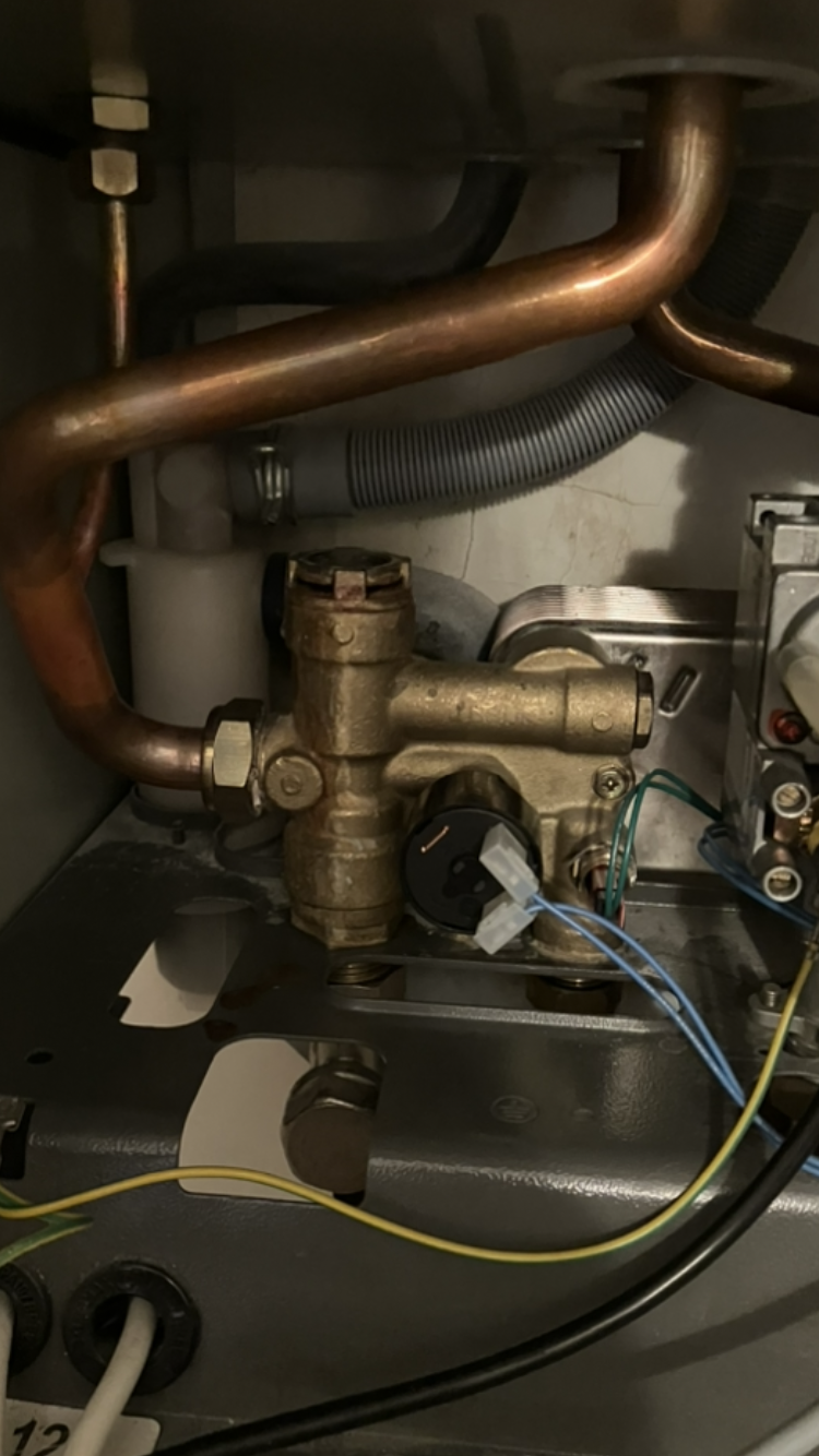

Can I just purchase the part/valve that fits in the top (looks like they come as a repair kit online) or does the whole casing/body the valve sits in need to be replaced?
I would also purchase a new motorised head
Pic attached

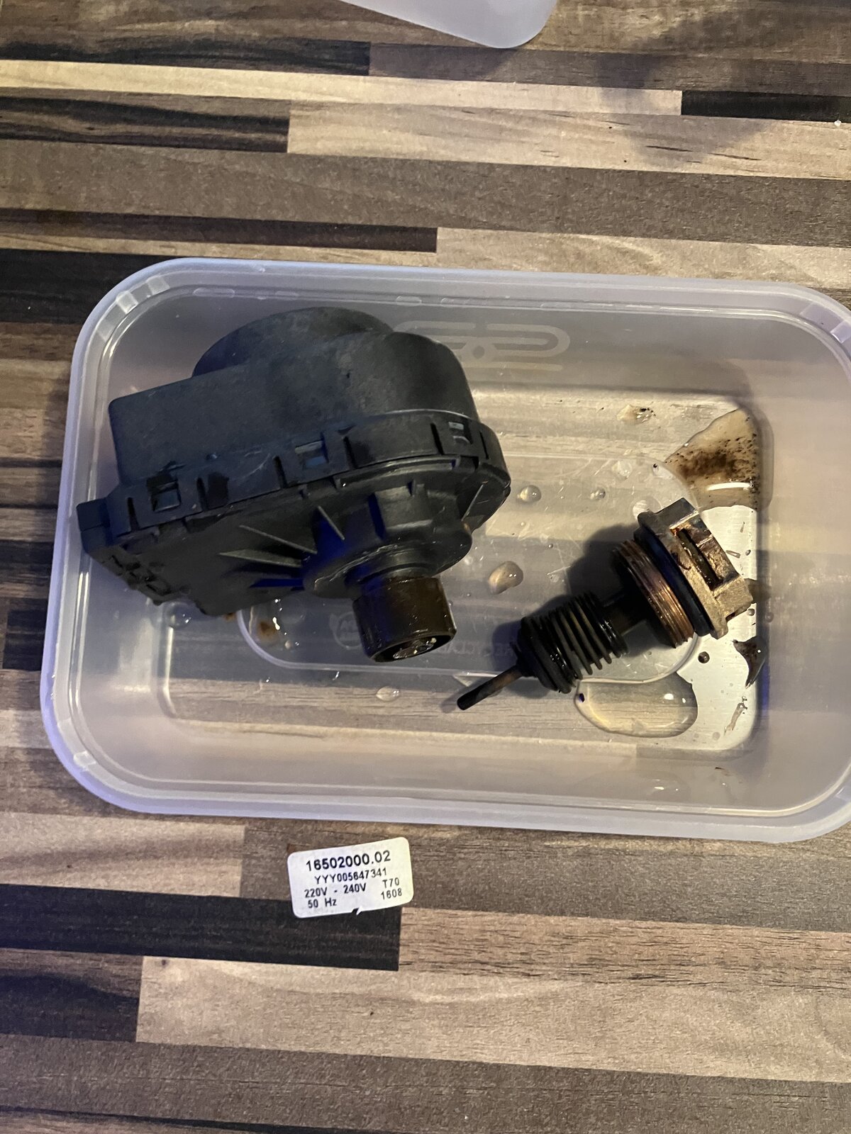

Test the actuator (motor head) by plugging back in and creating a demand, if it’s knackered, get a new one.
  • Thanks
Reactions: RMS

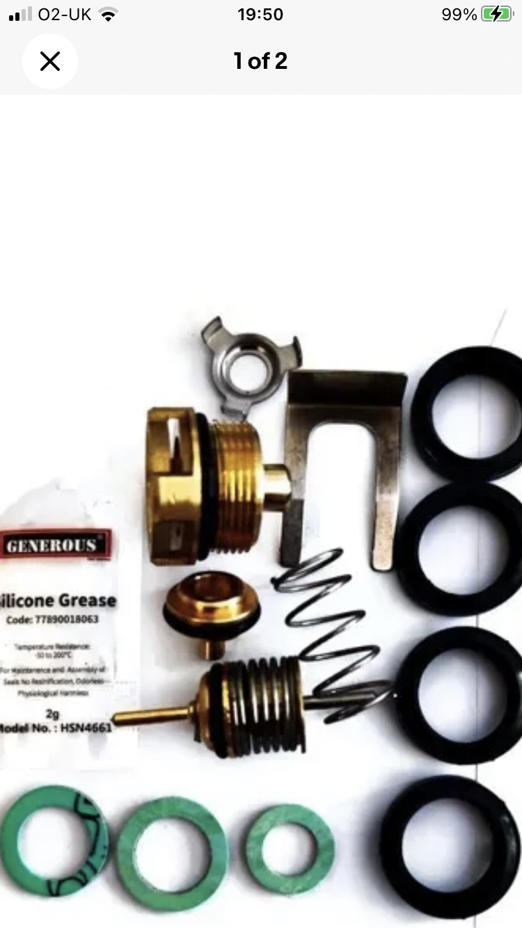

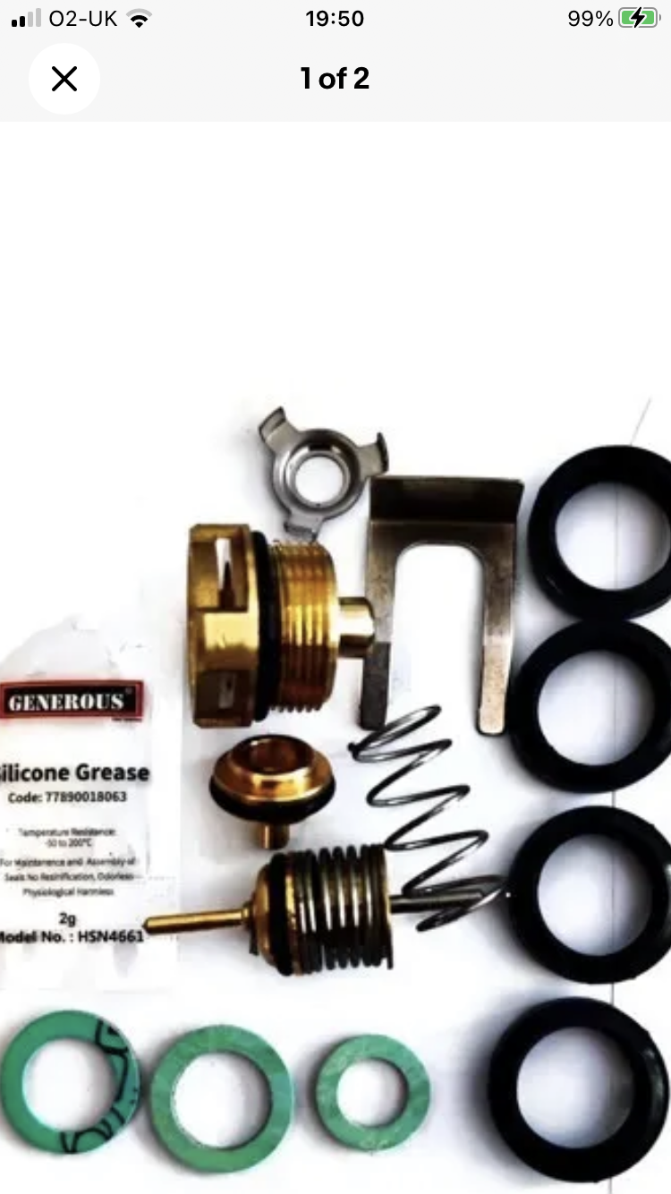

It’s full of water. Even if I dry it out either that or the valve it sits on was leaking. Not sure which. I can get a new actuator but the valve it sits on only seems to be available in a diverter repair kit. See attached.
Is this what I should get also and is it available at a local plumbers merchant?
No idea if available at merchants, but I’d say get the kit and an actuator
