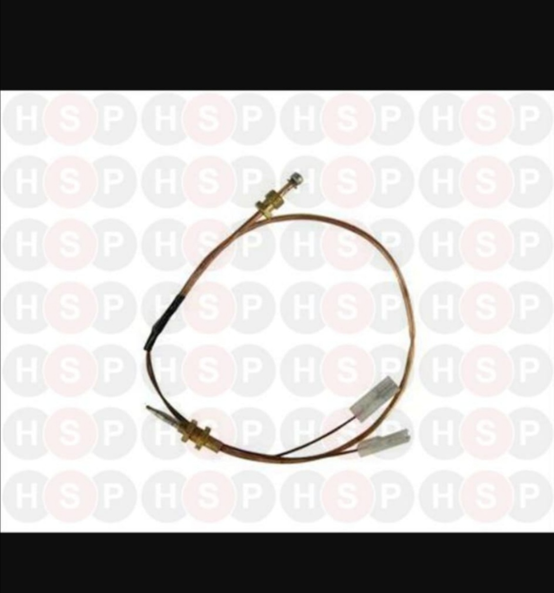

Hello, first time post on here hoping someone can help me. I'm looking to try and find a replacement thermocouple for the above fire. I believe this is a baxi part number 243737. E25-202 I've looked everywhere but all unavailable and the universal ones don't fit.
Thanks Nicola

You can buy thermocouples with a variety of adaptors, so they fit many appliances.
The fire would attempt to ignite then cut out. Sometimes it would light and often it wouldn't. Everyone has said it's the TC but I'm no expert
All of the universal TC don't have the electric part so Im guessing it has to be this one on the picture I posted
the part number i am getting coming up for t/couple for kingston 2 dl is 243644 which is obsolete
Does your t/couple def look like one in photo and have those spade connectors on it
Fitted a new thermocouple yesterday, the fire lit after a few attempts. This morning tried to light it again and it won't light at all
