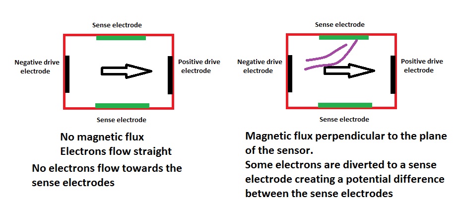

Today, I found a video on how to test the hall effect sensor with a magnet. The only magnet I could find is from a screwdriver and it didn't light up (maybe magnet too weak). I'll get a stronger magnet from my toolbox at work and hopefully will confirm fault.
For the meantime, can someone provide me the voltages for the NTC sensor and the hall effect sensor? Is there a proper wiring diagram I can get (not the one form the cover)? I will try to troubleshoot some more tomorrow.
