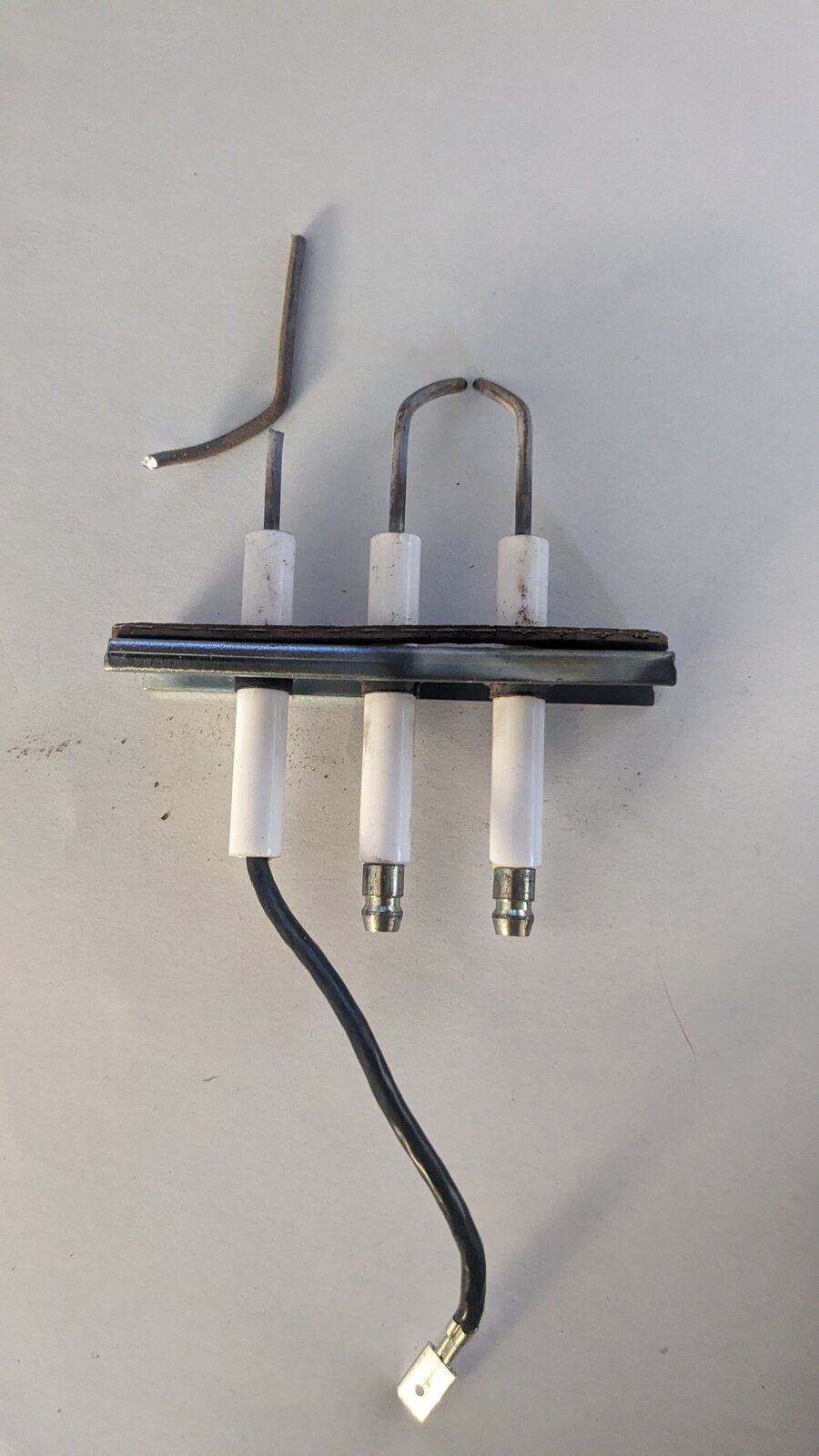

My Main Eco Elite 30 has recently started throwing a E133 error.
If I reset the boiler it tends to start up again OK. I've noticed that sometimes it makes an explosion sound when igniting.
The E133 is intermittent but tends to happen at least once a day. Any ideas on what the problem and solution might be?

The RGI was able to come almost straight away.. he did what I think you would describe as a 'full service'. When he removed the main burner thing there was a white serviceable part which crumbled to bits, so that needed replacing.. plus a gasket .. plus the electrode (picture below)
He thought this is the reason for the E133, one of the electrodes was especially warped (broken below). It broke when he tried removing it.
So I think 3 main servicable parts were replaced... totaling about £175 just for the parts. Total including labour £300. I'm in Yorkshire
It definitely solved the explosive ignition sound... remains to be seen if the E133 stops but RGI was confident

Yep that was the fault the replacement ones are a lot more robust and last a lot longer
