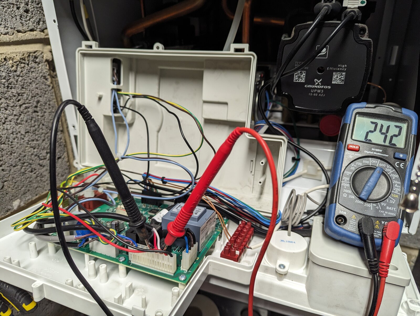

The noise is definitely coming from the diverter. I tested the supply and it's correct (pins 5 & 7 are 240V) when there's no CH demand. But the diverter motor is constantly running, making clicking noises and whirring noises, occasional squeaks.
I don't know if a diverter motor should keep running, 24/7, or whether it should recognise the valve position and stop turning when it reaches the desired position. This diverter motor seems to be running forever.

Interestingly, if I turn on the CH demand the voltage supply to the diverter correctly switches to pins 5 & 6, and the diverter motor stops making any noise. I'm guessing it's driven to the other valve position and stopped driving.
When I turn off that CH demand, wait 3 mins for everything to settle, then request DHW, the voltage to the diverter switches back and the diverter motor starts driving the opposite direction (correct), but keeps driving that way forever. It doesn't stop like it did when it was in the CH position.

The diverter valve does not return by default to any particular position, it is driven to the position by a supply voltage. For domestic hot water, 240 volts are seen on pin 7, and for central heating that supply is moved to pin 6. This suggests to me the diverter valve needs driving in both directions, and there is no default per se.
The thing that I am seeing, or hearing, is when in central heating mode the diverter valve moves correctly to the central heating position and stops making noise. But when in hot water mode, the diverter valve moves to the other position and the drive keeps going, which is where the noise appears to be coming from. I wouldn't expect a diverter valve to keep driving forever, this would suggest it would run endlessly throughout summer when the central heating is off and only hot water is required. I only thought it would drive whilst in motion, and cease when the valve position is reached. I do not know how the diverter controller detects that the valve has reached the correct position to stop driving. Is it possible to detach the controller motor from the top of the diverter valve without having to drain the boiler?
