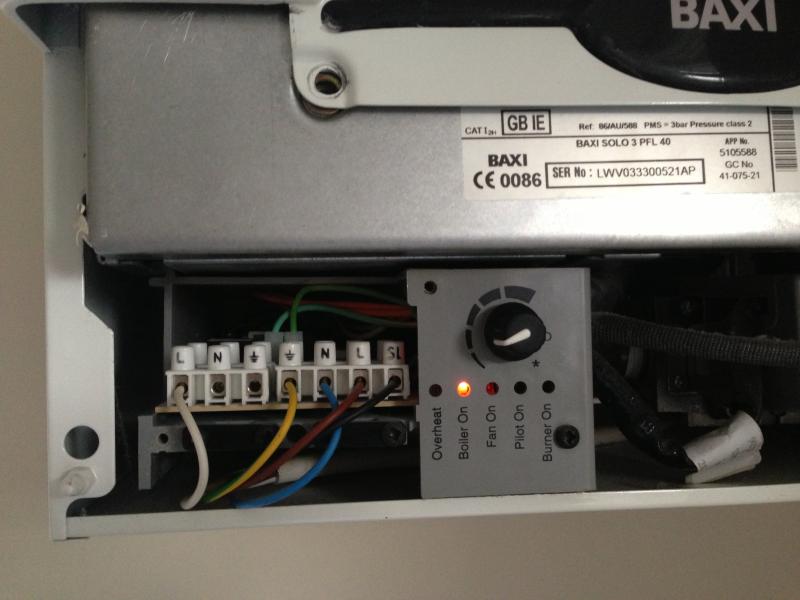

Hi all,
my baxi boiler has suddenly stopped working correctly.
It was working yesterday fine and has even had a recent service a few months ago.
When it was meant to fire up today to warm the water in the cylinder it just makes a clicking sound every 3 seconds and the pilot light does not come on.
Heres a picture of how its looking now.
The pump is on and working its just that the boiler will not kick in.
HAs anybody the slightest idea what might be wrong with it before I call someone in ?
All help greatly received.
Lee [/img]
The gas hob is working fine so that rules out no gas supply.
So still unsure.
Can you hear the fan, or feel it at the flue outlet?
I can't hear the fan and can't feel anything at the flue
The clicking is really loud and comes from around the circuit board area.
I turned the boiler off and back on then turn the thermostat up full with no joy.
I have the odd little flash in the fan on led but it mainly stays off.
Yes I will be ringing around tomorrow.
Just wanted to rule out something obvious.
This fault has nothing to do with gas supply, more than likely pcb, would need further testing from rgi.
